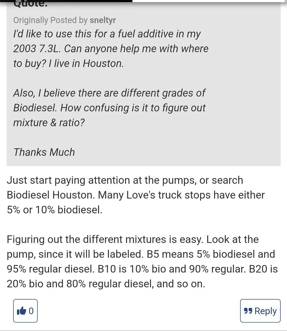

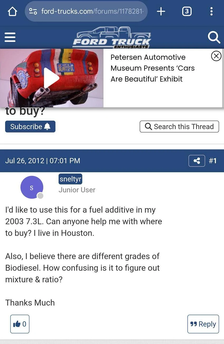

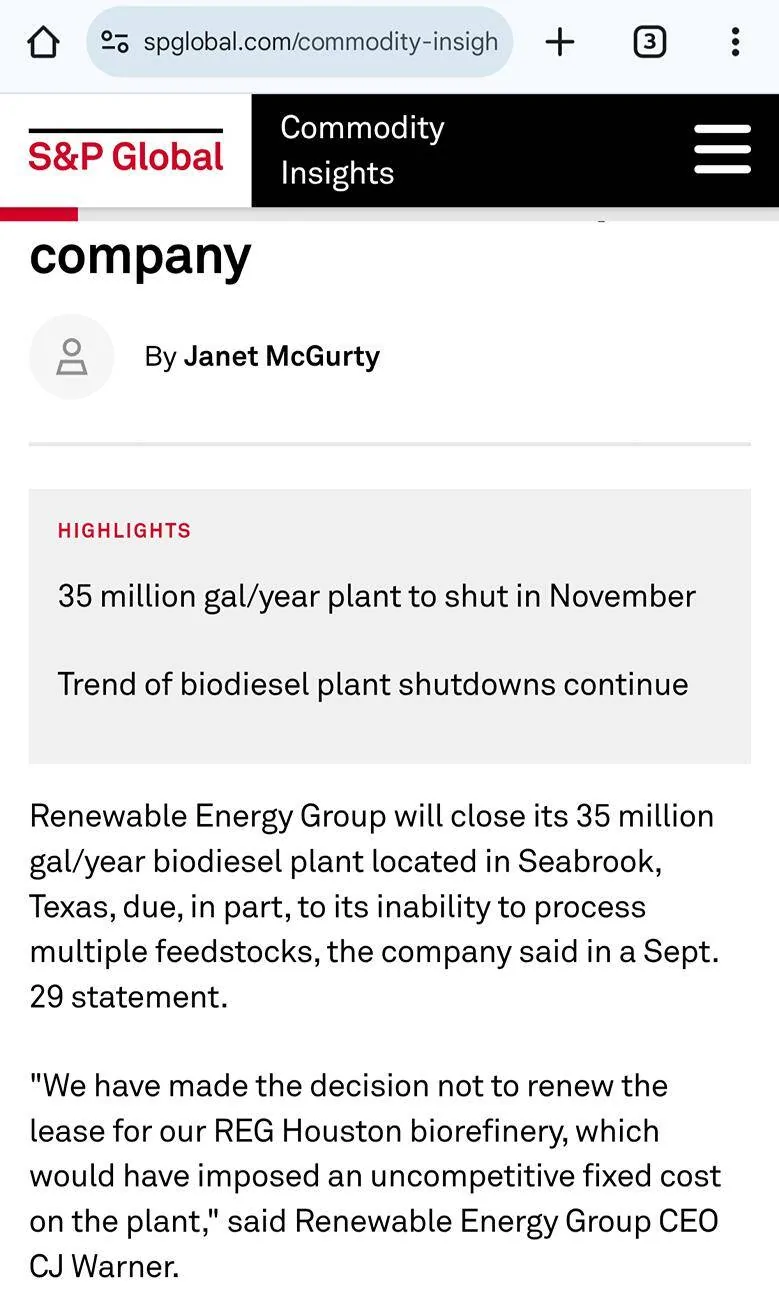

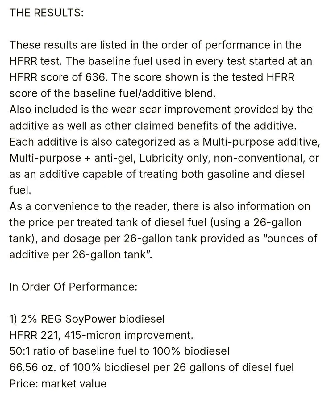

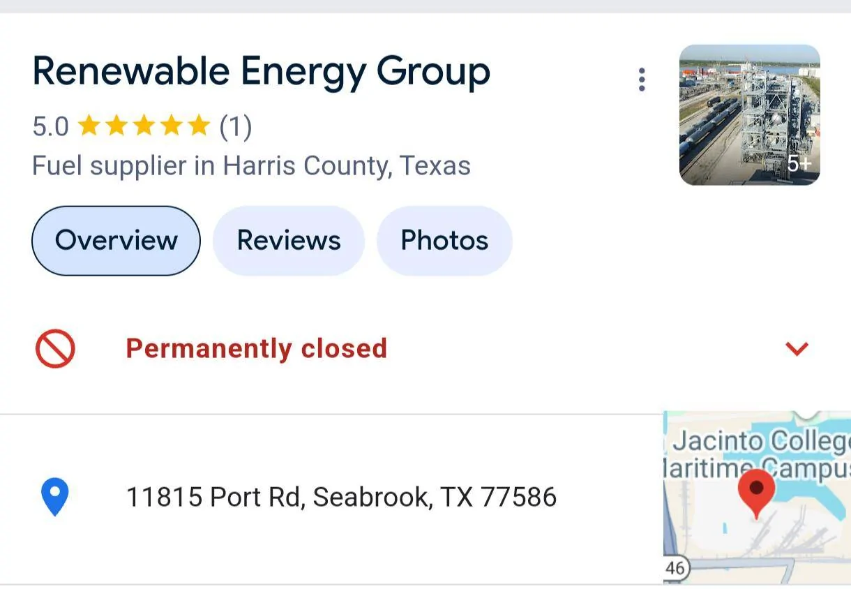

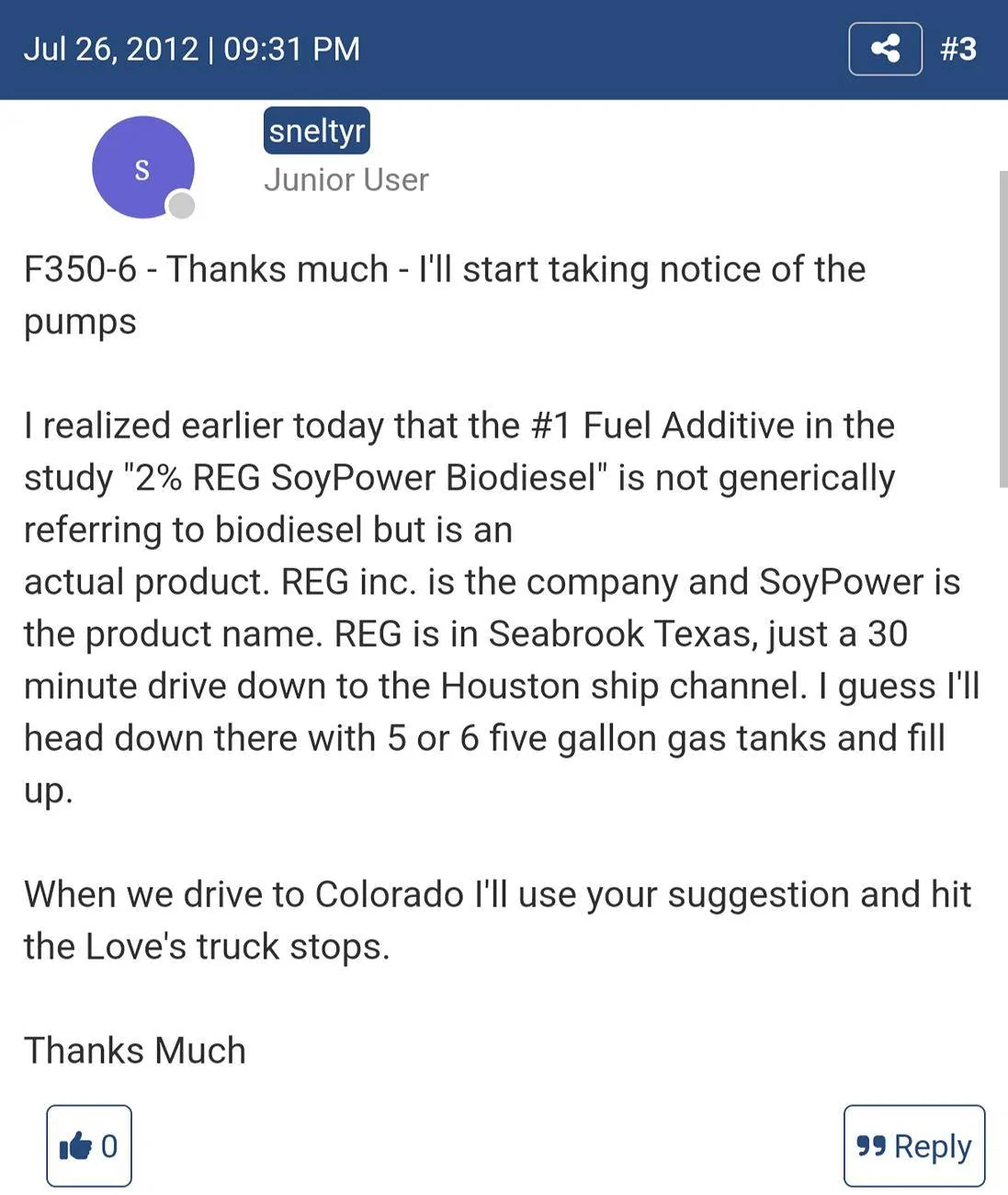

This actually brings up more questions than I had before.
So basically the study was done back in 2003 when biodiesel fuel was really hard to come by. And the number one winner for HFRR improvement is to add a 50:1 ratio of baseline fuel to 100% biodiesel.
I just did the math and it was pretty redundant because it tells you right there in that study, 2% REG SoyPower bio-diesel, where 2% is the amount of biodiesel put into each tank of 100% diesel fuel.
So basically what this study found is that your best bet for the best lubricity of your diesel fuel is to simply use a biodiesel fuel mixture. But again that was back in 2003. Nowadays biodiesel fuel is readily available all across the country.
So if this study is correct, we don't need any fuel additives! In fact just buying B5 biodiesel fuel is going to provide plenty of lubricity for all of our vehicles. I actually get all of my fuel at Bucees, who sells 10% biodiesel fuel.
At this point, I might as well keep using Marvel Mystery oil because my lubricity is so insanely good based on the study listed above, that a 42 micron worst score isn't going to matter now. On a more serious note, should we even be using fuel additives at this point?

If you didn't read the study all the way through, the study was done in Texas.
