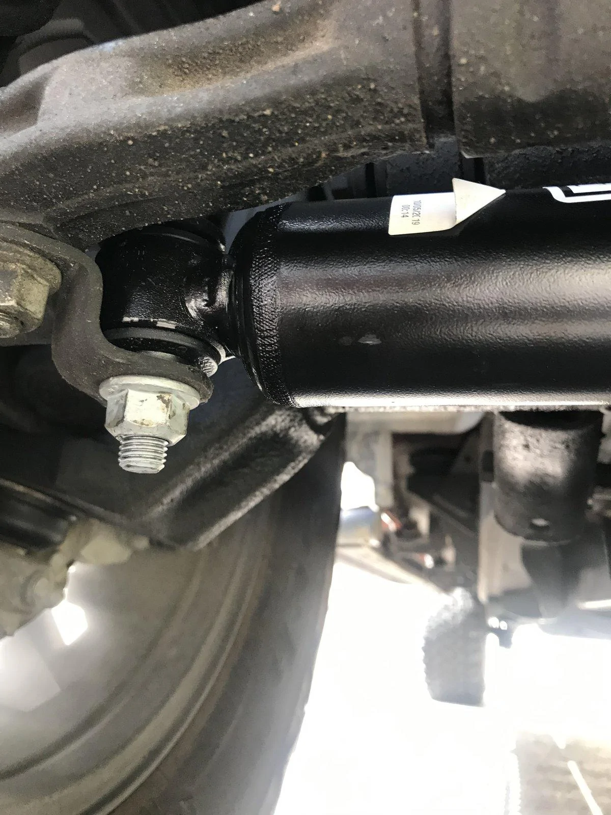

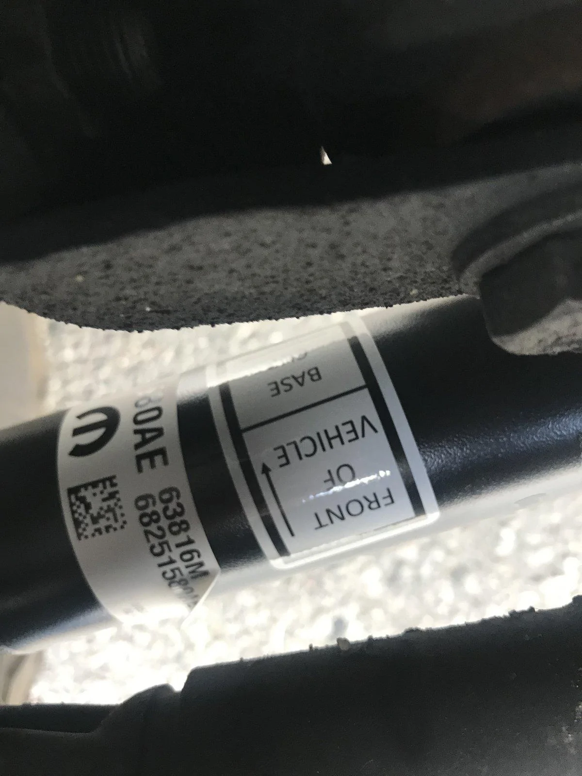

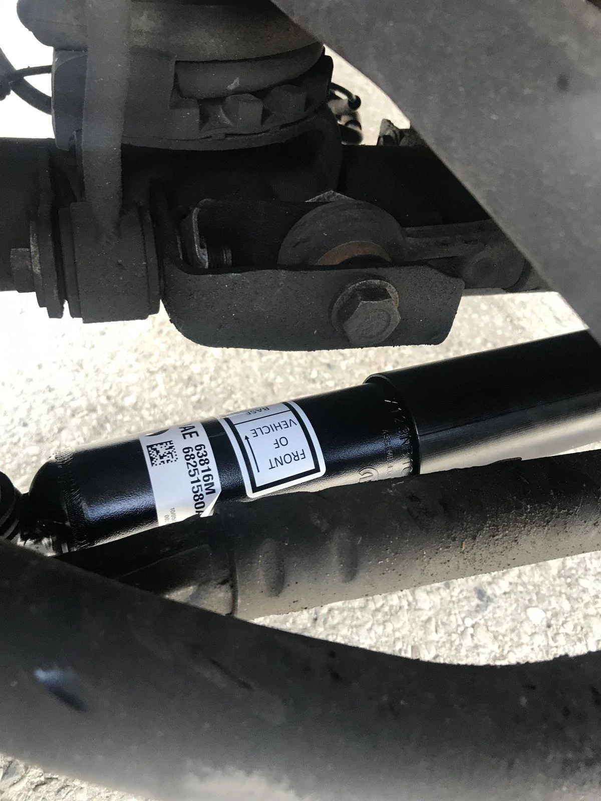

Got my replacement today, had a look at it when I left the dealership, I thought they put it on wrong and went back. There's a sticker that says "front of vehicle" with a arrow pointing to the rear of the vehicle, they said it's on correct just upside down. Is this correct?
It needs to be put on the proper way. It may be upside down but the proper way across the Jeep, but apparently there's some sort of valve that requires the sticker to be facing down, and the arrow point towards the front.
Is there anyway to confirm the valve thing, I think they already think I'm a PIA at my dealership and want to have the correct info before I go back again.

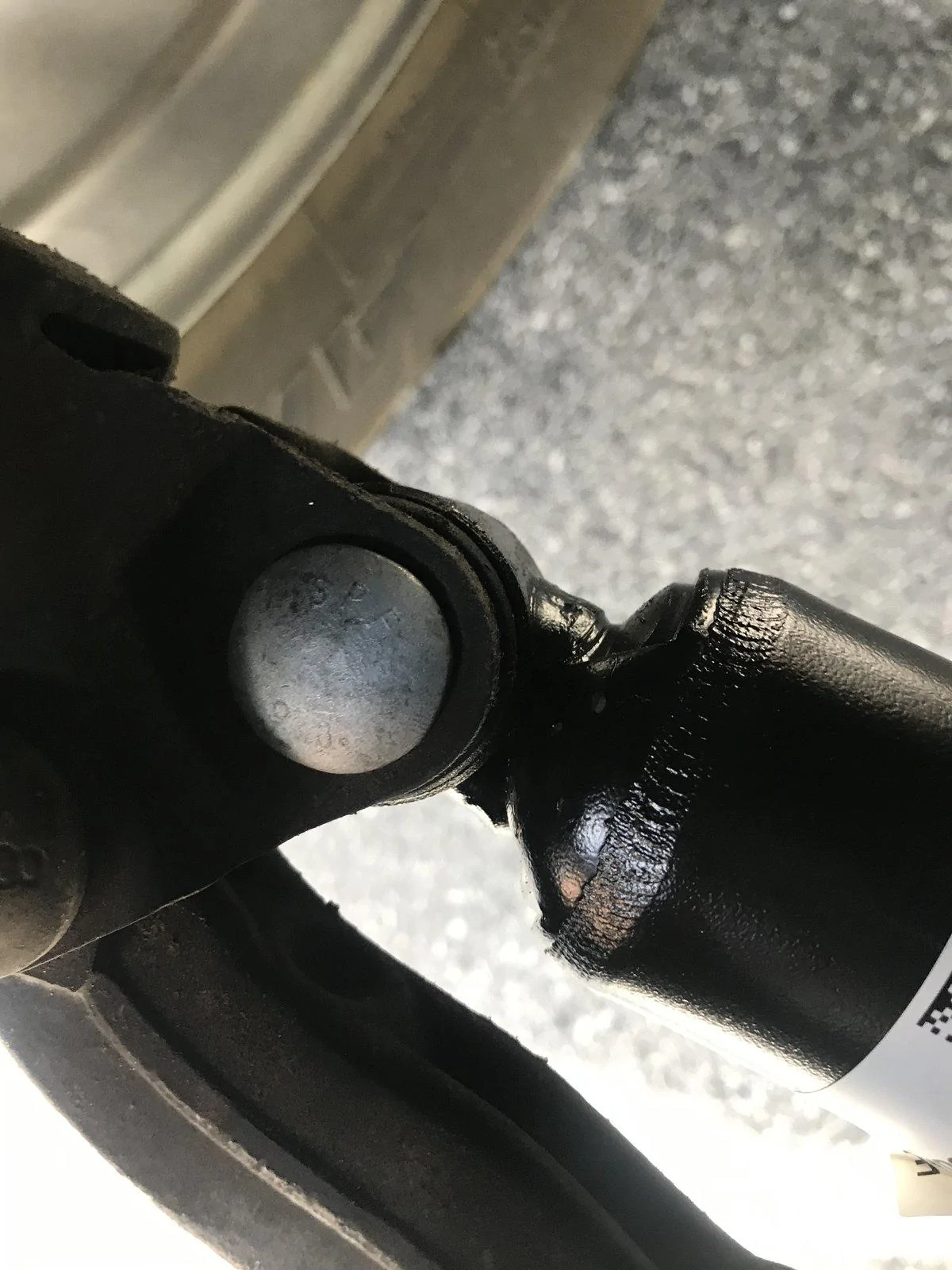

I feel like I remember seeing the dealer documentation that specifically stated how it needed to be mounted on here. Will see if I can find it. If you look at the end of the stabilizer on the end closest to the passenger wheel, there should be a slight bulge in the tube, close to where it mounts to the Jeep. That bulge needs to be facing down. I believe the other part of the sticker outlines this IIRC.

Location of the side intake bulge on the base cup must be positioned in the downward position. this is what is stated on the V41 service procedure. that's where it mounts closest to the wheel. My jeep is on the waiting list, when the job is completed I also will crawl under the vehicle to check their work.

I don't see a bulge or valve on this one.
Just got under it again and my bulge is on top . It's on upside down, will go back to dealership. Thanks for the info!

Just sent this info to dealer, they agreed it's upside down and want me to bring it back.
