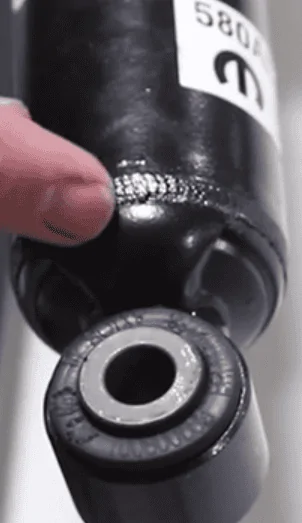

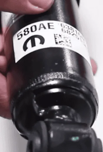

Wow, good thing you posted this. Went outside just now to see that not only was the dampener installed wrong. Even thought their print out says they installed the new CCUKV411AA version, my dampener says 68251580AE version.After having V41 completed, check that the small expanded area on the collar (passenger side of stabilizer) was indeed installed pointing down per FCA spec.
AE is the correct part number. If that's what you have on the Jeep your good to go.Wow, good thing you posted this. I supposedly had the recall done this morning. Went outside just now to see that not only was the dampener installed wrong, it wasn’t even the new part number! Even thought their print out says they installed the new AA version, my dampener is AE version...WTF!
Are you sure? The recall and my receipt from today say part number CCUKV411AA?AE is the correct part number. If that's what you have on the Jeep your good to go.

AE is correct replacement.Are you sure? The recall and my receipt from today say part number CCUKV411AA?
