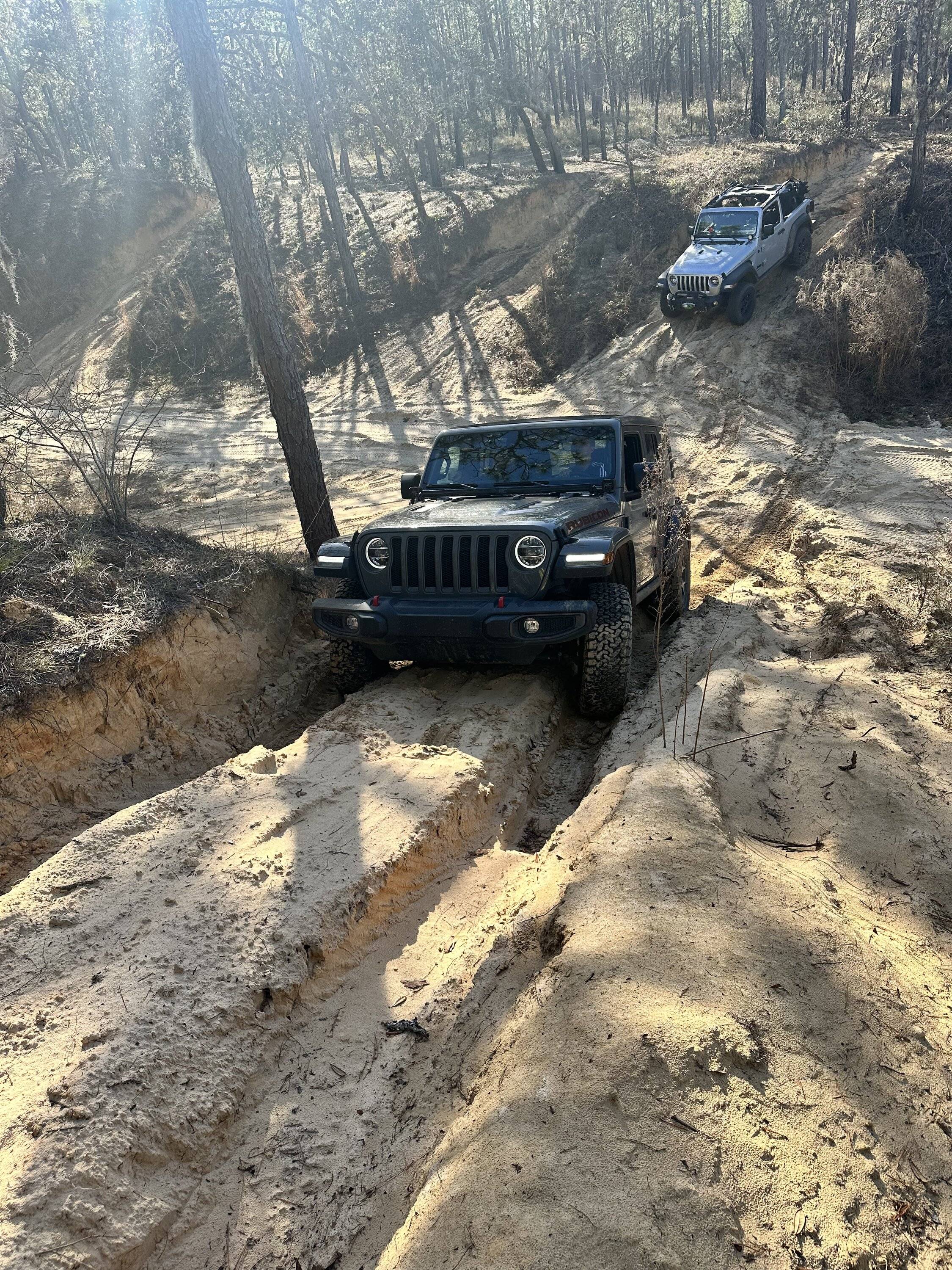

Took my 2022 JL 4-door Rubicon off-roading last week, going up a couple of Sandy hills, after some little time on 4low got a message of clutch overheating and to release the clutch. Attached a picture from the hi
Trying to figure out if it’s car issue and has to do with the recall from 2021 or it is operator error? Does pressing the gas while releasing the clutch on 4low cause the clutch to over heat ?

Operator error. With the Rubicon's 4:1 transfer case in low range you have an incredibly low crawl ratio. You shouldn't be pressing the clutch except briefly to shift gears. If for whatever reason you ride the clutch and overheat it, that message appears.

I've gotten it before on my '21 JLUR, it was during a 15 point turn where we were down a trail that got too deep water/mud wise and had to turn around. I let it cool, and started back up, no issue. The warning is in there after the recall to warn you before doing damage as far as I understand it.

You’re feathering the clutch going up that hill? Like noted above, you shouldn’t have to.
I’m not saying you’re doing this, but some people have a bad habit of keeping their foot on the clutch pedal between shifts.

with the 4:1 t/c ratio, no feathering is needed. I literally idle up boulders and rock shelves in 4low and 1st gear with a hint of gas pw2edal.
based on pic, a similar hill grade I did taken in 3rd gear 4- low not feathering the clutch
