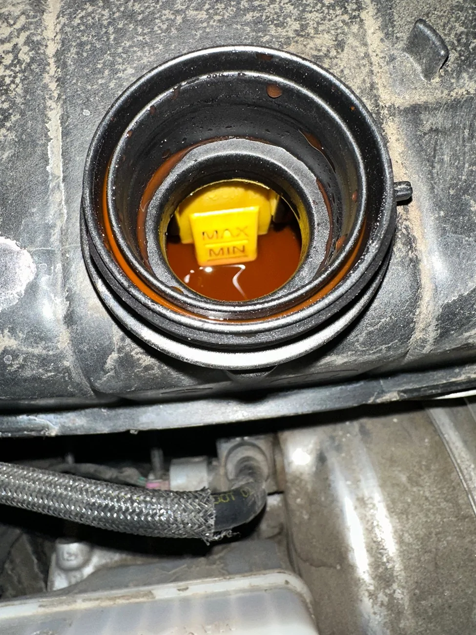

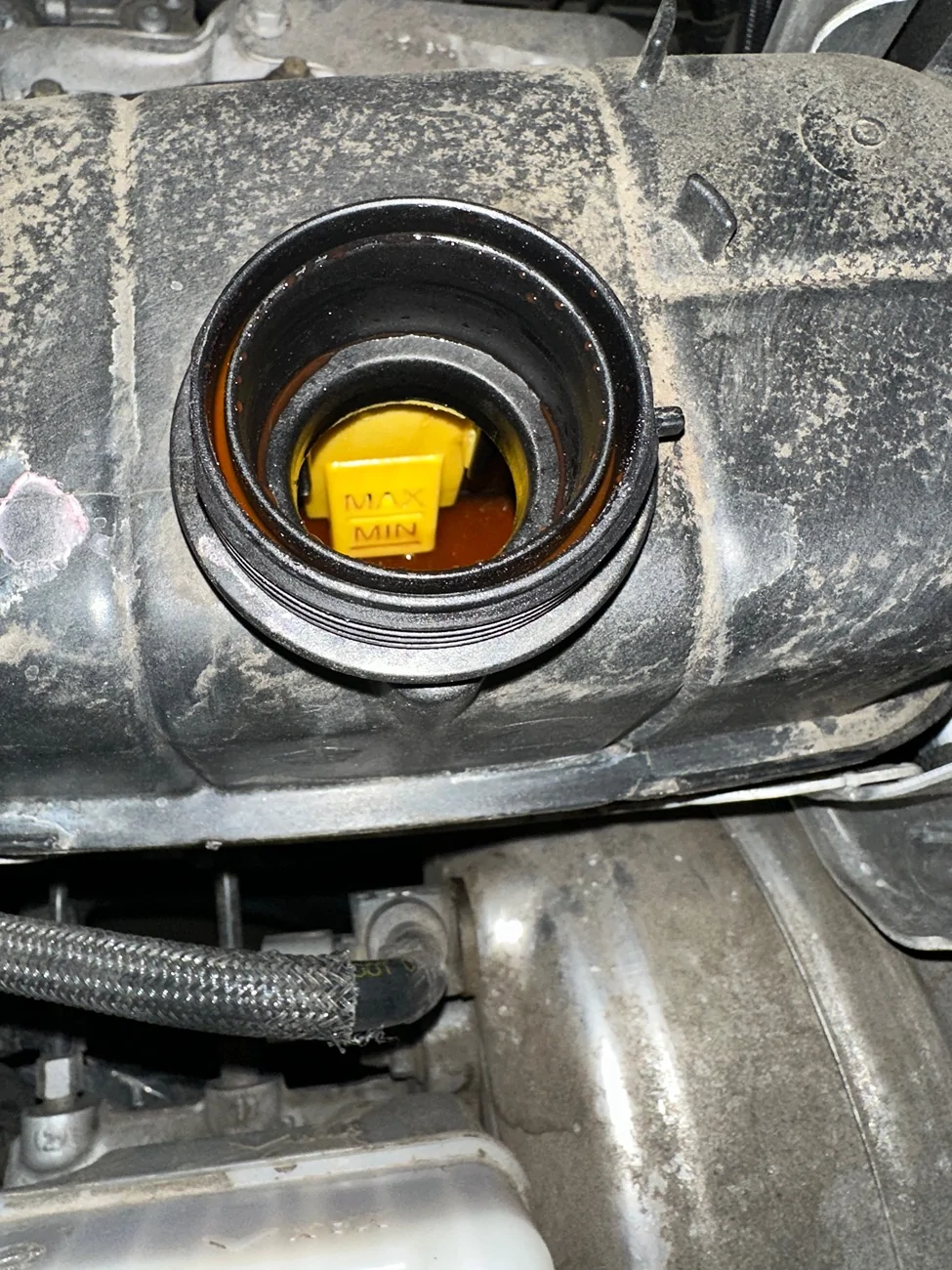

Ok measured this morning. I was a bit down for first time. I didn’t measure yesterday cause I was late. Tuesday morning I was good so I lost a bit Wednesday or Tuesday during the day driving.
I added 2 oz. Came back up to where it was. Added 2 more to be a bit higher but still in range.
Nothing on floor in garage.
So question. Should I call them to see what they say?
TOP DOWN PICS
Tuesday fine
Today lower
After additional 4 oz measured.

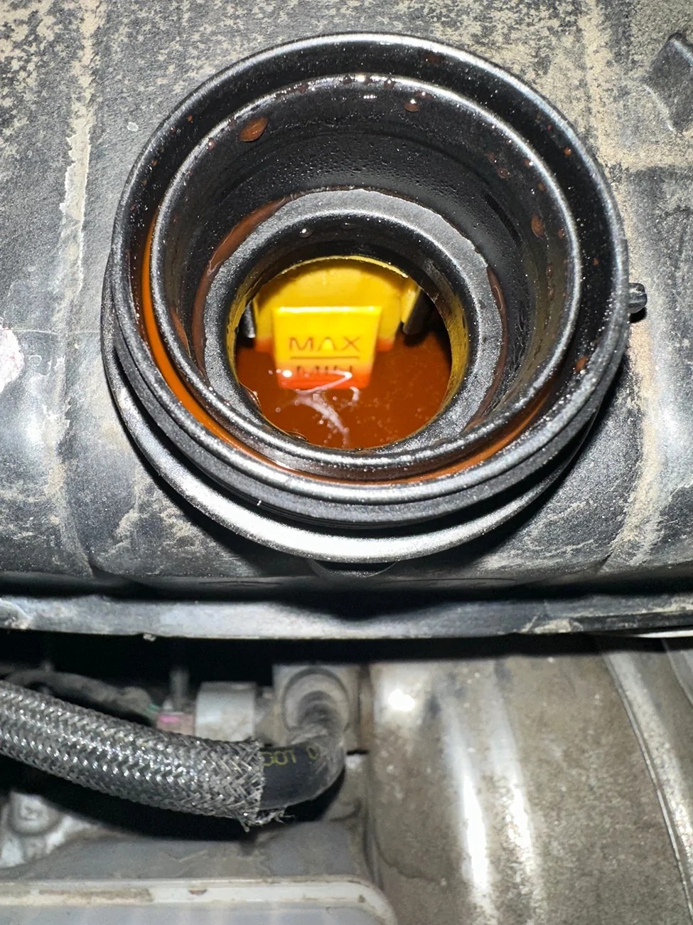

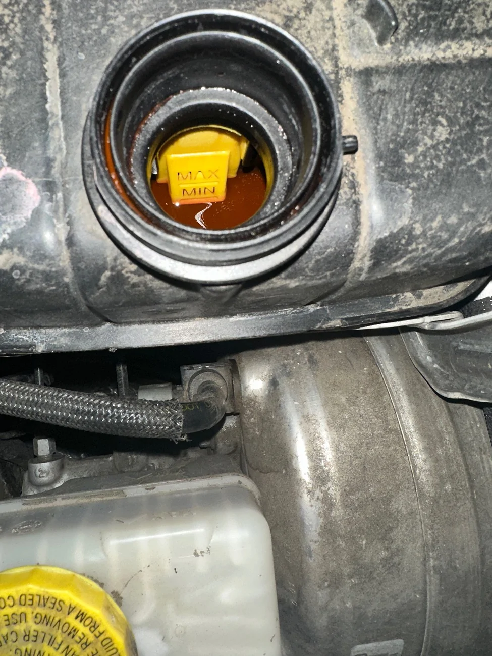

Hey guys. So here is updated pic. There is deff a decrease right? I called the shop and they said it’s still normal and no further testing is required. I don’t get this. It’s going down?
I called another dealership and they said bring it in but I also just don’t want to bring it in and they just do the same 1 leak test without dye.
Is it me?

I’m going to come lock your hood closed for a month.
jimim
Jul 19, 2020
41
786
696
NEPA
2020 Rubicon, 2017 Tahoe LTZ
Ok so I’m fine then.
I know I have issues. I try I really do. Do you think I want to be like this. lol. I hear it from my wife and kids everyday.
Ok I’ll check like once a week from now on. 1 month is a bit extreme for me. lol

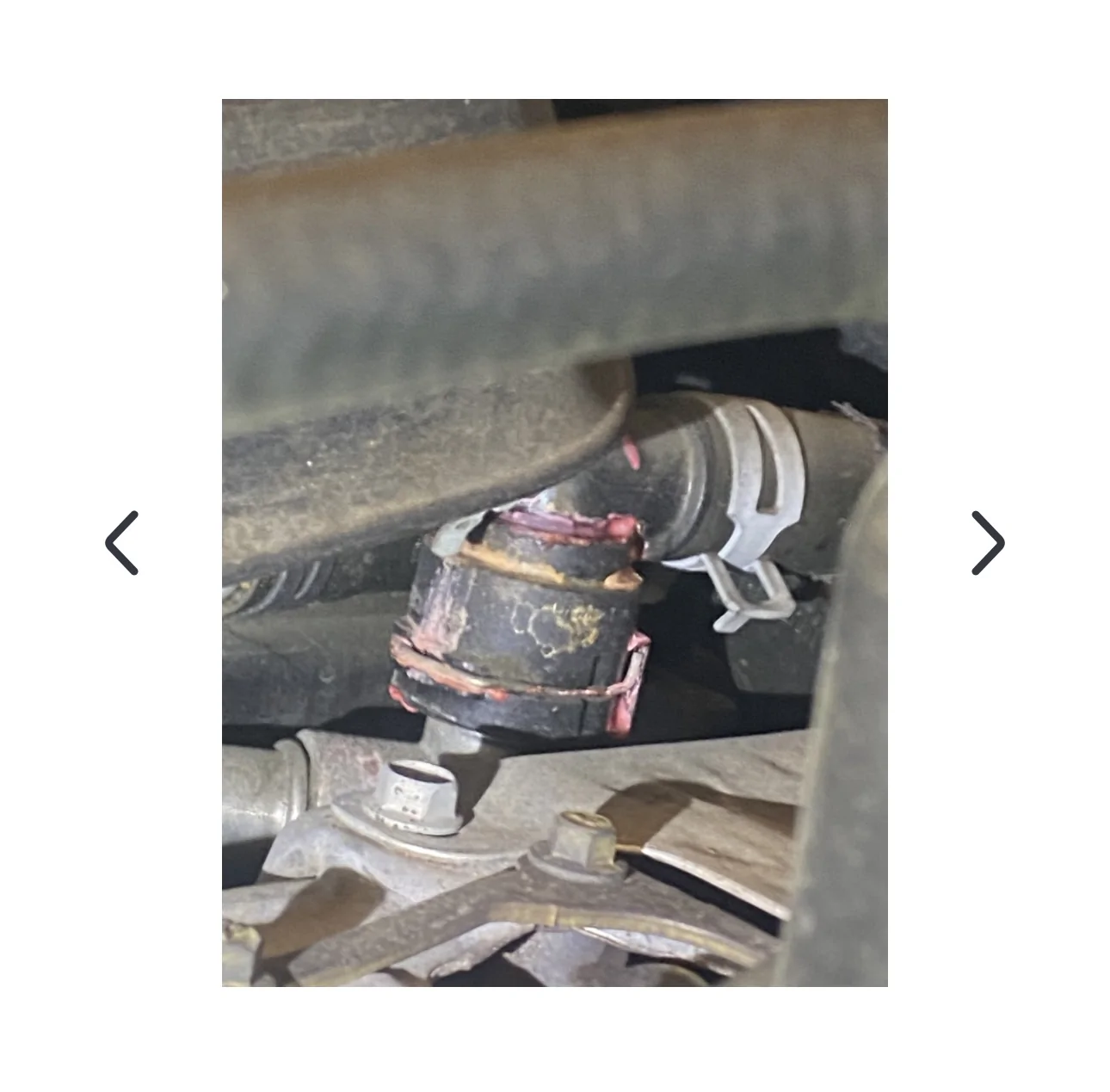

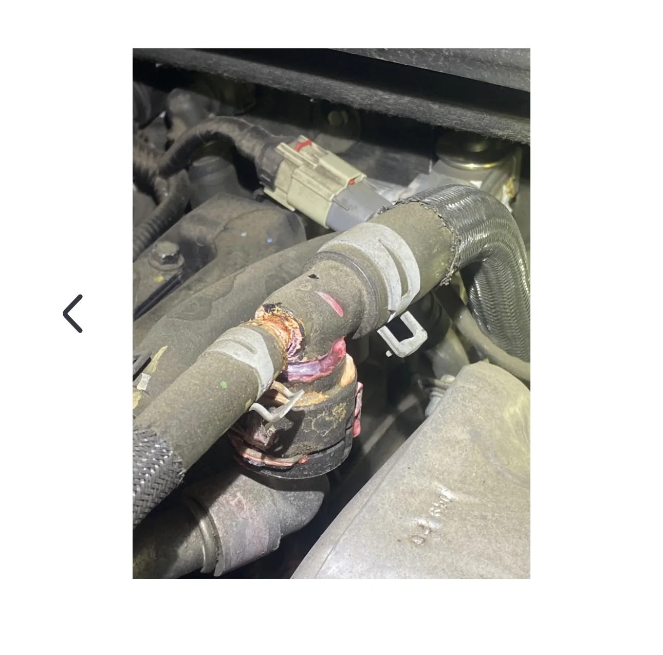

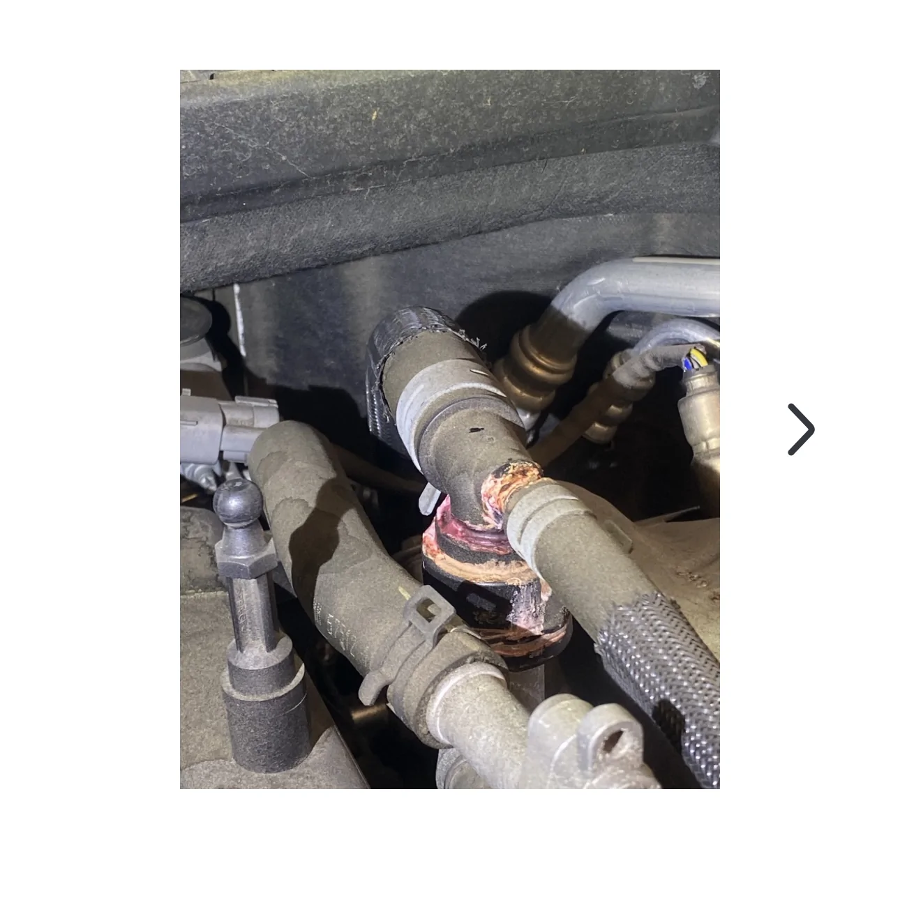

Ok I know I was told to lock the hood and move on but it’s loosing coolant and technically it lost a lot which started all this so I took it to another dealer shop today. They said they were going to actually pull spark plugs. Camera s exactly could along with dye test and leak tests.
They found the leak in 1 hour. It was at the area of the stat I was told. Pics attached. They said I am good now. Turned into for claim. 100 bucks out.
So I said how come other place did leak pressure tests for 2 days and said nothing. Do drive it and see and how come you all found it instantly. He said guy working on your jeep prob had no experience. I said I was told he was there for 25 plus years and have seen it all. Bla bla bla. Who is right who is wrong. I don’t know bot they said it’s fixed. He said this is a very very well known weak point.
Ok I leave it to the pro’s now discuss.
I don’t know anything but all I know is why the hell did shop 1 do 1 test. Stopped fave up pretty much and told me to drive it and see what happens and shop 2 pretty much came in called me right back and mic dropped? Seriously.
Again I came here for help from all you guys cause I’m clueless but in those pics I see pink coolant marks. How can anyone with 2 working eyes who work on jeeps for a living not even see this?
Not judging. Just completely confused.
