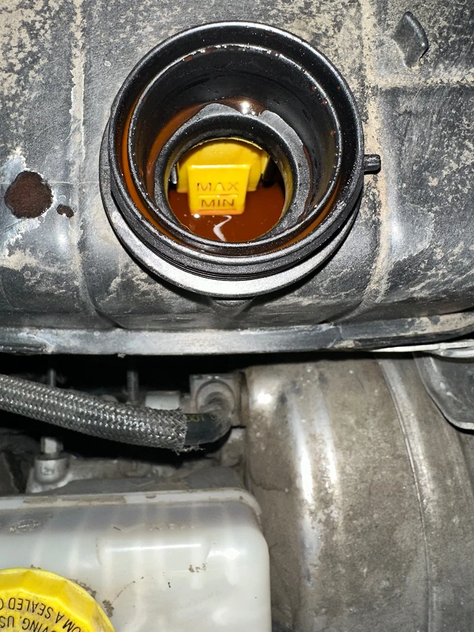

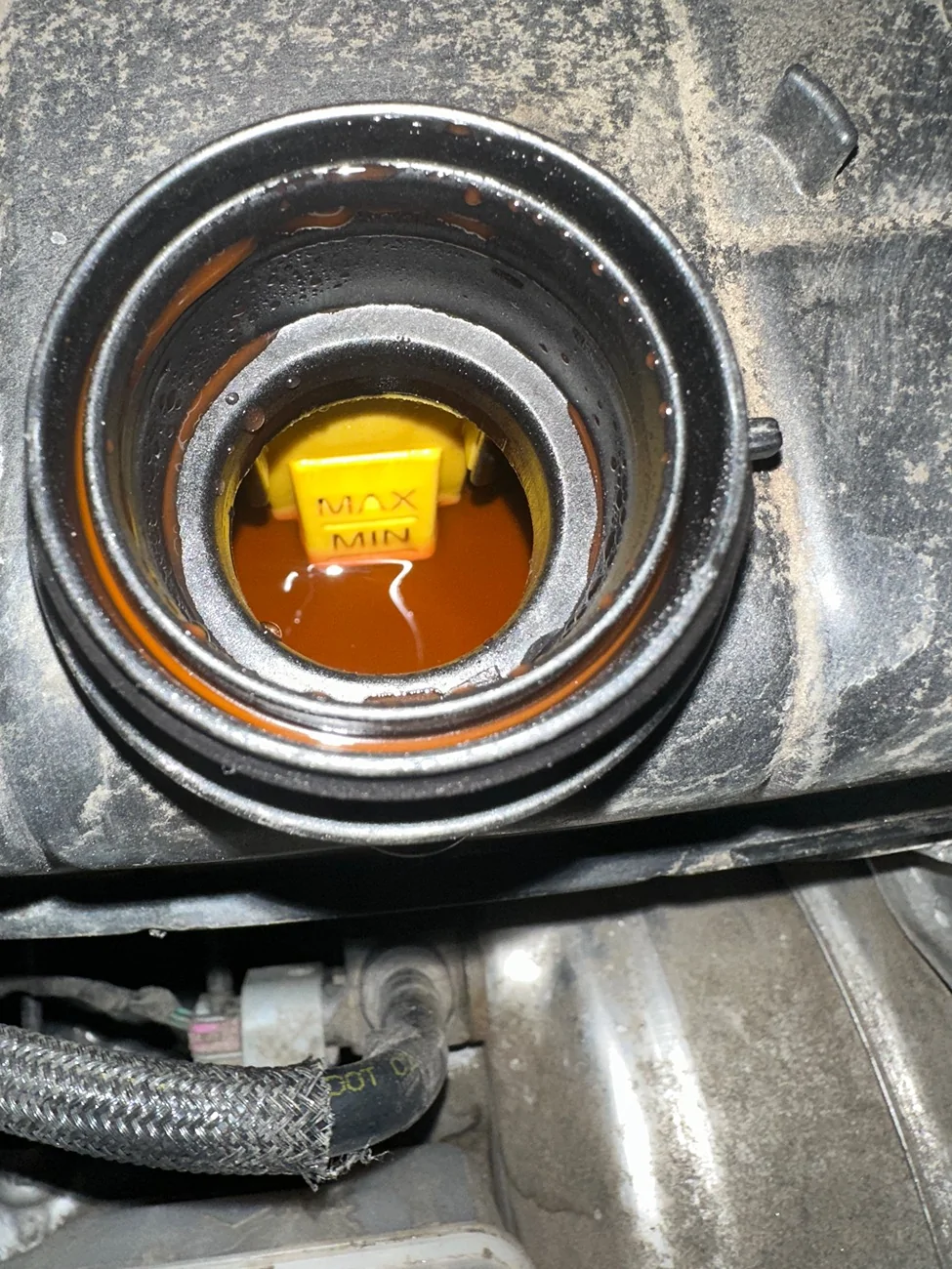

Morning boys yesterday am vs this morning. Bottom is this am. Top yesterday.
Jeep Wrangler JL Coolant temp overheat IMG_5047
Jeep Wrangler JL Coolant temp overheat IMG_5081

Normally leaking headgasket will cause bubbling in the coolant and the car will overheat quickly. I have never heard of a car "eating coolant". They can do a test to look for combustion residue in coolant to confirm its the headgasket or watch for bubbles in the coolant with engine running. I think its more likely there is a leak somewhere and they are not seeing it. Probably a small leak that overtime emptied your overflow reservoir.
Especially since it seems the OP never once checked the level.
People need to check their fluids!!! My brother has blown not one, but two engines due to low oil. Does he check his oil level now? Nope.

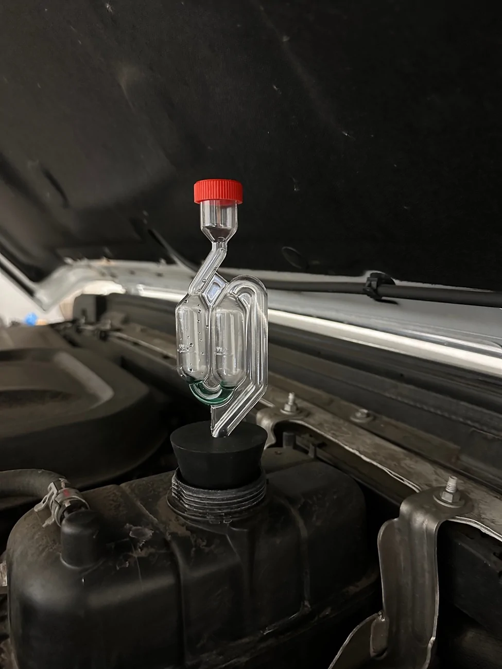

Ok I got the test. Coolant temp is at 212 with engine running and liquid did not change. So am I good or does the thermostat actually have to open to allow coolant to flow through to see if there is a leak in the he head. I hope I’m saying that right.
Jeep Wrangler JL Coolant temp overheat IMG_5083
jimim
Jul 19, 2020
41
786
696
NEPA
2020 Rubicon, 2017 Tahoe LTZ
Pretty sure the thermostat opens at 195 on the 2.0
Ok so should the fan inbetween the radiator and engine kick on? Or if there was a leak I would know by now with it at that temp?

Fan won’t come on until 225, unless you put the ac on max, but I think your fine at the 202 to do the test. The fan on isn’t indicating that the thermostat is open., engine temp is

Ok so I called it at 212 degrees. No color change. So do I assume the stat was open to allow coolant to be flowing to see if the test was valid? Cause if stat doesn’t open then coolant isn’t flowing to know if there is a leak? Am I correct? Just trying to understand when to know if there was a leak that co2 would be in there to turn it.
