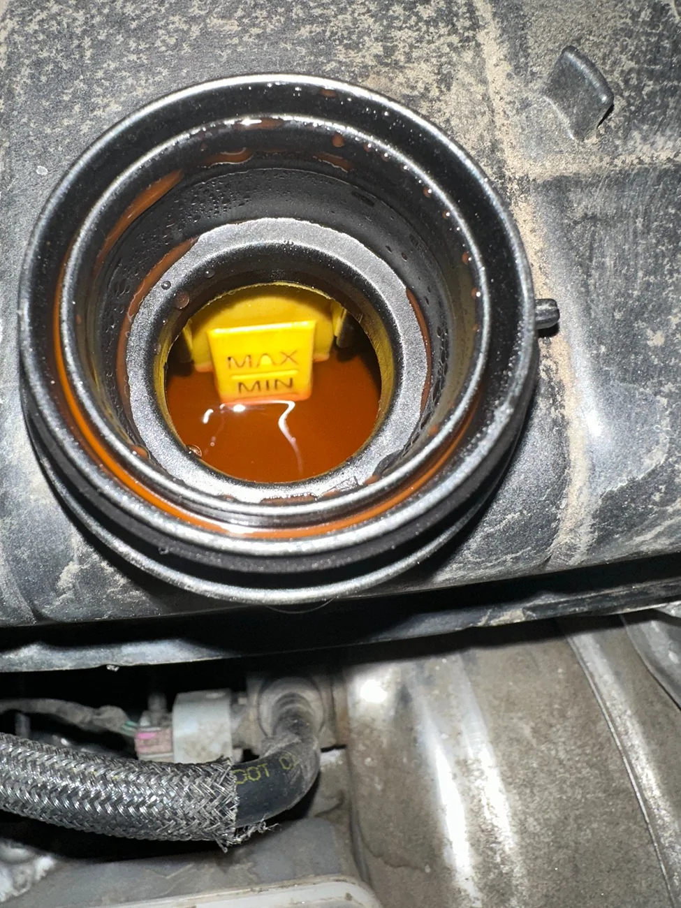

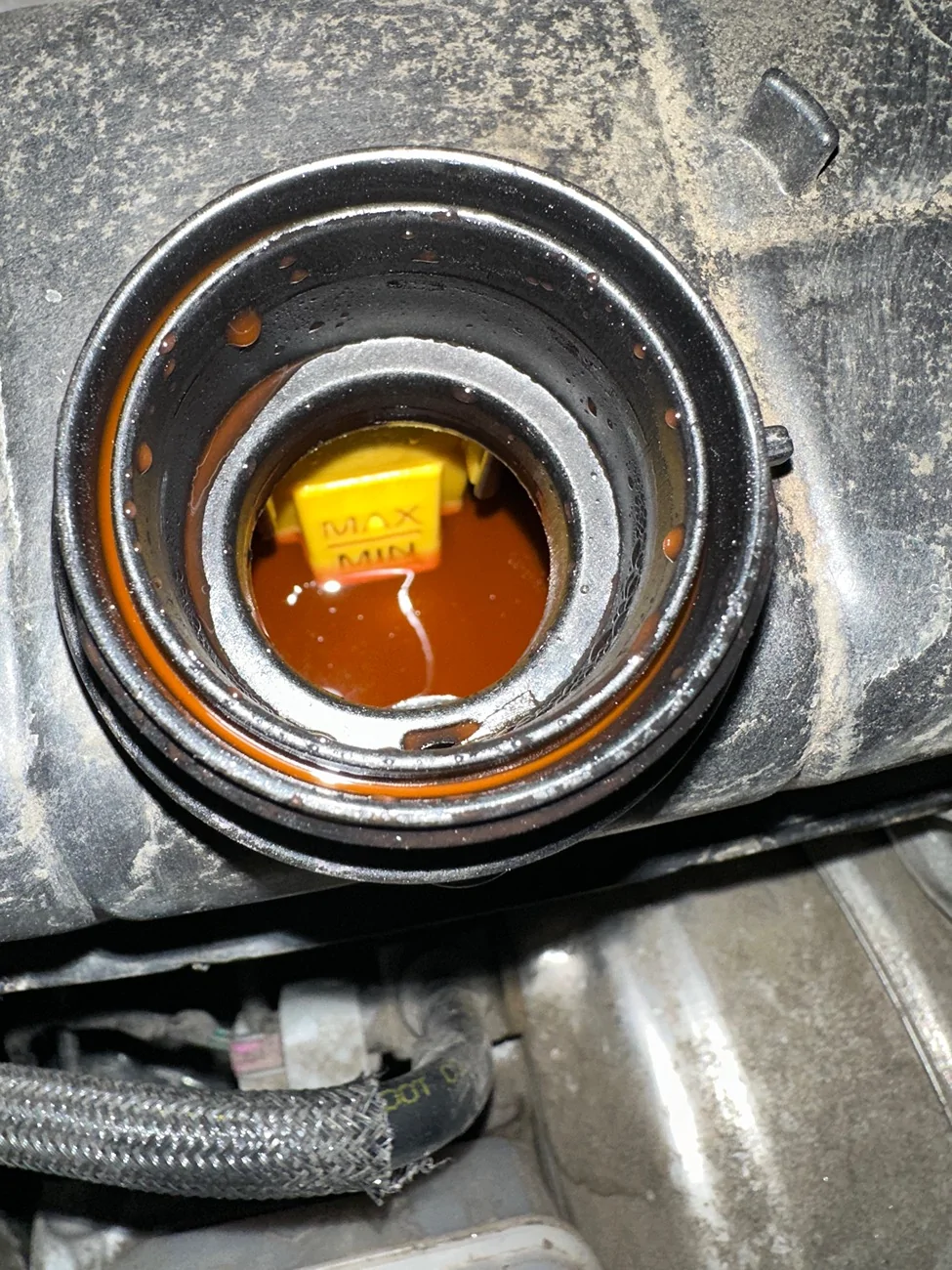

AM yesterday pic and AM today pic. Are we good?
Taken in my garage heated at 55 degrees before leaving for day.
Both are within the lines. Today’s seems the littlest lower bit does that matter?

Jim, not to sound alarming but,
can you compare the colour of your coolant in tank with fresh coolant.
Pull a small amount out with a turkey baster or similar. Your colour looks way too dark to me, the coolant i get is pale and yours looks opaque.

Agree with previous comments on color. I would not add any today. I would take another picture tomorrow, as it does look like there is some coolant loss from your picture. Another day will confirm it.
