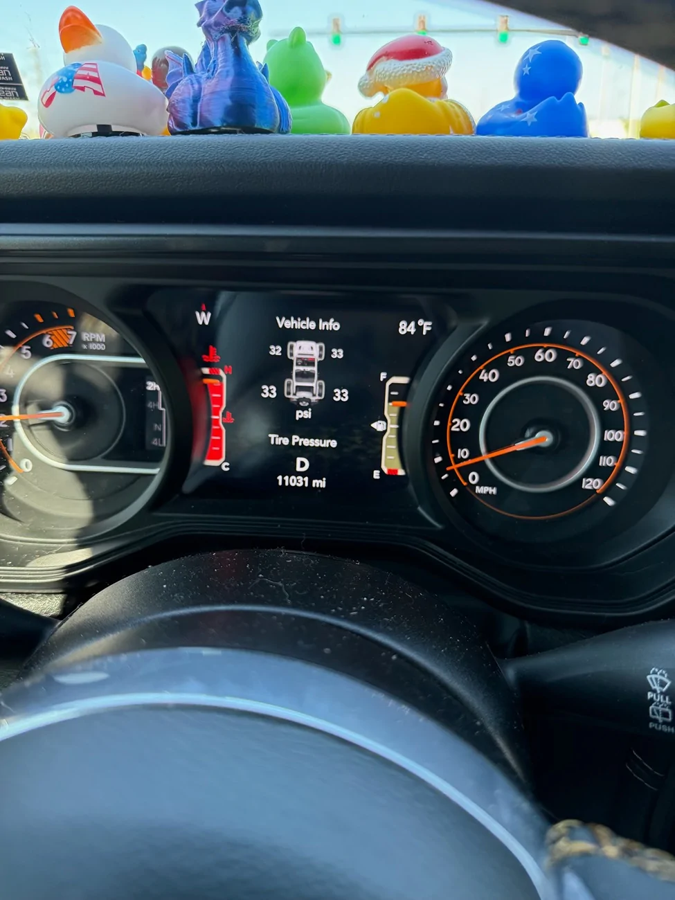

We had this happen yesterday. 2024 JLU 2.0T with 11k miles. It’s at the dealer being diagnosed.
Jeep Wrangler JL 2.0 Coolant Overheating issue IMG_9403
