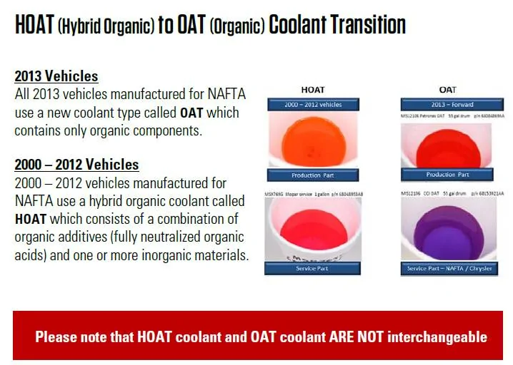

What antifreeze, did you put back in it? OAT 50/50 pre-dilute is what is required.
I took it in to a well known 4x4 mechanic in my area and he assured me this was all done I looked at all the parts he used as well and it is all mopar parts and pre mixed antifreeze. Could be possible there still is air inside even after all this as well I’ll consider it for sure because I am stressing out and have no idea what else to look for in this situation.
Even though they put in genuine Mopar anti-freeze, they could have used the wrong anti-freeze.
2012/2013 is the cut-off point for the HOAT to OAT transition.
Jeep Wrangler JL Overheating issue coolant_warning
Not saying it is either of those, they're just possibilities.
