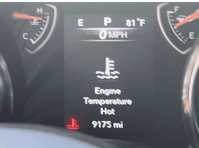

Just happened to me today for the first time. Fine in the morning. Got out of work about 9 hours later and heard the fan a little louder than usual but didn't make anything of it. Luckily, I'm just a few miles away from home. After a few red lights, noticed it getting louder and even my daughter mentioned it. Again, didn't think anything and actually looked at the gauge and was still normal. All of a sudden it spiked and went pretty much to the top of the H, while stopped. As soon as I took off, it came down. As you can see, I only have 9,175 miles. Already had a bad blower, 2 dead batteries caused by ESS and now this. I've had four Wranglers, all 3.6's and never had an issue. Was very skeptical about a 2.0 4-cylinder Turbo, but it does drive nice. Two years in and under 10k miles, this is ridiculous even if I have warranty. My question / concern, should I drive it to the dealer or have it towed? I'm calling them tomorrow but have seen some threads here that the dealer didn't want to pay/cover because they said the owner was negligent. And on a funny note, and no joke...I have scheduled an appt to get a new tattoo Friday and was gonna sneak in a silhouette of a Willy's Jeep in there....seriously...Now I'm wondering if I should wait since hopefully this doesn't draw me away from the Wrangler.
Based on your mileage it most certainty is a leaking water outlet, but that's just a common guess. Fill the coolant and drive it to the dealer or call jeep and have them tow it. You won't have to pay a dime.
As to the dealer declining repairs there's just no way? What dealer could lie so blatantly like that? Negligence for overheating a sub 10k mile new Jeep? Come on. Name and shame that dealer. Absolute scumbaggery.
At my shop you could overheat it and drive it until the engine locked and we'd cover it no questions asked. Absolutely ridiculous. It isn't your fault our vehicles' build quality has gone into the gutter over the last few years. I never understood these stories about dealers declining warranty repairs on bad faith. I've never seen it happen myself and both dealers I've worked out went out of their way to get things good willed left and right to the point of it getting annoying.

Just got it towed to the dealer, let's see what they say. They called me and said it wasn't doing it so lucky I took pics and a video showing it and you can hear the fan really loud. In their hands now.

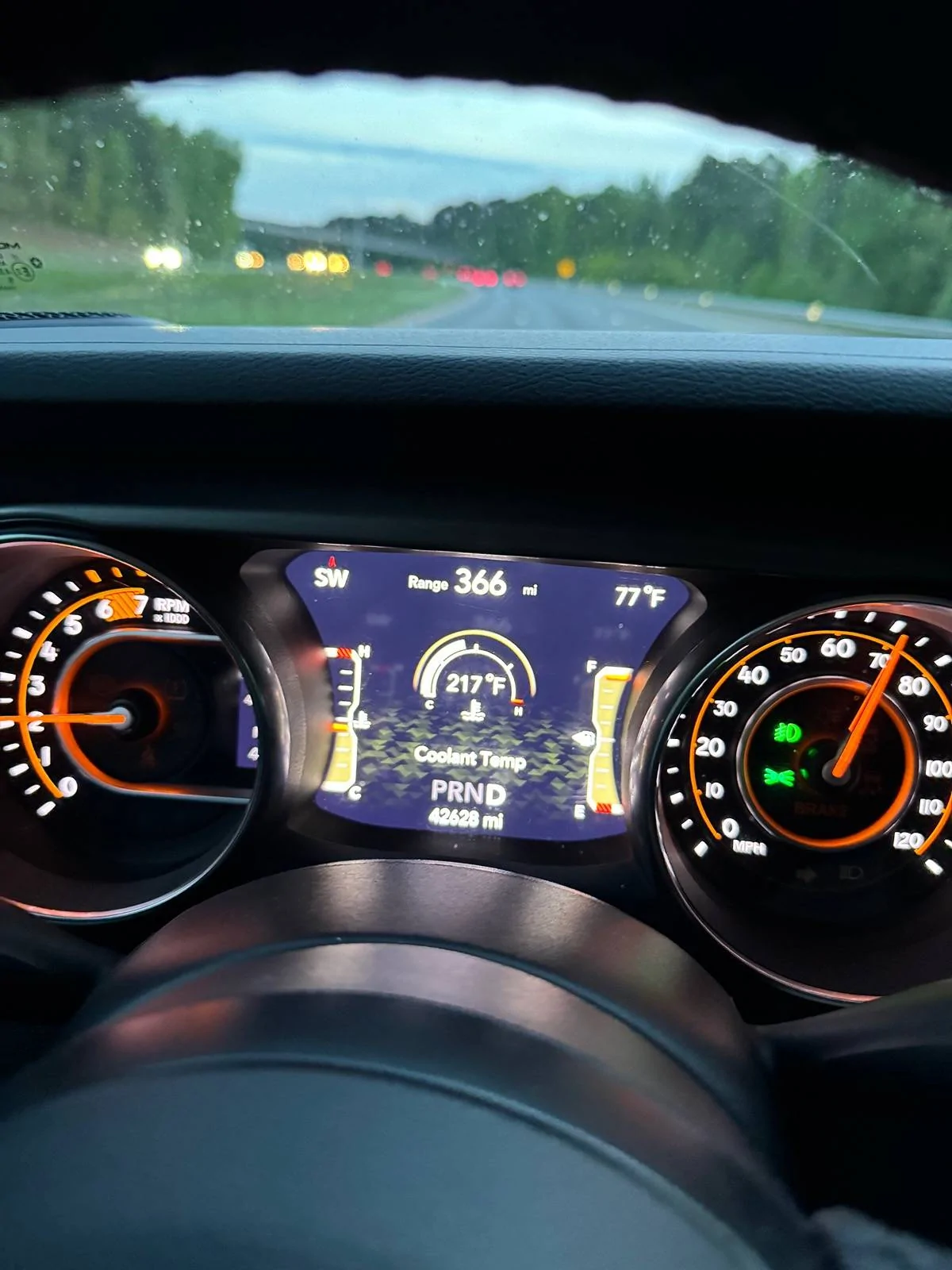

****UPDATE****
New temps while driving on the highway.
Jeep Wrangler JL Overheating while iddling 2.0T IMG_2578

to echo @SargeDiesel some time thermostat when going bad require some assistance to open up and this show up as extra water pressure that increase with rpm.
I did have a similar issue on the JK but I was also having the water fall therefore air in the system. Except for the water fall symptom it was the same, high temperature while idle and normal temperature while driving. Was usually seeing this while waiting at the drive thru, my simple answer was to just rev the engine at idle to create more flow.
Carlos
Dec 16, 2022
Georgia, USA
Jeep Wrangler Unlimited JL Willys Sport 2.0 Turbo
Yes i have to rev up the engine while idling so the temps go down
