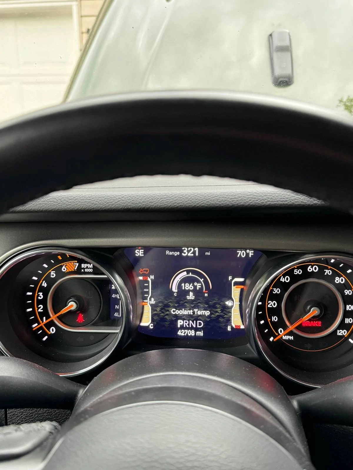

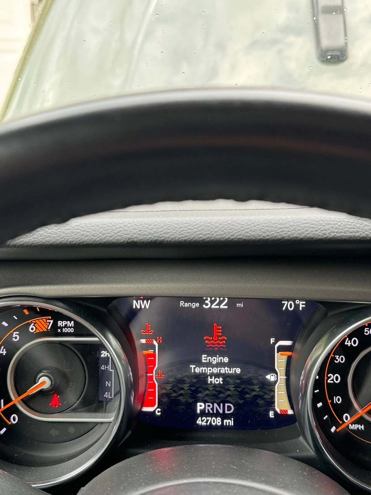

So it spiked up while iddling (fans were on full blast) :/ weird thing is that after Rev it up for 10 seconds it went back to normal temps.

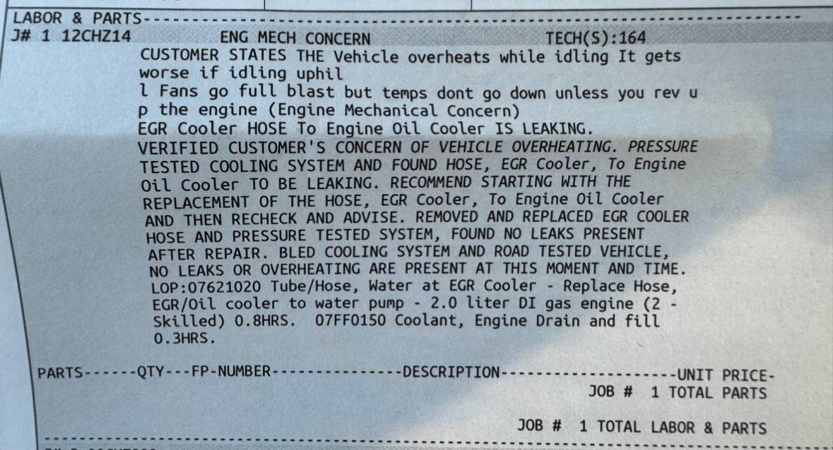

So I took it back to the dealership so they can fix it. Here's the diagnostic. It's all good now.
