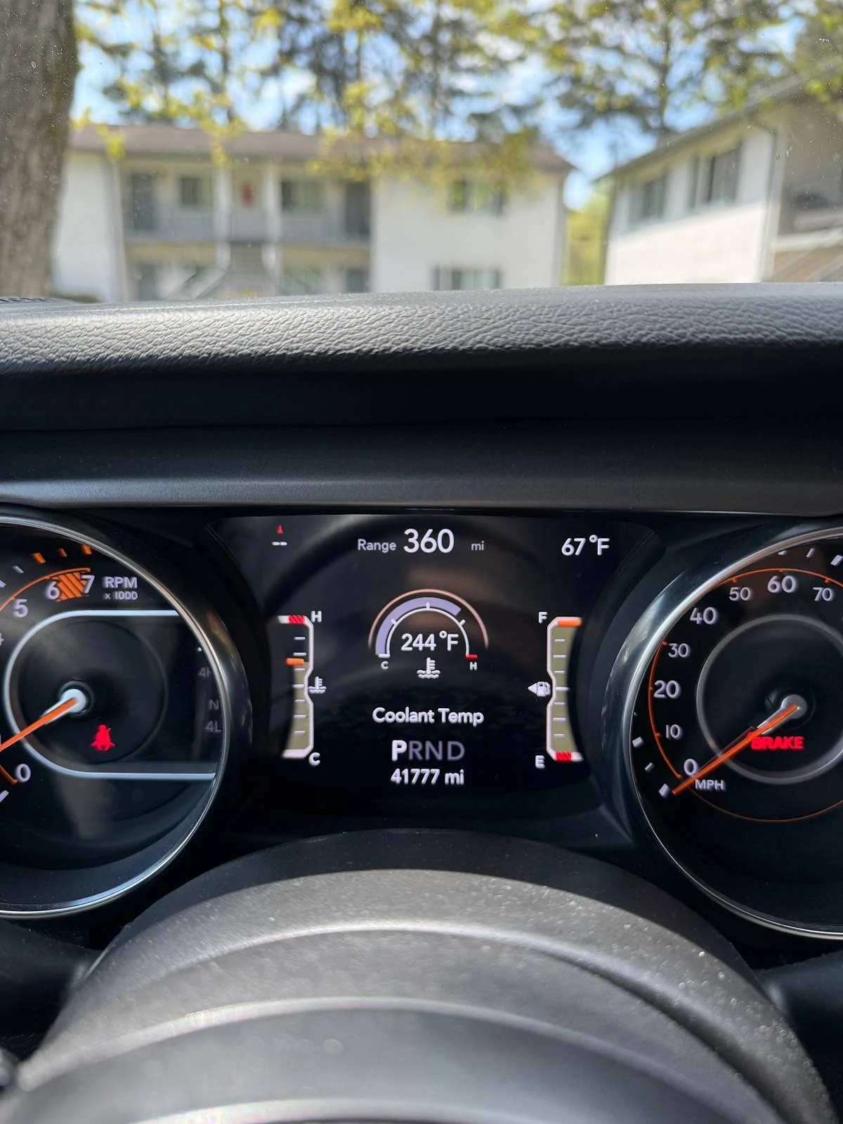

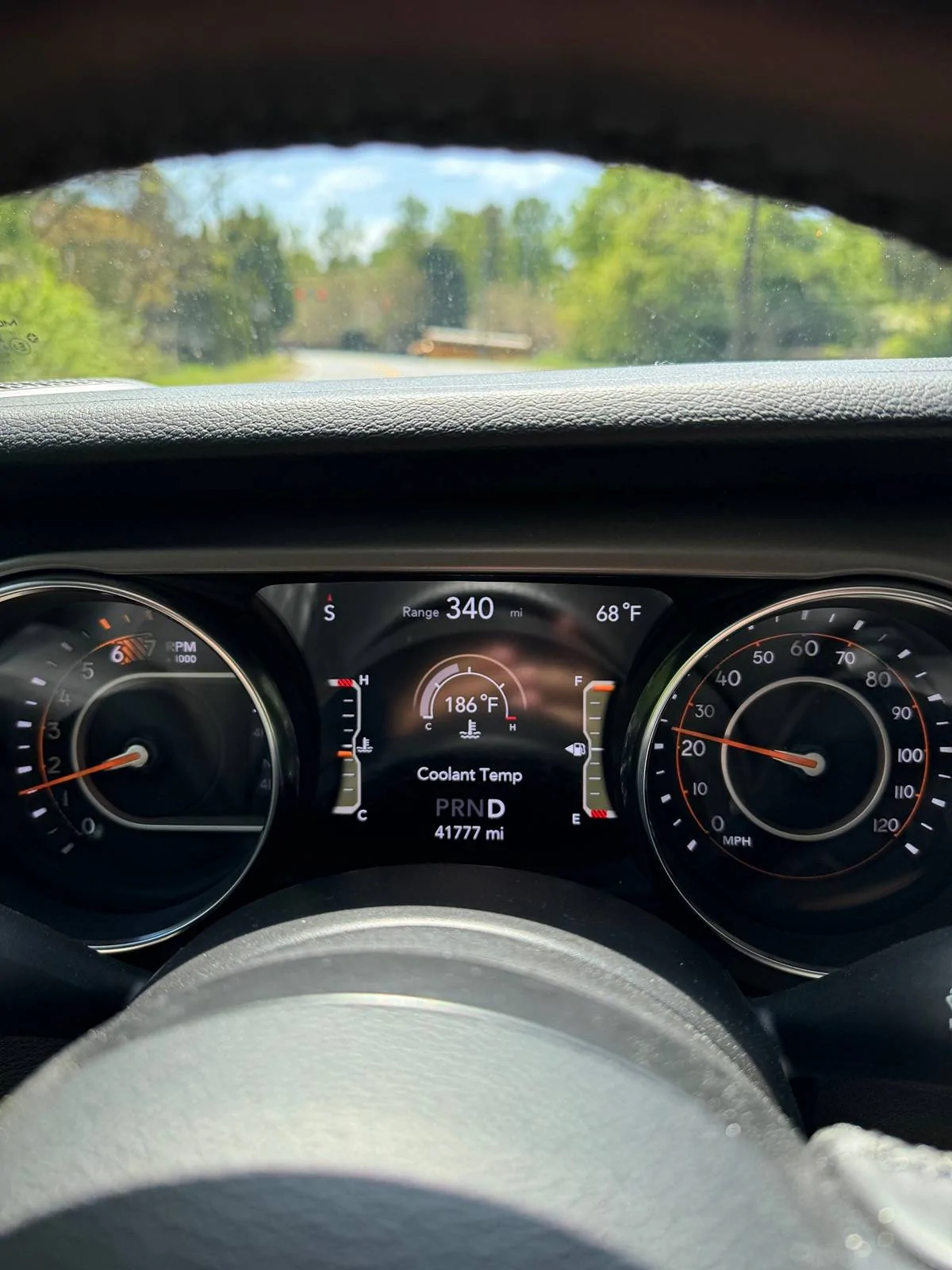

Hello guys, my Jeep is overheating again when it’s parked. I’ve already taken it to the mechanic in the past for the same problem, and they’ve changed the water pump and then the engine. Now it overheats when parked, and when I start to accelerate or move the Jeep, the temperature goes back down. By the way, the air conditioning is not as cold as before. Could it be the radiator fans? Although they make a lot of noise when the temperature rises.
Do you have any idea what it could be this time?

Is it really that hot, get a IR thermometer and shoot the temps on the radiator, hoses, etc.
if it is that hot, thermostat first thought. Are you losing coolant?

Anything blocking air flow in front of the radiator? Just for $hits and grins, see if you can tell which way the fan(s) are turning. Maybe they're wired backwards and turning the wrong way! You should be able to do this by having someone turn on/off the A/C while watching the fan(s).
It doesn't have any leaks.

I thought that, but it wouldn’t make sense for it to be the thermostat if it only overheats when iddling and not when I’m driving.
Yes, it can very well be a bad thermostat.
You asked and I offered a suggestion. Take it or leave it.

Are your fans kicking in when it overheats?
