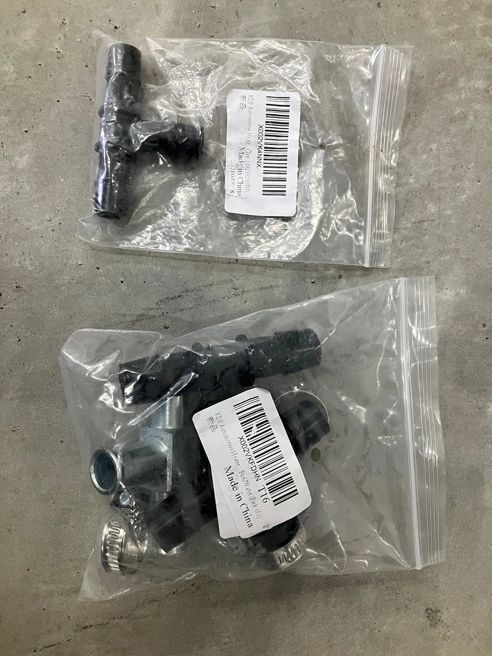

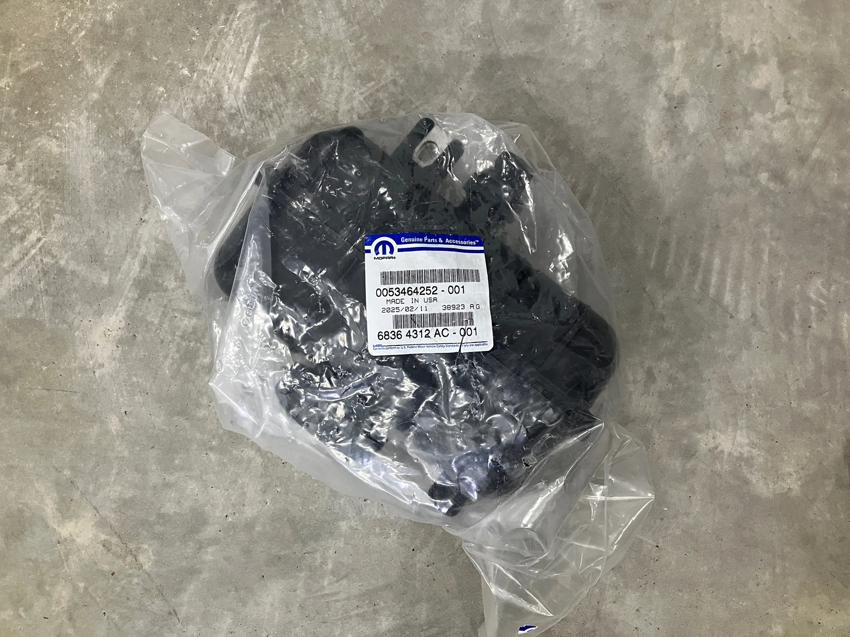

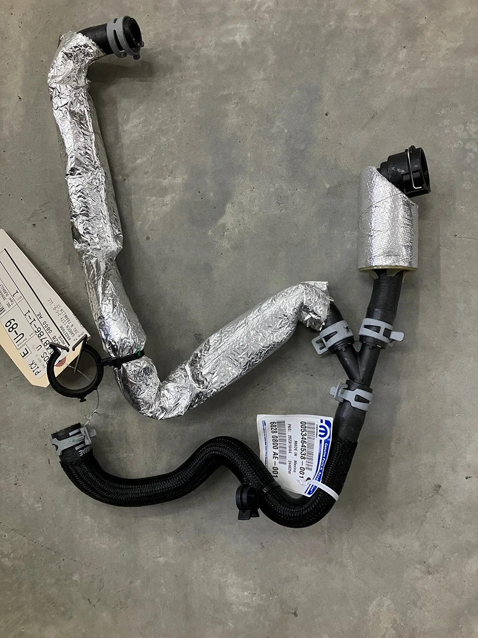

It's worth getting a spare coolant outlet hose ($60, 68280800AE) and heater hose ($21, 68280784AB) since the plastic fittings can leak even when you replace the expansion tank with metal. I just carry a replacement expansion tank ($65, 68280784AB) rather than replace with aluminum because I can't bring myself to buy a pressure vessel with poorly welded corner joints. Still, plenty of people use them without a problem.
The plastic Tees are 5/8 x 5/8 x 5/8 and can be found at auto parts stores. I carry one plus some plastic versions and a 1/2 x 1/2 x 1/2 Tee as well.
