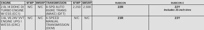

The 2.0 Turbo Engine isn't even offered on the Jeep Build & Price website anymore
Remorseless
May 10, 2022
34,646
193,863
NC
The build and price site is garbage. The order guide is what can actually be built - currently your only options are:
Jeep Wrangler JL New 2.0L Turbo Issues? 1726253721638-jg
