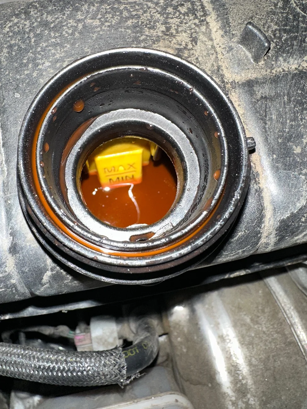

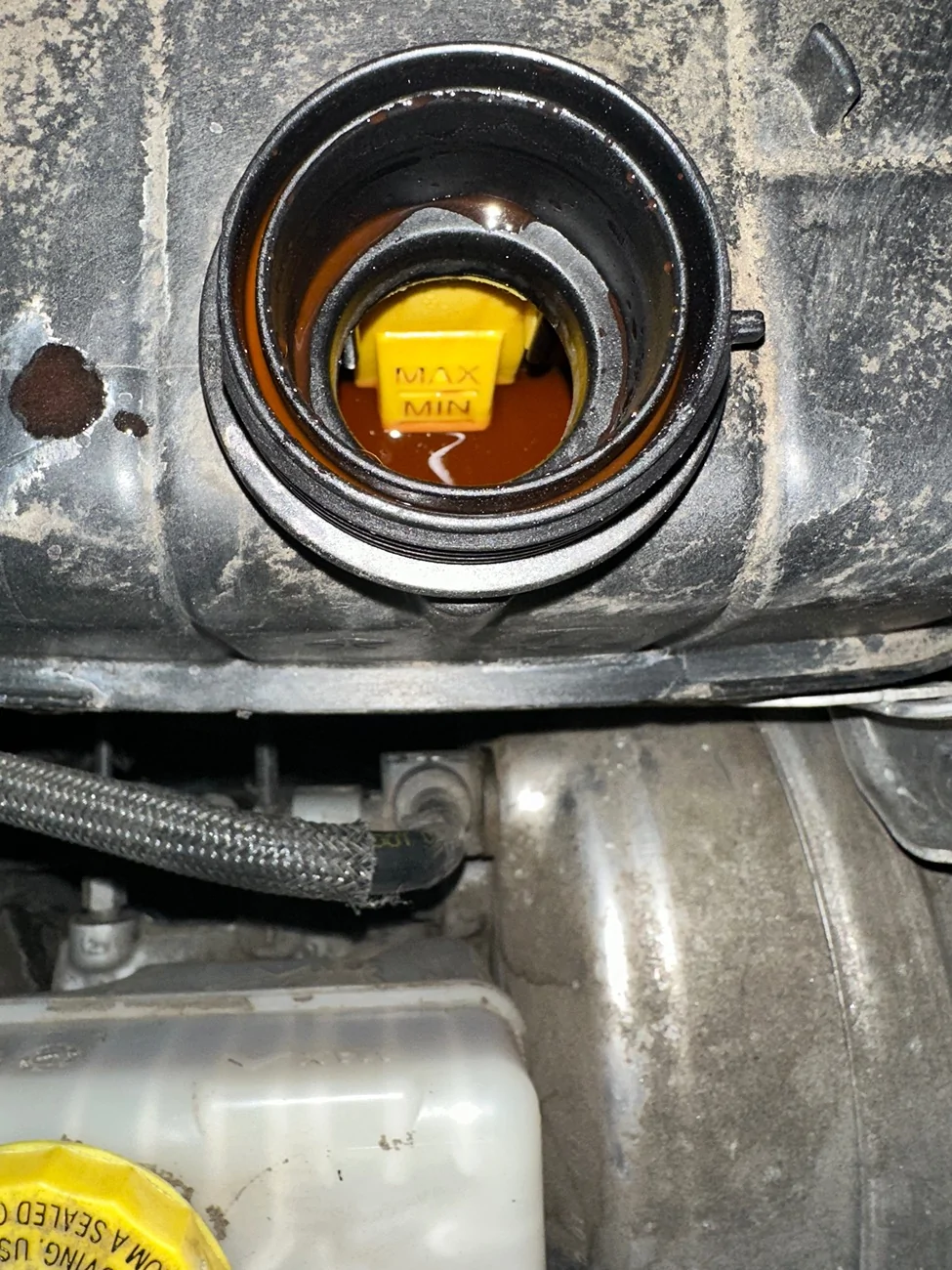

AM vs yesterday.

could be the angle, but that looks a little lower.
Top is actually this morning so the top one is higher vs yesterday which looks a tad lower. So since Friday there are pics which go from monday down to Friday

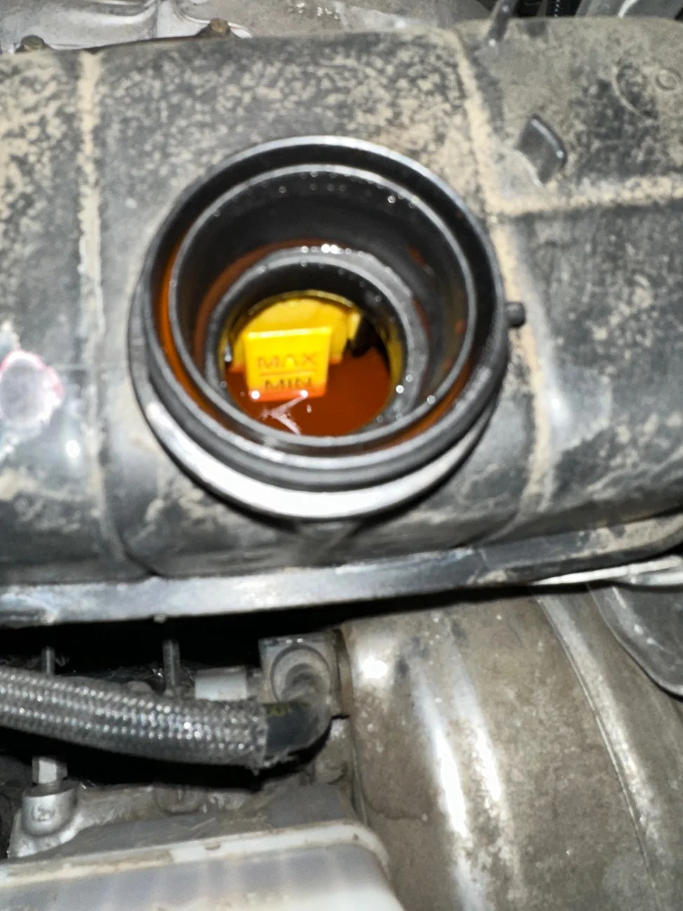

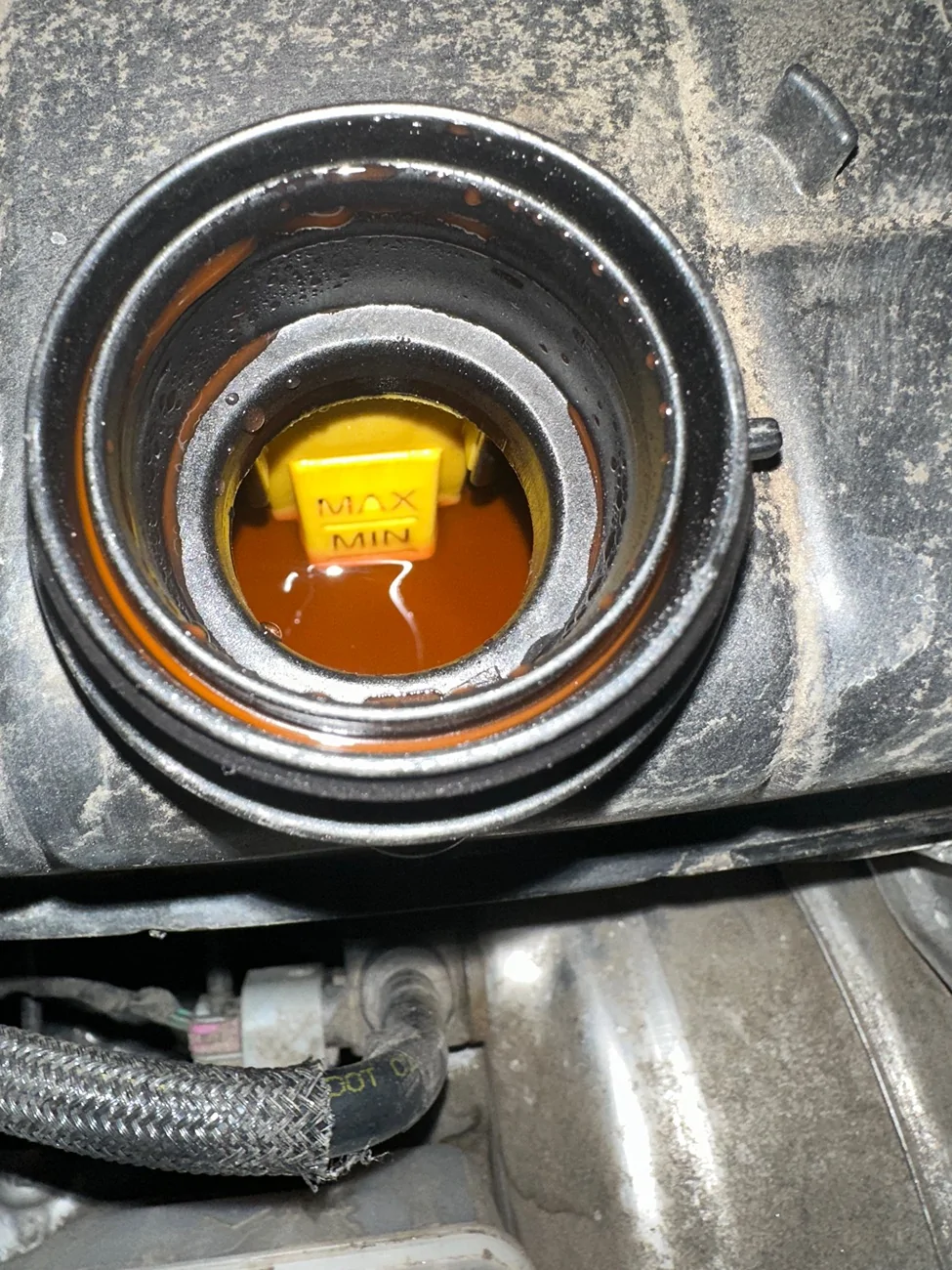

Monday first pic. Sunday second. Saturday third. Friday last pic.​

That does look good.
so in my eyes i see no issue with levels. first day high second and third day a bit down but today back to higher like first day. all at same temp in my garage. not started for the day yet.
if i was burning coolant getting into the engine or had a crack or leak going into the engine would i see a difference in level by now you think. i know that's hard to say but in your opinion or anyone elses opinion?
