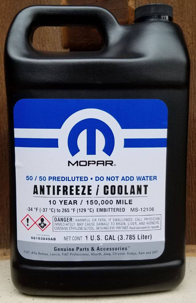

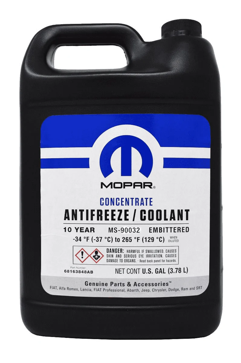

What's the difference with this one? Manual said MS.90032?
The below is the concentrated. This one has to be premixed before using. 50/50 with distilled water..FYI.
Jeep Wrangler JL 2022 Rubicon JLU Overheat Warning 749A3744-7658-431B-8856-8E5861190285
Jeep Wrangler JL 2022 Rubicon JLU Overheat Warning 64289DD5-FF9D-46B0-A5D6-9E46CAA0363E
The above is the premix 50/50 concentrated and distilled water mix. This one is ready to just use without any more premixing.

But it shows 50/50 prediluted too for MS.90032.
I guess MS.12106 and MS.90032 prediluted are the same?
Just make it simple. Go to your Wrangler Dealers parts department. Tell them that you want a gallon of Mopar OAT 50/50/ mix Antifreeze. Good for 10 years, or 150,000 mile whichever comes first. That is all they need to know to sell you the correct antifreeze. Plus it will say it on the bottle.
