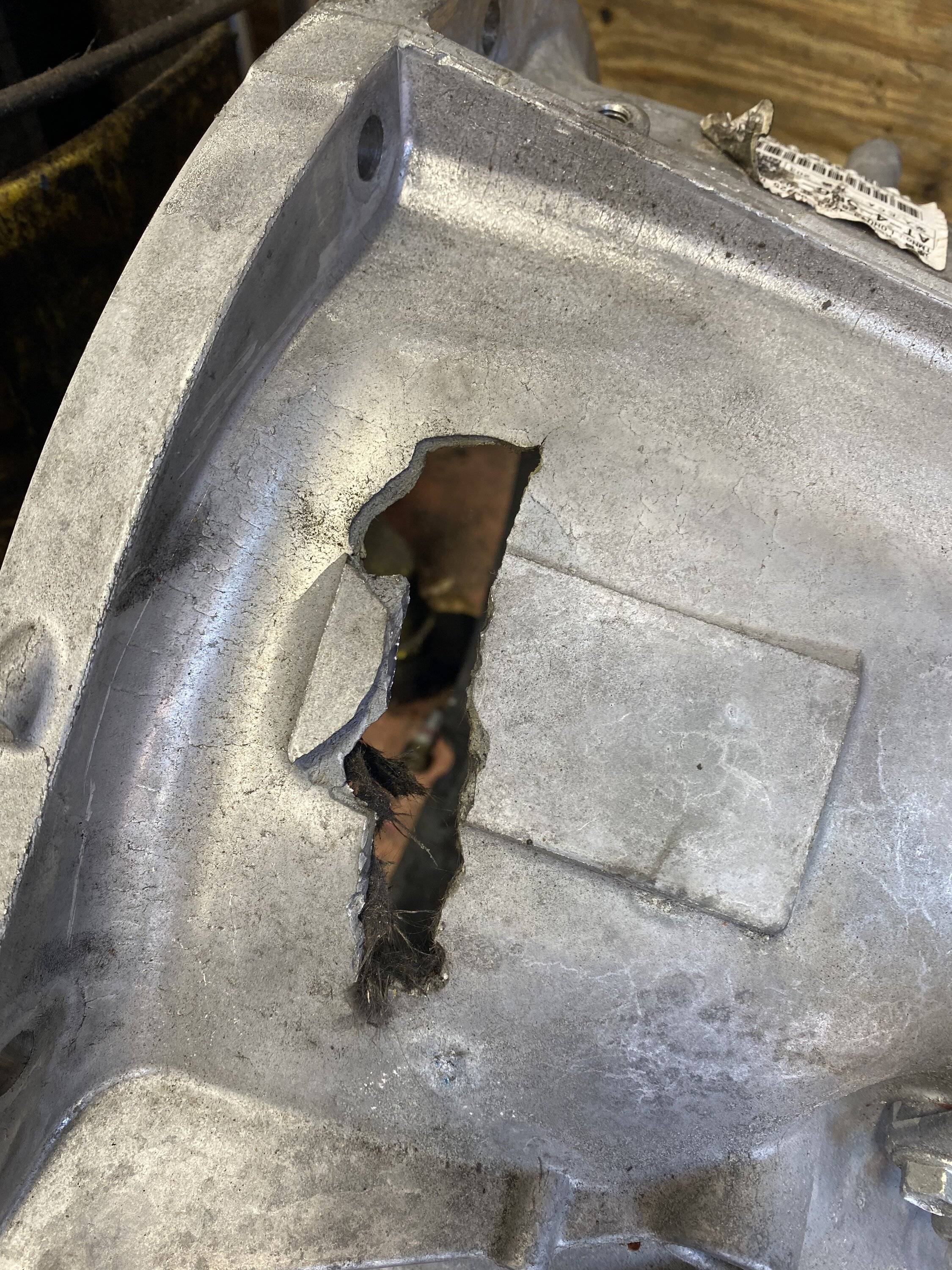

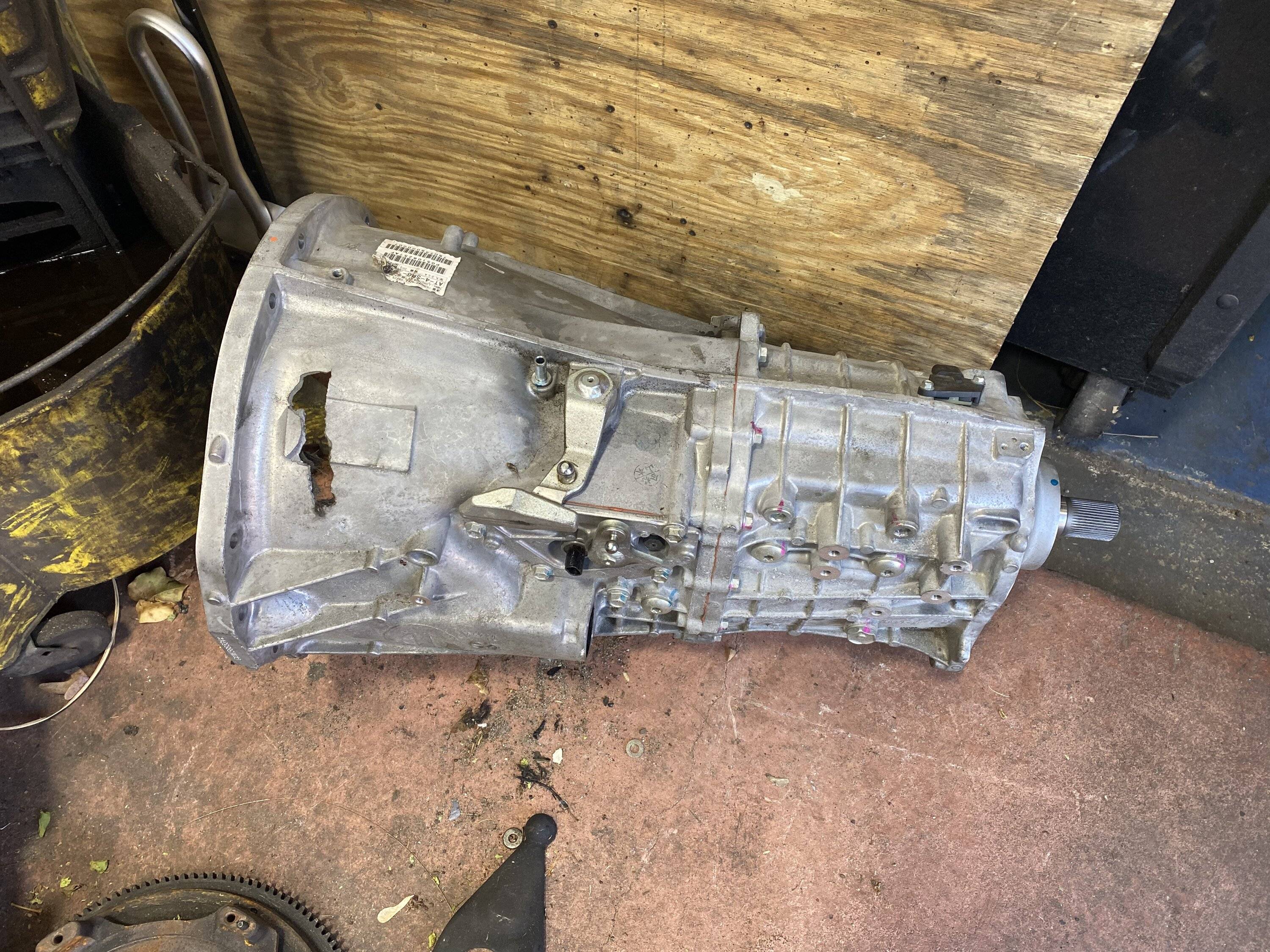

Yes. After paying for a rental for six months, my mechanic was finally able to get all parts and complete repair. Cost came to over $9,000. I drove cross country with no issues. I’ll be following up with a lawyer when I get back home next week.
These are pics of the hole blown thru my transmission by the explosion of what Jeep claims was misuse/abuse of the clutch.
Again, if anyone knows of any lawsuits pending on this matter or knows of an expert qualified to testify about same, I would really appreciate a contact.

That’s gonna be a tough legal battle to win. It definitely looks like drag racing damage, no traction loss like a 5000 rpm 4wd launch. A good indicator will be the clutch plate, flywheel and tires/wheel wells. If you were truly driving down a street and this happened did you show them to tow bill? Low rpm damage would have a hammering effect inside the scatter shield area. Loose parts would have been moving around as you coasted to a stop.
Op post looks more like a low speed damage. That’s the straps holding the friction ring in place. FCA probably used a low quality metal. Save all broken parts for testing. Good luck

Hey guys, I figured I’d let you know how my experience went as well. After kissing the service departments ass with a sob story the manager was able to cover the repair Under the 60000 mile power train warranty. I think I lucked out because he said that’s not something they normally do as clutch parts are considered wear items. Regardless, I only ended up needing a clutch kit, flywheel and throw out bearing (I think, it’s been a bit). I had a friend weld the small holes in my bellhousing and it’s been fine so far. I hope this helps.
