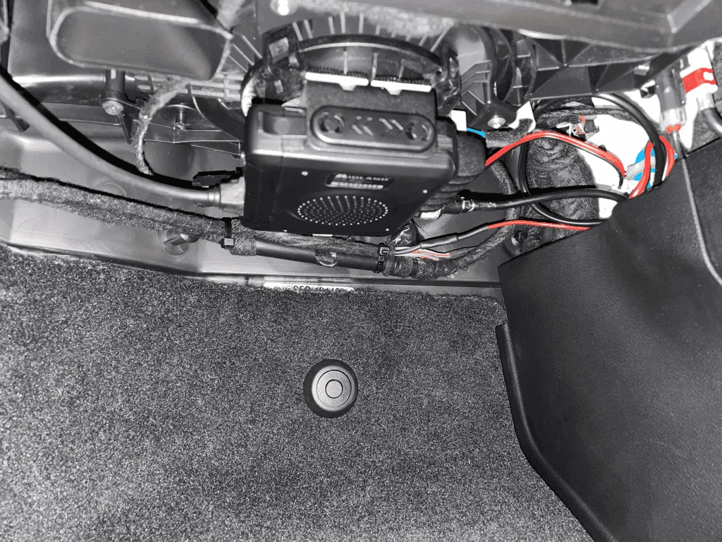

I'm running the MXT275 and have had no issues in 2 years. Mounted behind the glove box and handheld is by the passenger grab bar.

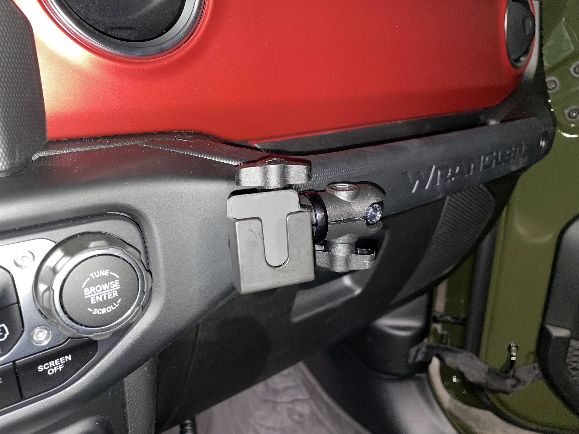

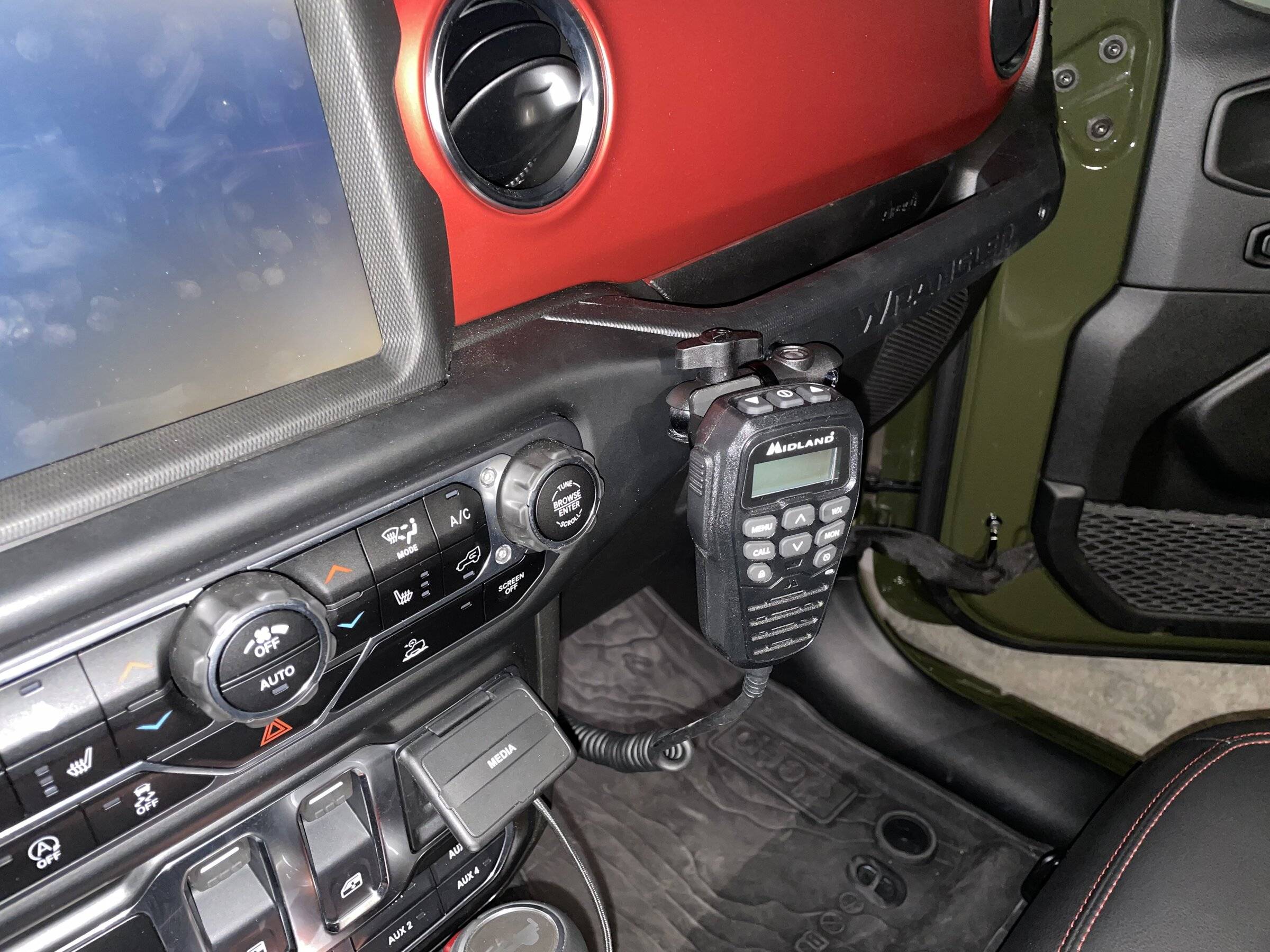

Yup! Did a huge write up here in my build thread if you want all the details. It’s a little wordy, but I attached a video I based my install off of so you can watch that as well.
I did end up with a different mic mount, though, after the Midland one failed a couple times. Posted about that here.
And here’s a few pics!

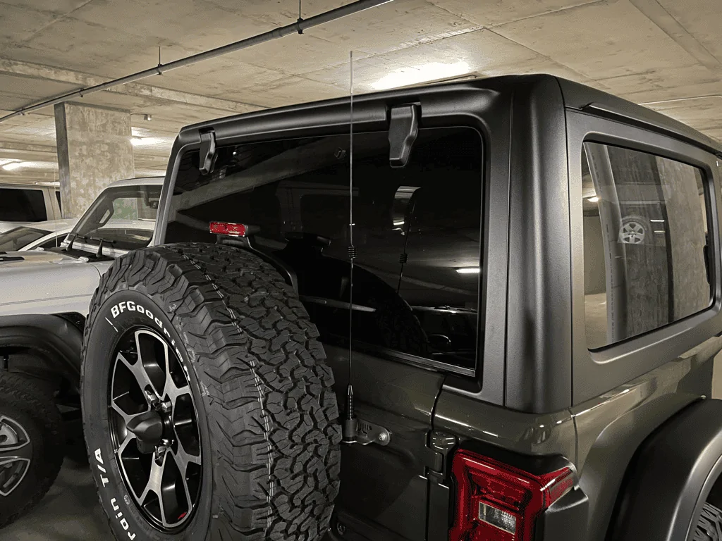

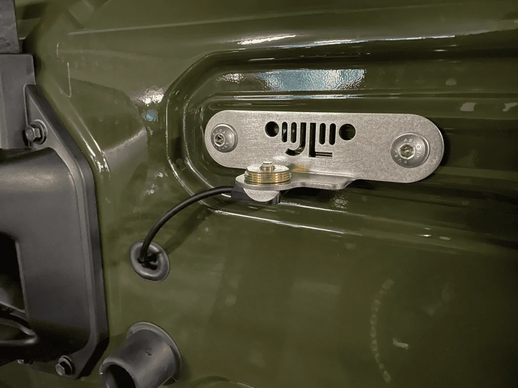

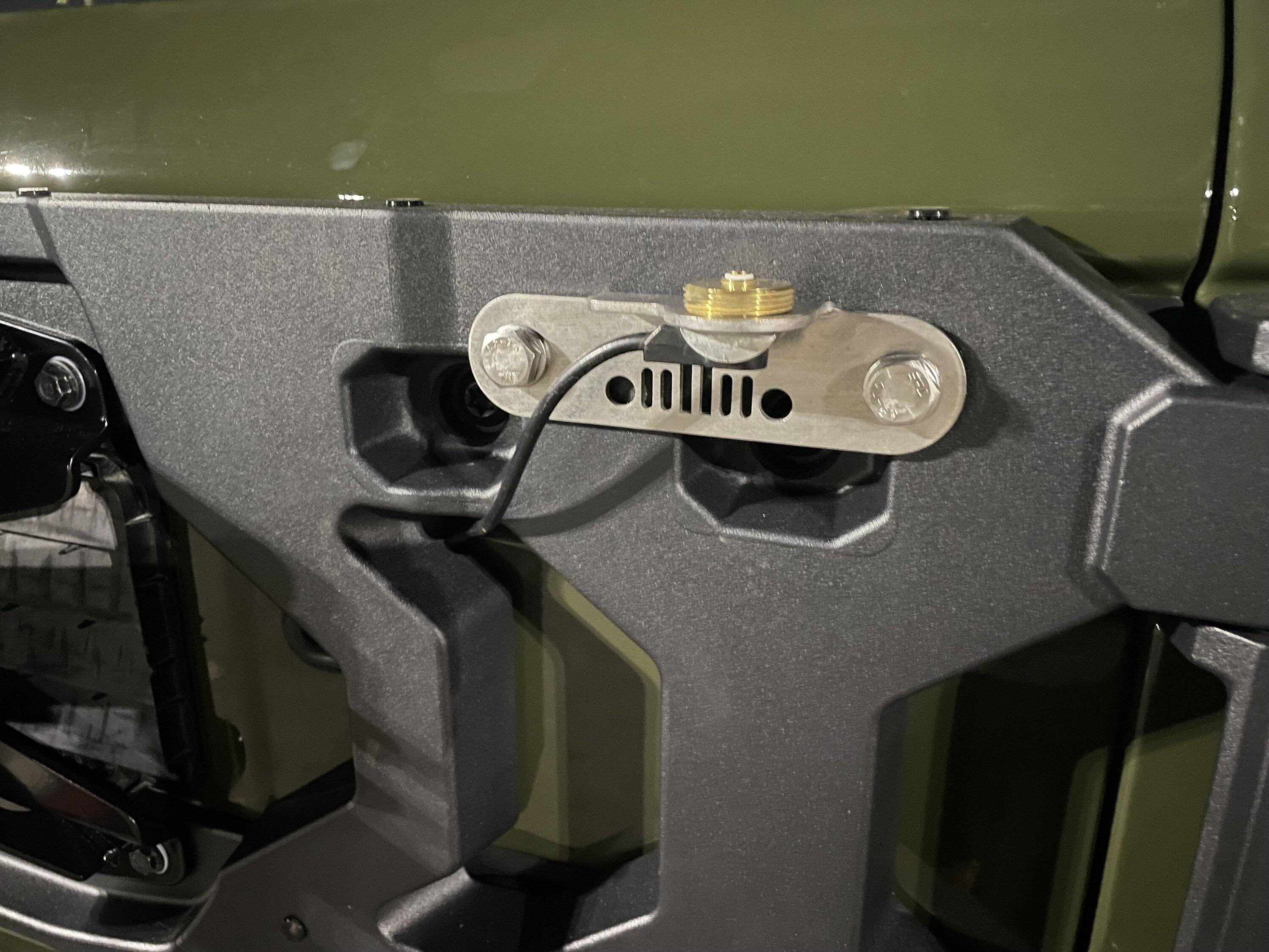

It’s actually a great spot for it as the hood is a good ground plane. I’m not a fan of that location either so I used a tailgate mount from CoolTech and mounted my antenna in the rear. Write up is also here in my build thread. ;)
I’ve since flipped the mount to clear 33’s and 35’s on the Teraflex Alpha HD hinge reinforcement and tire carrier, but it works great upside down as well. When I ultimately go to 37’s, I will likely have to take my die grinder to it for a little extra clearance, or do a full relocation.
