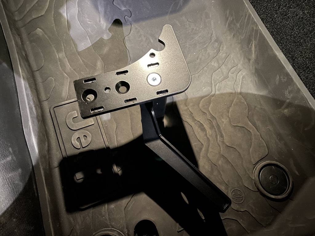

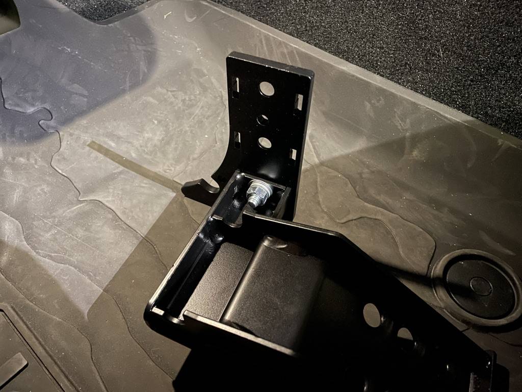

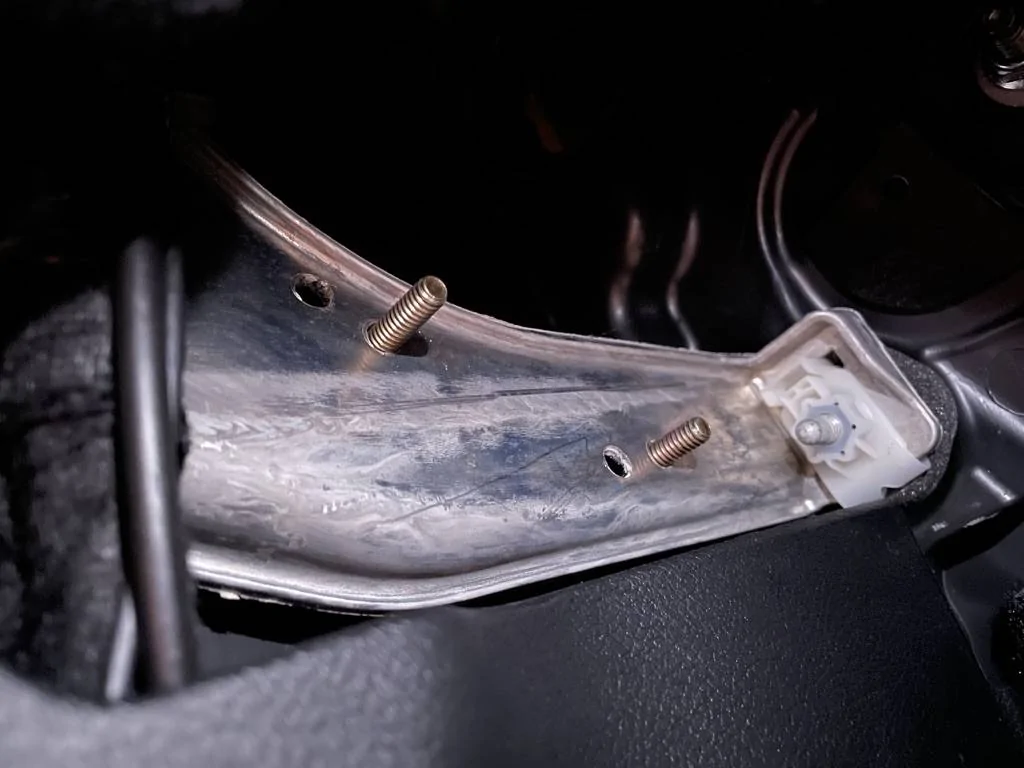

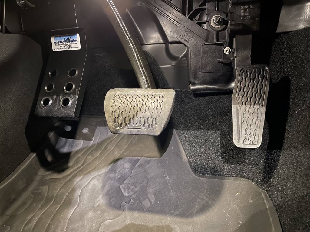

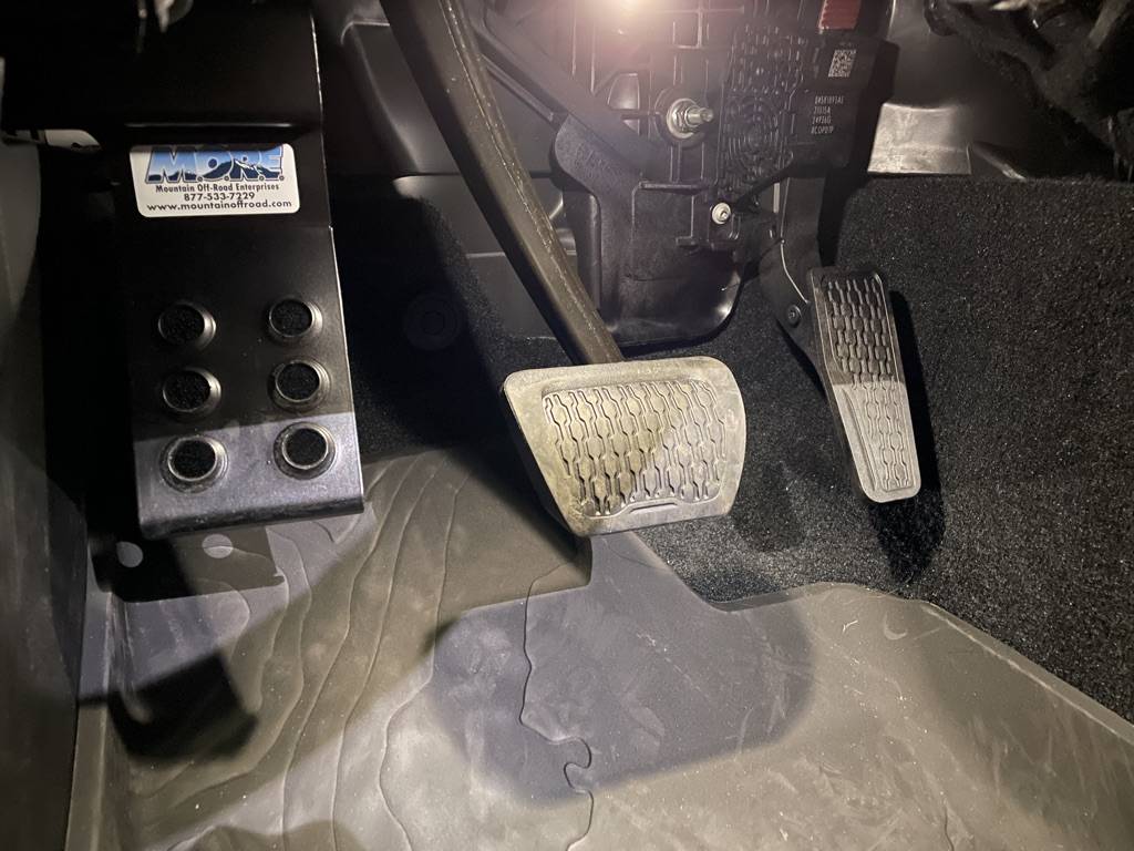

M.O.R.E. Dead Pedal
First mod has been installed! I have quite a few smaller/easier mods planned for the coming weeks and the dead pedal was first to arrive!
For those who don't know, a dead pedal is basically a fake clutch that you can rest your foot on while you drive. I don't feel like I need one during my daily commute, but I definitely miss having one on drives over 3-4 hours. Most of the time, if they come with the car from the factory, they are built into the floor pan.
I chose the M.O.R.E Dead pedal because it allows me to slip my foot underneath to stretch if needed and had really positive reviews. Not 100% sure it's worth the price, but so far so good! There are 3 adjustment settings and mine is on the setting closest to the driver. I might need to move it to the middle setting, but I am going to try it here for at least a week or two.
Install is fairly straight forward and can be done with a few hand tools. If you are smaller, younger, or relatively flexible, the install should only take you 15-20 minutes. For those that don't fall into any of those categories, I have heard it can take a few hours. Fortunately, I fit into all of those categories so it took about 25 minutes total to install on the furthest setting from the driver without tightening the bolts as a test fit, and then I installed and tightened the bolts on the closest setting. It will probably take just as long to undo it and move to the middle setting if I decide to adjust.

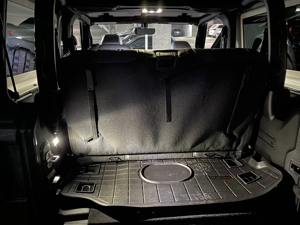

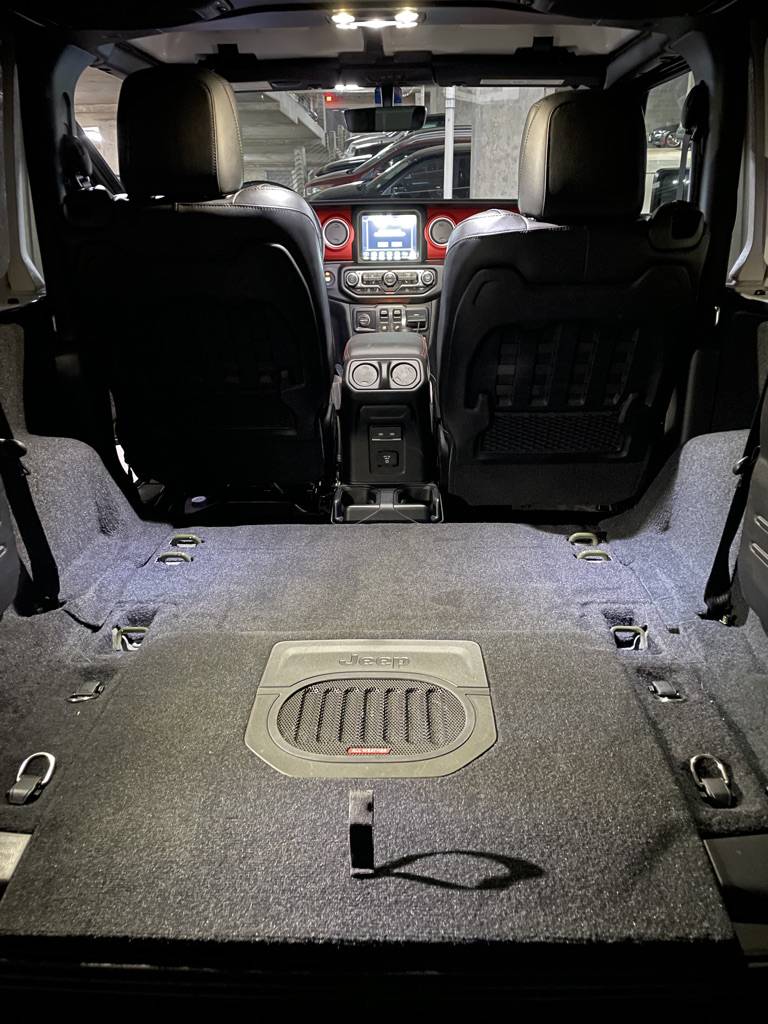

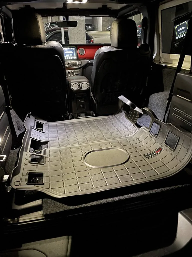

WeatherTech Cargo Liner
Probably one of the easiest installs you can do on a new Jeep! Went with WeatherTech because it gives me the ability to cut out holes for the hooks and subwoofer if I chose, run the back seat in or out, and still give me full coverage for dirty boots, tools, or whatever else I need to haul around.
Super Happy so far!
Disclaimer: It was rolled up in a tube upon arrival and hasn't had time to heat up and flatten out. I reinstalled the rear seat to help keep it flat until then. I will update with more photos if/when it flattens.

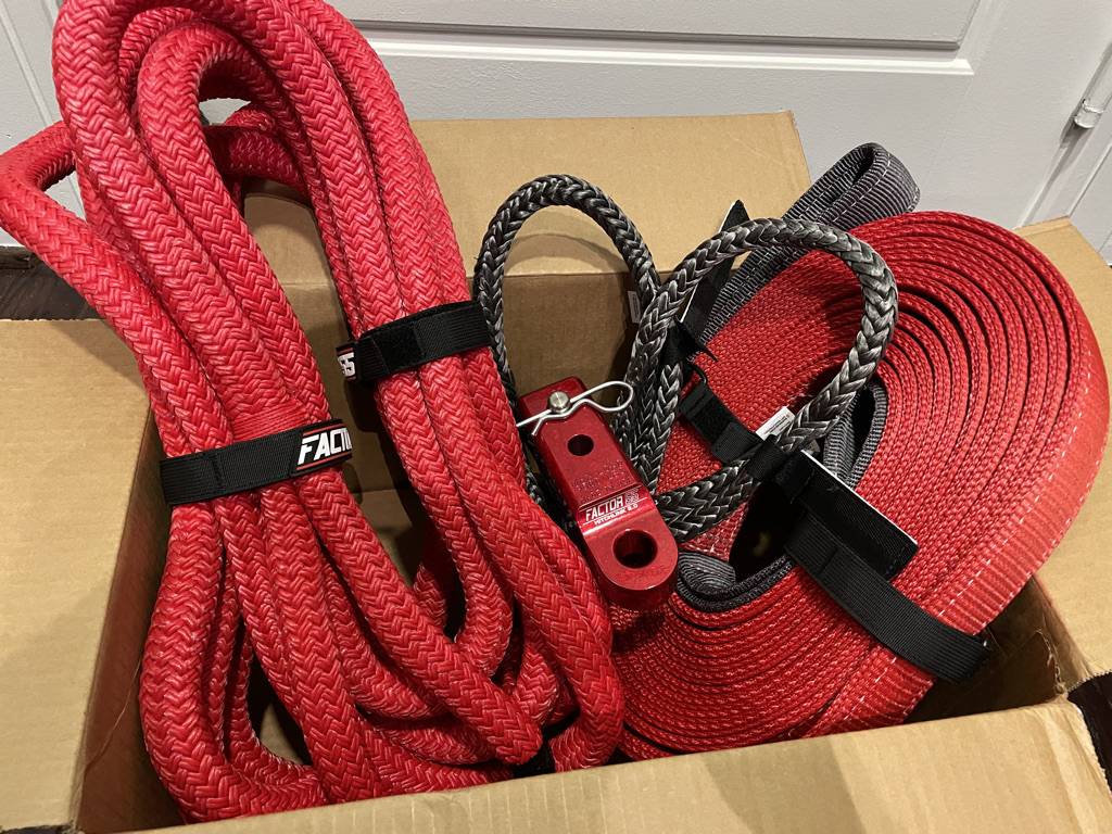

Factor 55 Recovery Gear
Not really a mod, but just acquired some of the basics!
I already have some stuff from my last Jeep, but nothing this nice and wanted to make sure everything was fresh and safe. I am of the belief that recovery gear is not something you should skimp on, and I know Factor 55 makes some of the best!
Super happy with the quality so far. Can't wait to put it to use!

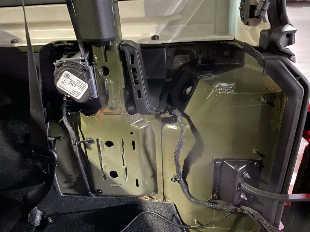

Midland MXT275
Going to have a few parts to this post as I mixed and matched with more than came in the box, but it's pretty straight forward.
Before I start, I am not a radio guy. I knew nothing about them before purchasing, but the MXT275 seems to fit the bill of everything I want. It's compact, simple, and semi-permanent depending on how you power and mount it. Did a bunch of research and it seems like CB is on it's way out, and I can always pick up a couple of handheld GMRS radios later for friends to borrow (assuming they are licensed) and for spotters.
To legally operate this radio, you must be licensed through the FCC. At the time I am posting this it is still $70, but the price is supposed to drop to around $30 at some point. No classes are required.
For the install, I followed the directions on the attached video for my wiring and mounting location, but that's about it. I did think the velcro was an excellent idea and copied that as well; however, I have yet to remove it because with the doors on and the mic disconnected, it is invisible.
Chose to go with a different antenna, mount, and location that made my install time much longer. These will be in the following post.
Install video:
My AUX wires were connected and routed a little different, but it was clear it was the correct bundle after I did some searching on the forum. You will only have these wires if you have the factory installed AUX switches. The kits installed after the fact do not have the wires I used to tap into the battery.
I am aware the way I have the antenna wire wrapped and routed can potentially cause issues with SWR. I am currently waiting on some adapters for my SWR meter to make sure I don't have to redo anything, but according to Midland, tucking extra wire away in the fashion it was shipped shouldn't impact SWR. Just like their antennas are pre-tuned so they shouldn't need to be adjusted. We shall see, and I will update with any changes later.
Lastly, I want to comment on the Midland mic mount. It's light and a good size, but the adhesive is terrible. I left the mic hanging over night after letting the adhesive set for 24 hours and I came out to the mic resting on the floor. I have since removed the remaining foam and adhesive and used 3M indoor/outdoor double sided tape to replace it. It feels exponentially more solid and it has only been sitting for a couple of hours. I will update on this if it fails too.

AUX wiring:
Jeep Wrangler JL 2022 JLR Build Thread - Stacy DE459967-147E-4292-AE20-D832071AD421_1_105_c
Radio wired and mounted:
- You can also see that I zip tied the AUX wires up along the existing wiring harness against the fire wall.
Jeep Wrangler JL 2022 JLR Build Thread - Stacy 05ED2D08-A457-48B4-AC4A-E796C5361659_1_105_c
Wiring behind kick panel:
- Leftover antenna wire can be seen as well as the ground location used.

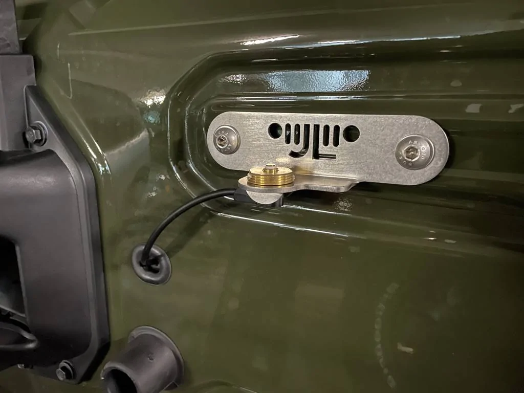

Cool Tech Antenna Bundle
This bundle includes the Midland 6 db antenna, Midland coax, and the Cool Tech JL NMO Mounting Bracket.
Super happy with this bundle! Not the best location for maximum signal, but it gets the antenna out of the way for tight trails and helps it not to stand out in the city.
Bracket install took maybe 15 minutes to figure out how to remove the backup camera housing and pull the spare tire. From there, close the tailgate and remove the two bolts, throw the bracket on, and tighten down the new bolts! Fairly simple.
The hard part was running the coax. I HIGHLY recommend purchasing some interior trim removal tools. Even with these I managed to break one of the clips for the tailgate trim, but it doesn't seem to be needed upon reinstallation. Everything is good as new!
First thing you need to do is punch or drill a hole in one of the rubber grommets on the tailgate. I used various screwdrivers to make sure the grommet was as water tight as possible with the coax and it was definitely the tougher choice. I ended up having to stick needle nose plier through the punctured hole to grab the end of the coax and drag it through. Maybe not the best idea, but so far so good and it is definitely a tight seal!
After it's through, you will need to choose how you want to route the wire. I went behind the passenger side cargo panel, up top near the hardtop bolts, then down the door sill. The door sill is EXTREMELY tight and a bigger coax would certainly not fit. It might be a better move to run up the roll bar and and down to the glove box.
Overall, the entire process including all wiring for the radio took around 4-5 hours. Pulling those interior panels on a Jeep less than a month old is nerve wracking for sure and really makes you take your time. Also, keep in mind I had no idea what I was doing and was learning everything as I went. I am extremely happy with the way it all turned out and hope some of you can learn from what I did!

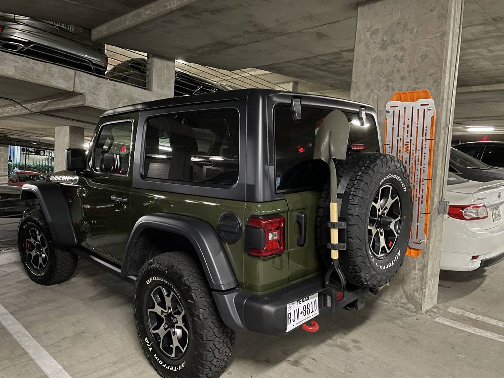

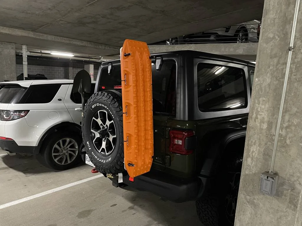

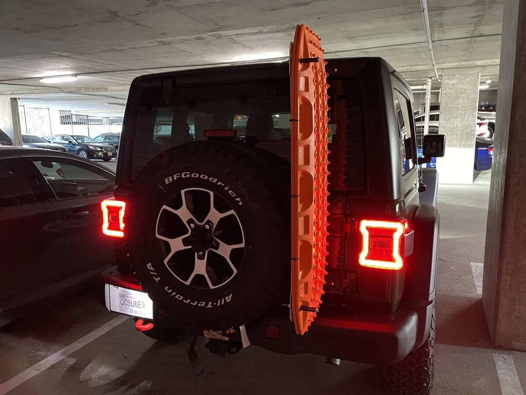

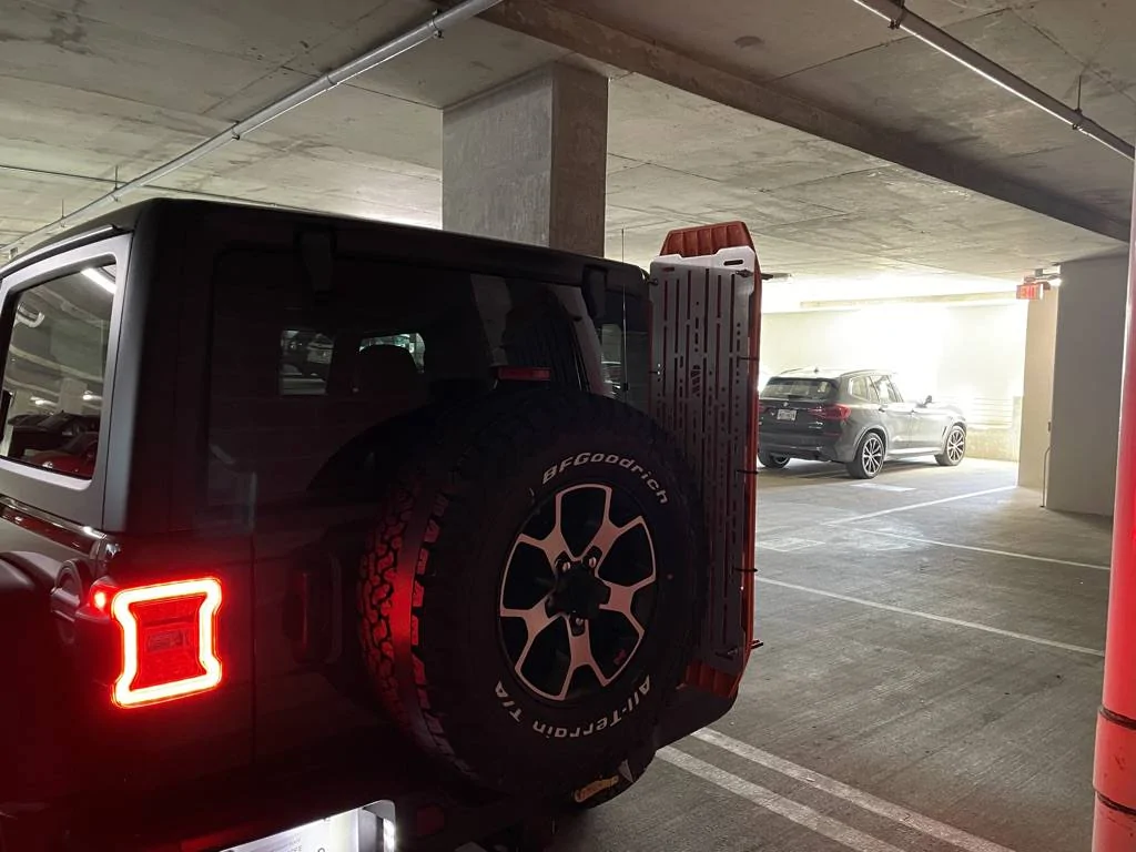

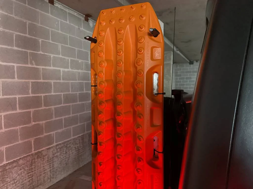

Maxtrax Mounting System V1
So this one is a bit creative, but I can't take all the credit. I was having a hard time figuring out how to make everything work when I came across this post by aseeber and decided to do the same thing!
First component was the RockSlide Engineering EZ Rack. Super simple design and the ratchet strap is plenty long to accommodate any sized tire. Only complaint is the powder coat is pretty susceptible to abrasion. I managed to scratch some of it off while test fitting everything, but I am not too worried.
Purchase Link
Next was figuring out how to mount the Maxtrax to the bracket. This is where aseeber's post helped me out. I decided to use the Warrior Products Maxtrax Mount in aluminum. Did not see the need to add any more weight than I have to, to the factory tailgate.
Purchase Link
Lastly, had to chose which color Maxtrax I wanted! Hard to beat the original orange. High visibility and it looks great against Sarge Green. I also went with their mounting pins so I can carry four boards if I want when I go to V2, but that won't be for a long time. V1 will not support four traction boards because of the lack of clearance between the tail light and mounting system when opened all the way.
Purchase Link
All in all, everything was pretty straight forward. I needed to test fit the EZ Rack to see how low I could mount the WP Maxtrax Mount, purchase smaller hardware than what came from Warrior (EZ Rack has smaller holes), then bolt it all together!
One thing that concerned me and I easily solved was that with all the mounting points near one location on the WP Maxtrax Mount, it gives it a lot of room to wobble and bow under the weight of the traction boards. I just grabbed a few zip ties and looped them through the nearest holes and everything tightened up tons. No more wobbling or bowing, and it's super easy to cut them and remove if I get stuck.
Biggest concern right now is interference with my GMRS antenna. I might have to move everything to the other side, but so far, so good!

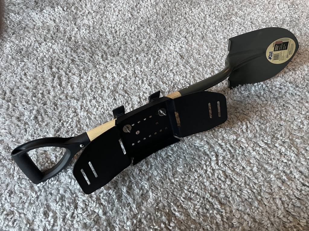

Shovel Mounting System V1
Did this a few weeks ago, but finally taking the time to add it to the build thread. Picked up a couple of Quick Fist mounts, some hardware, and a shovel and bolted it all on to the other Rockslide Engineering EZ Rack.
Quick and simple install, and I have the ability to mount everything to my spare in just a few minutes and remove it when I am done so nothing gets stolen. Also go the chance to test it all out off road! The Maxtrax wobble a bit, but nothing to be worried about. Everything stayed put going 70-75mph for 90 minutes on the highway as well.
Highly recommend this setup if you don't plan to carry your gear with you all the time, and don't want to worry about throwing muddy traction boards or shovels inside after use.

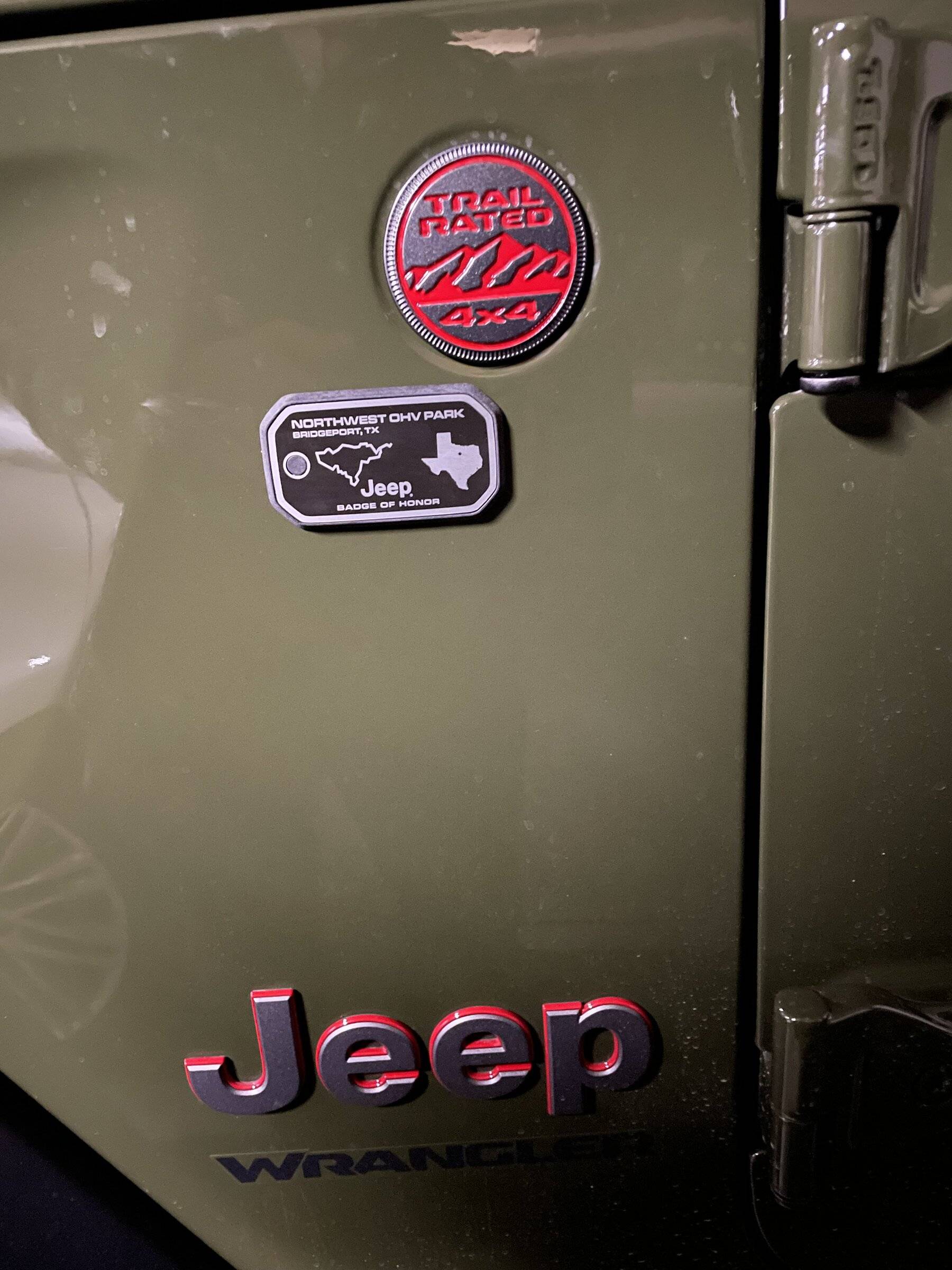

Badge of Honor Placement
First ever badge came in the mail today! Had to debate on whether or not I should put it on now or wait, and where to put it.
Decided to go for it and copied many others on the forum on the front fender placement. To make sure it is aligned with the 'Jeep' badge on the lower fender, I measure the distance from the bottom of the E's in 'Jeep' straight up to the bottom edge of the badge. For left to right alignment, I used a straight edge and lined the right edge of the badge up with the center of the 'x' in '4x4' on the Trail Rated badge.
First purely cosmetic mod and I can't wait to collect more!
