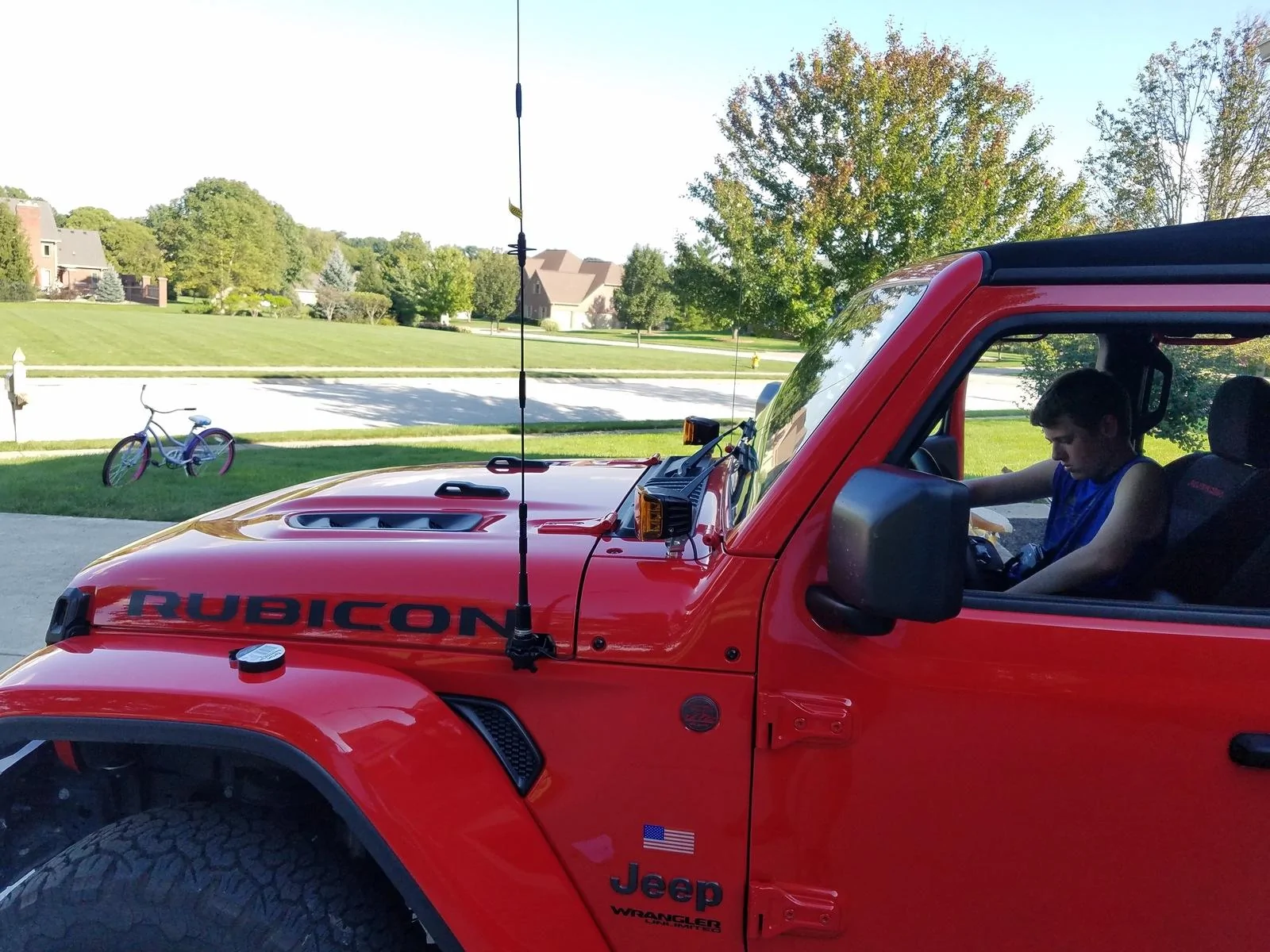

The Cooltech on the JK has a metal mount under the license plate frame that fastens to the body. The JL version has a stainless frame that is fastened to the tailgate with stainless bolts. It seems to be grounded as well as you can get on a Jeep. If you wanted extra assurance, one could attach a grounding cable.
The Midland Microtalk MXT275 GMRS radio on my JL now has a much better antenna and mount, pictured below. The JK will get a fender mount with a 6db Midland antenna, so the range will only get better with these. I was surprised with the little tiny magnetic antenna how far it reached. With the new setup on the JL, I was picking up handheld GMRS transmissions at 10 miles, with clarity. They were likely commercial handhelds, as they were people organizing a 10k run in downtown Indianapolis. I was conservatively 10 miles away when I heard them. Maybe 12 or 13. Anyway, I don't know how much power those handhelds had. There is a Midland with 40 watts available, too.

Ok, thanks for the info on the Cooltech, mounting up higher on the tailgate is much better. Btw any amateur radio shop will probably carry a pretty good selection of mobile mounts and antennas though what you are running looks good. My concern was that the Cooltech license plate bracket allowed the radiating part of the antenna (whip) to touch the plastic portion of the license plate bracket. In the wet I would have suspected it could cause some issues plus being close to body tub. But on the tailgate up higher would be a lot better.
With all the electronic things going on under the hood I wonder if our higher power UHF/VHF radios might cause some issues if the antenna(s) are mounted up front. I can't say I've ever read anything about this but just thinking out loud....

Which antenna lip mount is that?
It is made by Comet and I bought it at theantennafarm.com. I can't remember the model, but it has an NMO antenna mount. I'm using it with a Midland MXT 275 micromobile 15w radio.
