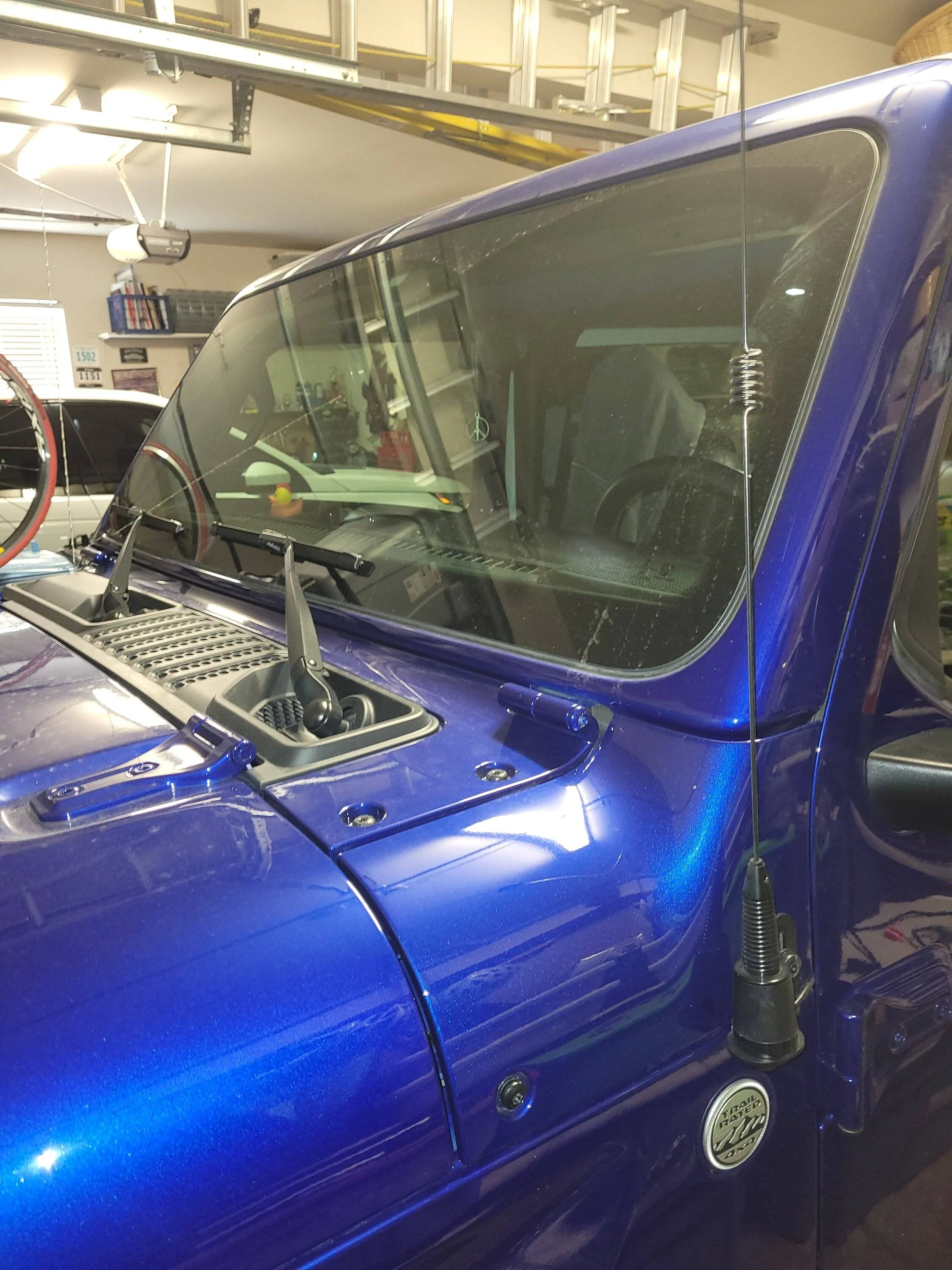

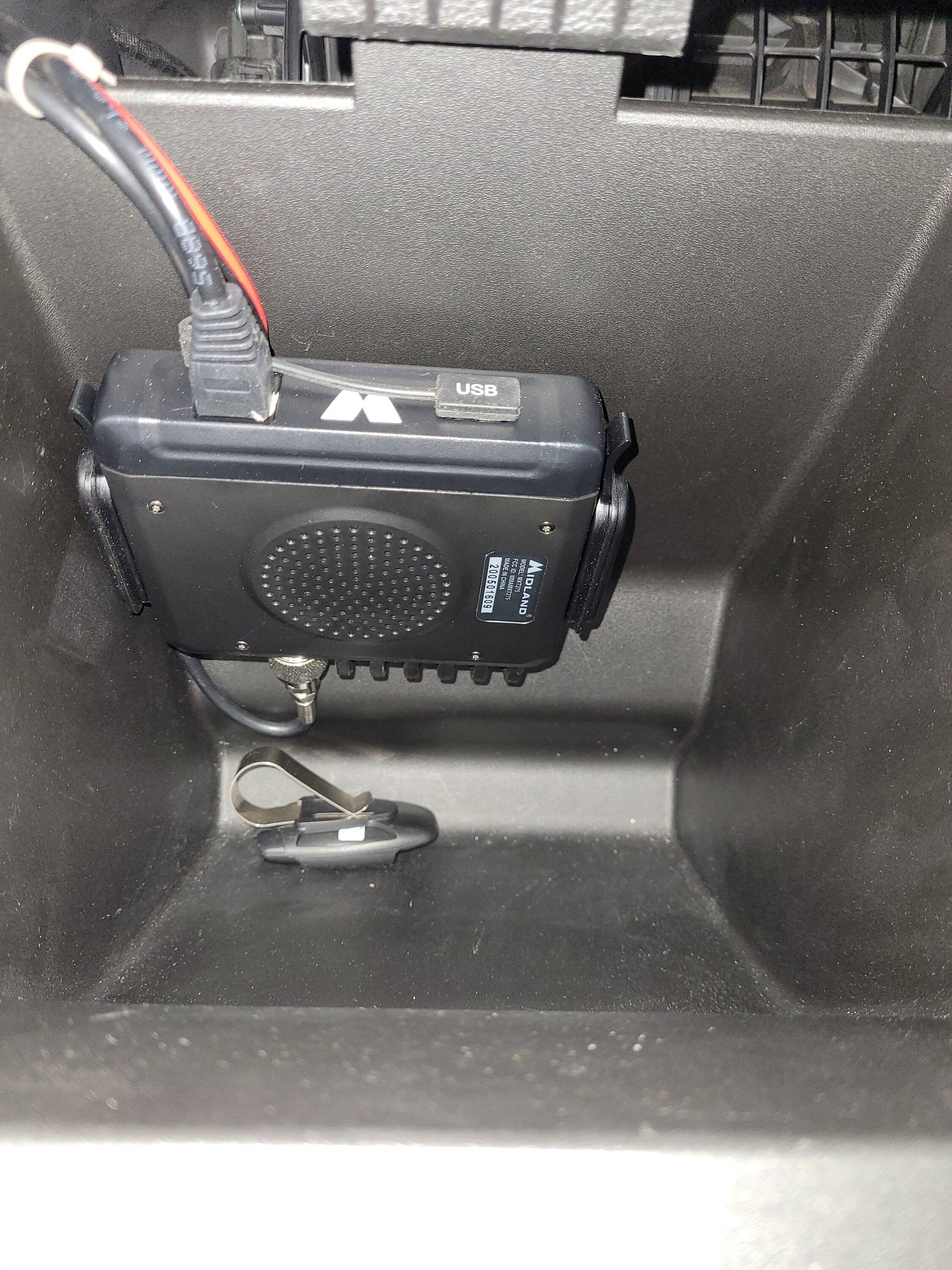

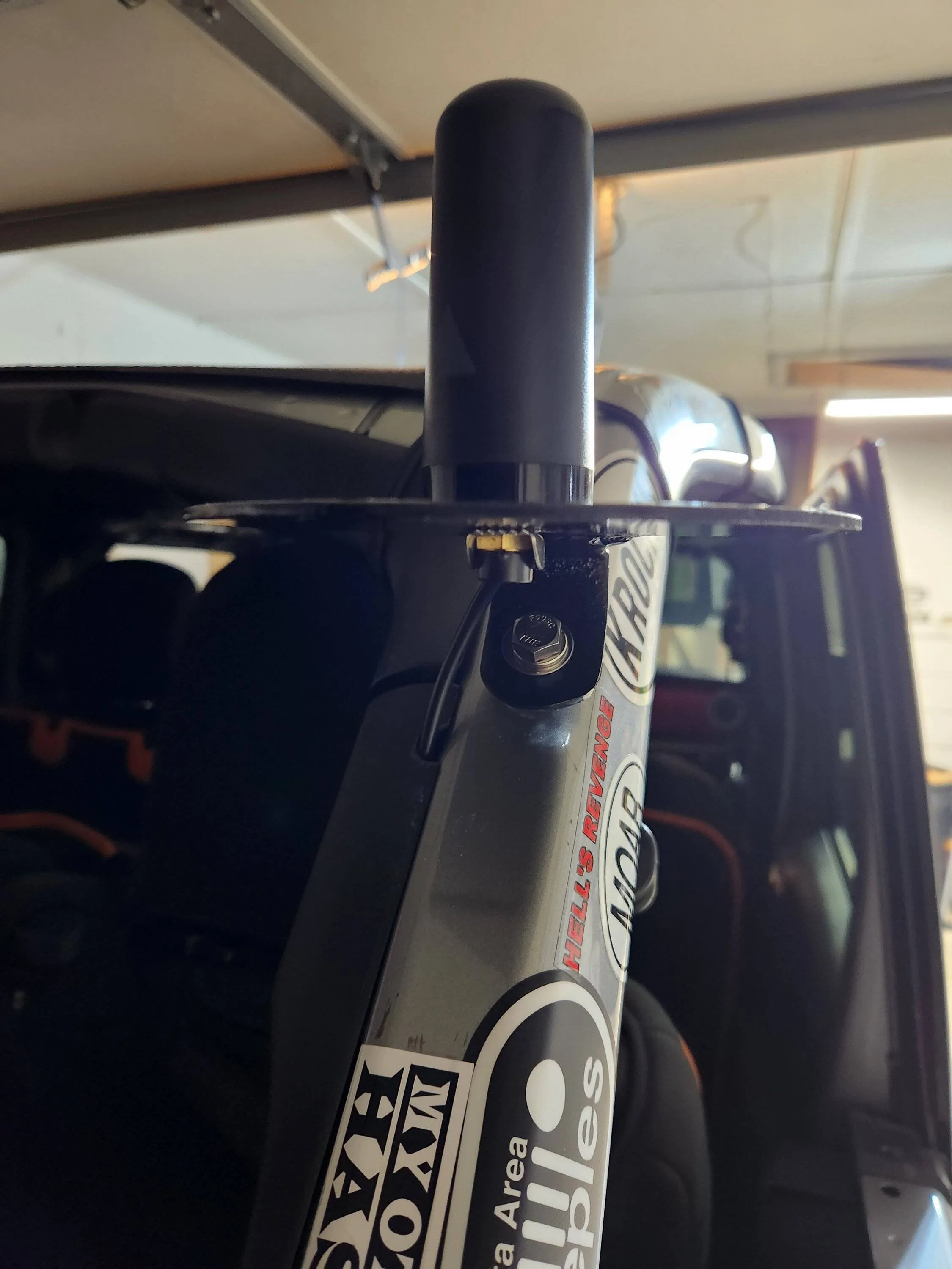

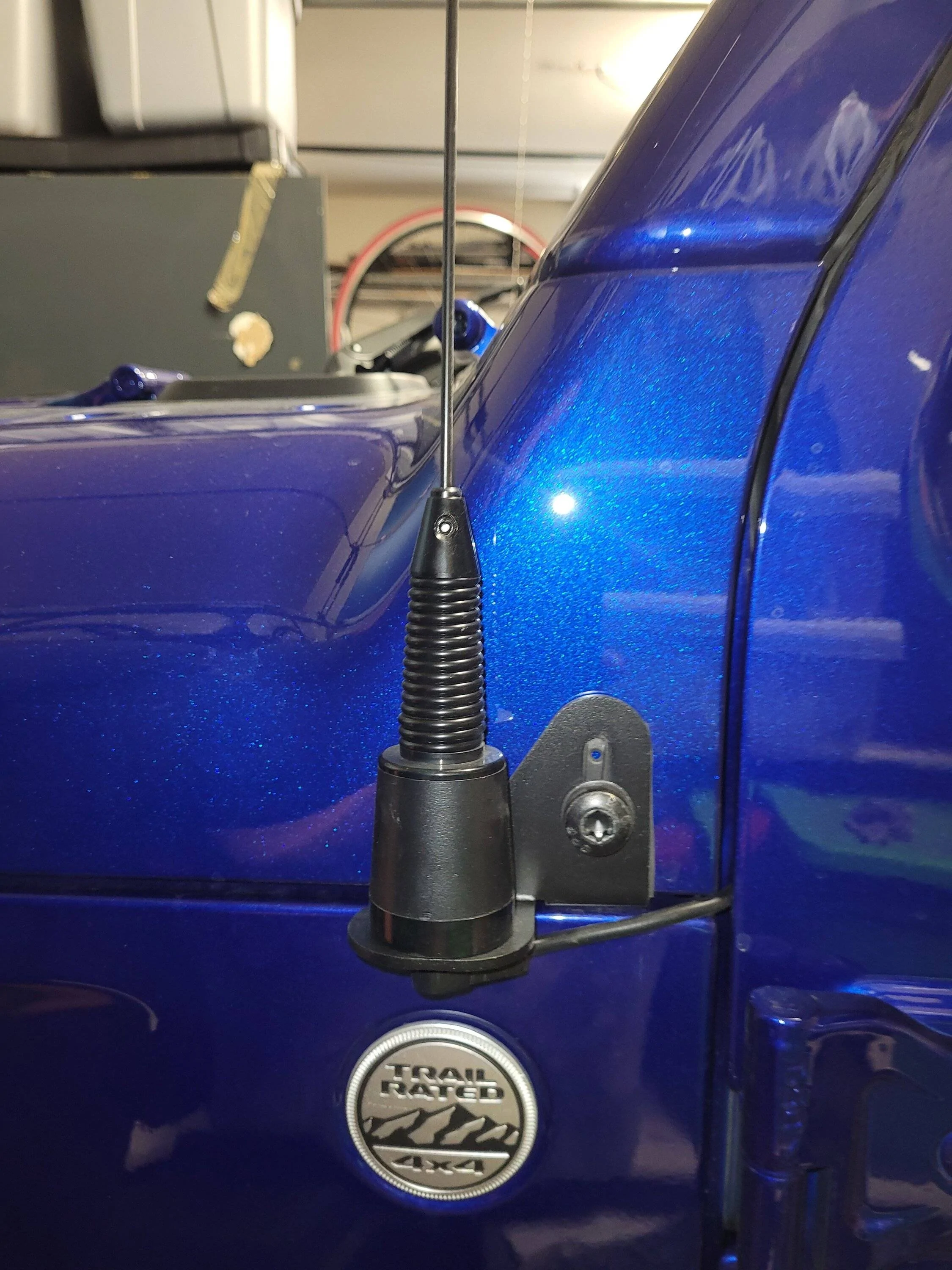

My MTX275 set up:
Jeep Wrangler JL CB radios 20210208_150437
Jeep Wrangler JL CB radios 20210208_150509
Jeep Wrangler JL CB radios 20210208_150541
Jeep Wrangler JL CB radios 20210208_150533
The 6db antenna mounted there perfectly matches the FM antenna on the other side. I have no problem hitting LOS repeaters out to about 40 miles - my swr is .05 to .07 through the whole gmrs band. The orientation of Jeep doesn't seem to matter at all - ie: having a ground plane or not. Radio checks come back 5x5 no matter which way I'm facing....

My MTX275 set up:
That's a nice antenna location. I've been struggling with the same. I was considering the next bolt forward of where you mounted or even a lip mount for under the hood.
