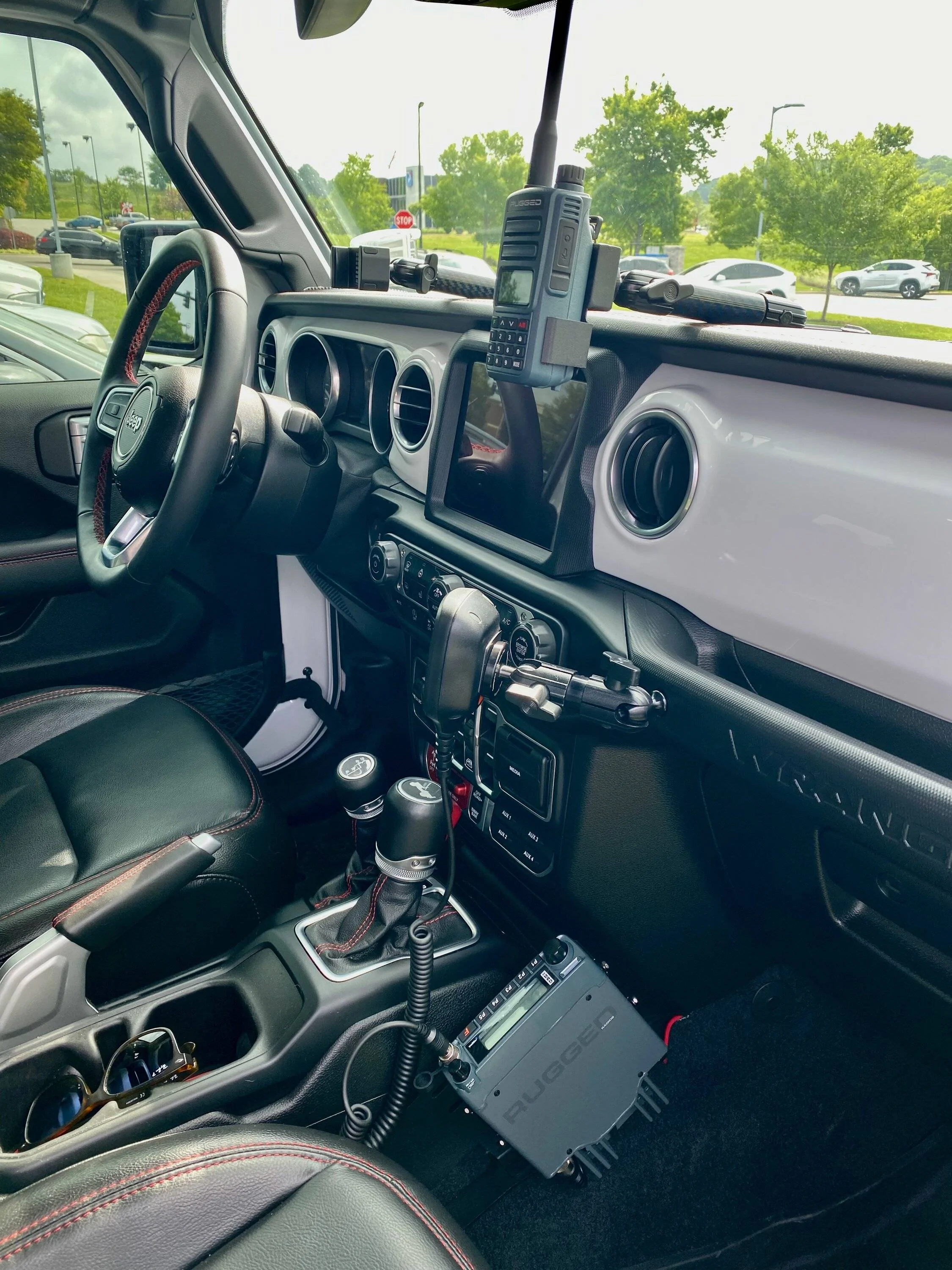

Like others have said GMRS is where its at. There are several good offerings from Midland, however, I prefer Rugged Radios but thats just me.
I use a Rugged Radios GMR45, and I use a Rugged Radios handheld for spotters.

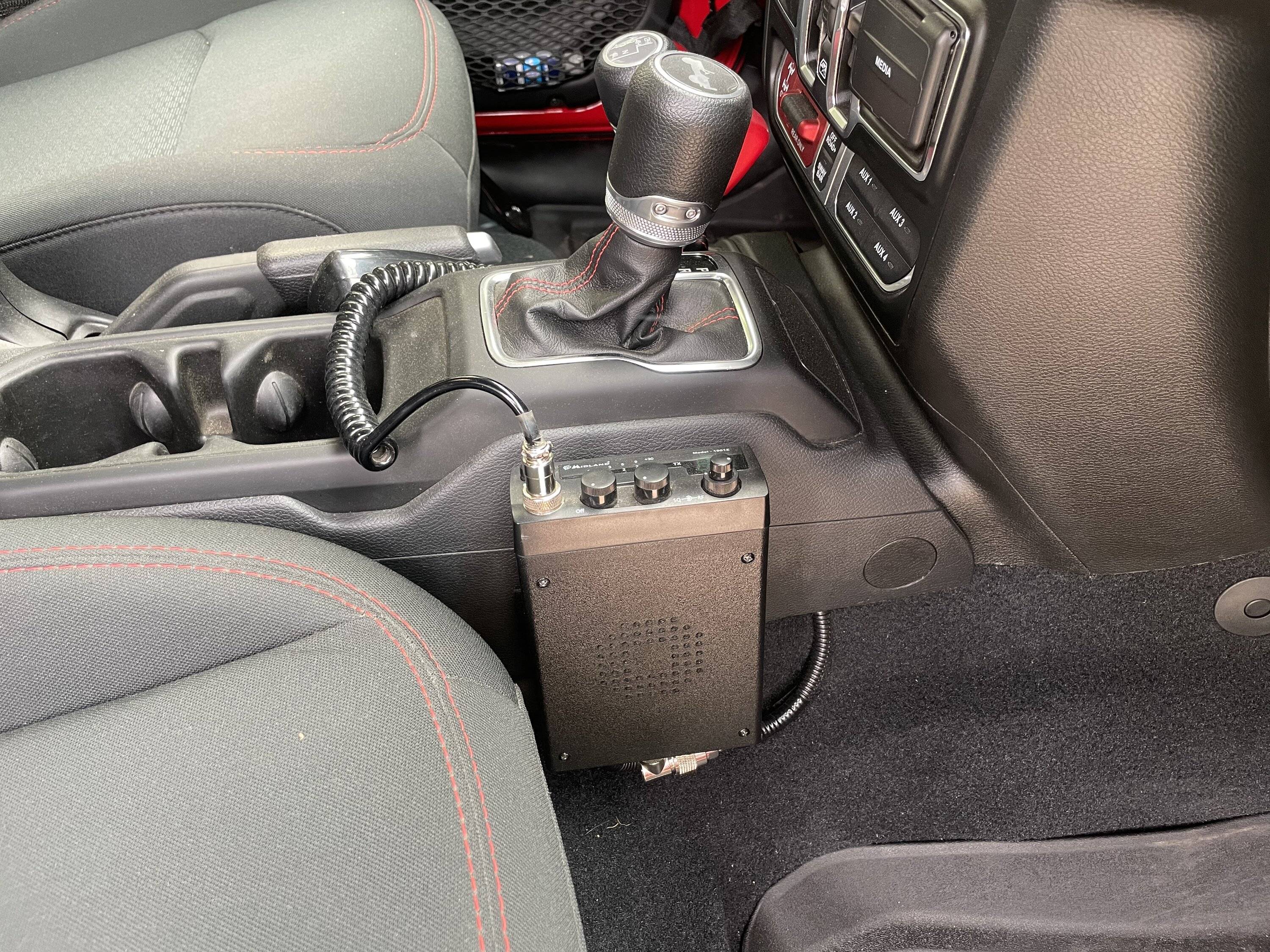

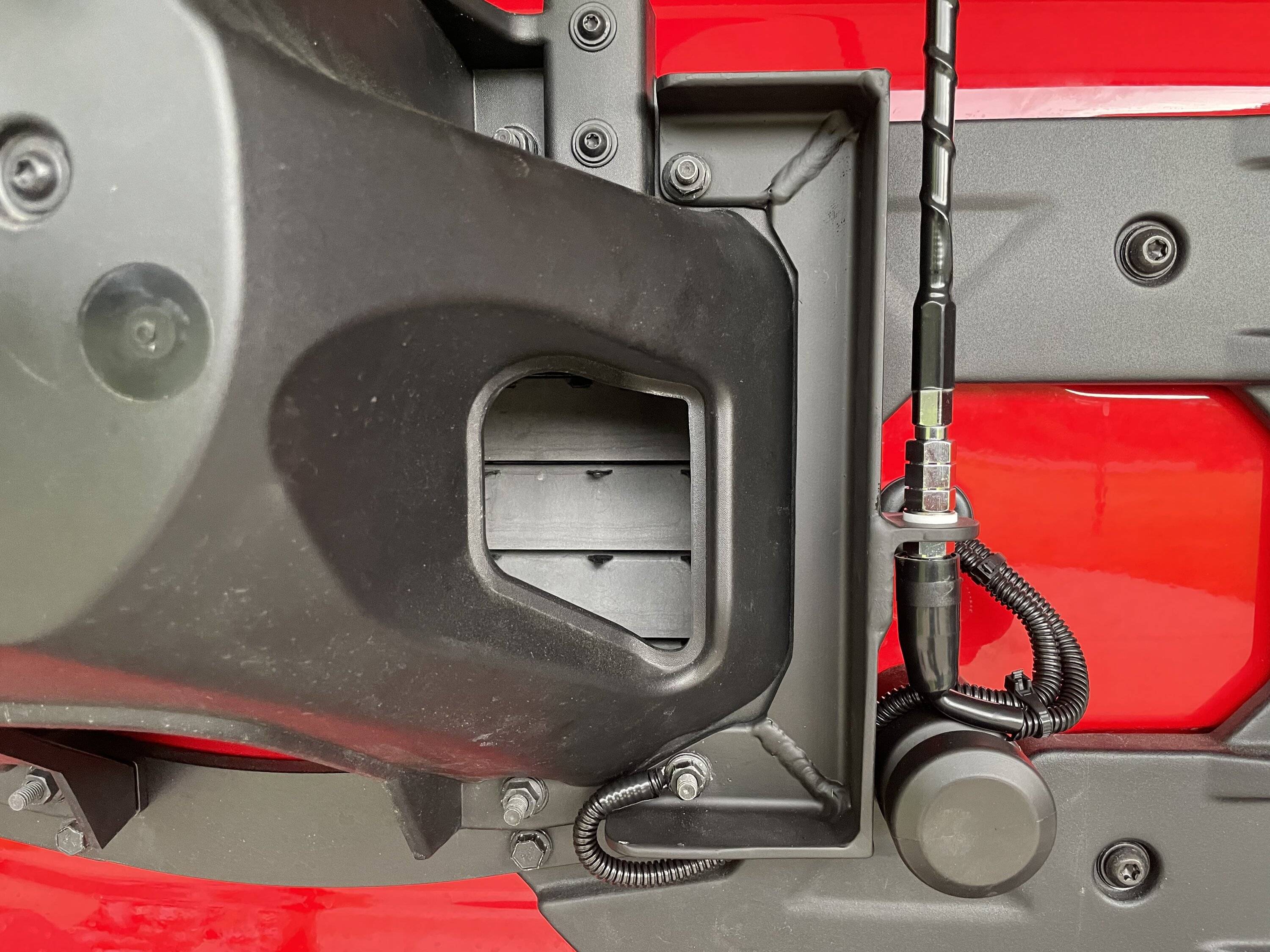

I’ve got a Midland 1001Z. I think they discontinued it for a newer model with a weather channel. CB works great with our small group and it’s handy even on the road as we always have two vehicles; me with the truck and camper and my wife following with the Jeep. I have it mounted with Velcro so no holes are drilled in the center console. And I made my own antenna bracket to use a 3 foot fiberglass antenna because I wanted it to go through a 7 foot garage door. Just couldn’t find a hood antenna solution that worked with the Mopar reinforced tire carrier. After several cardboard templates, I had the neighbor cut some aluminum and the local welding shop put it together for me.
