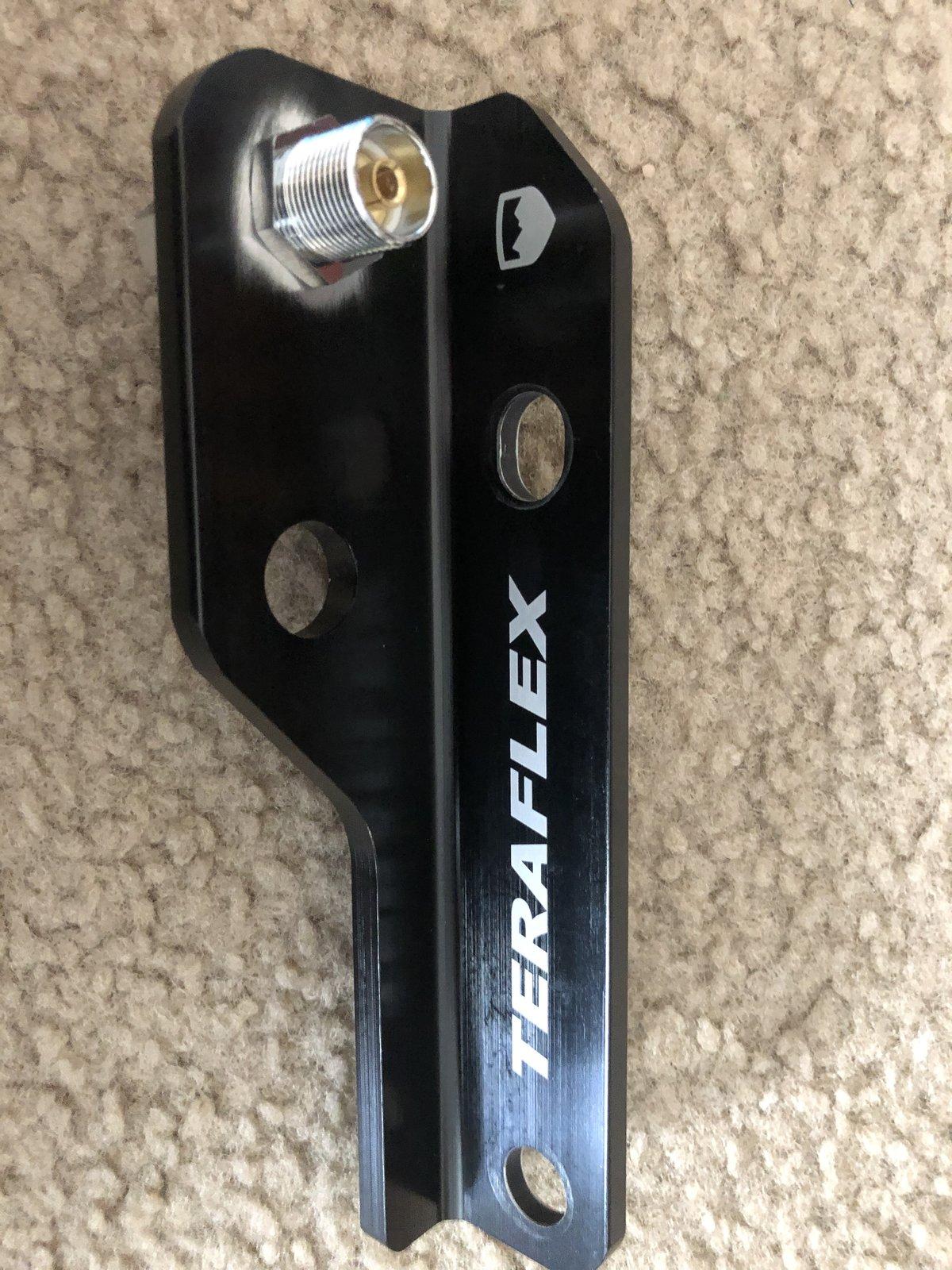

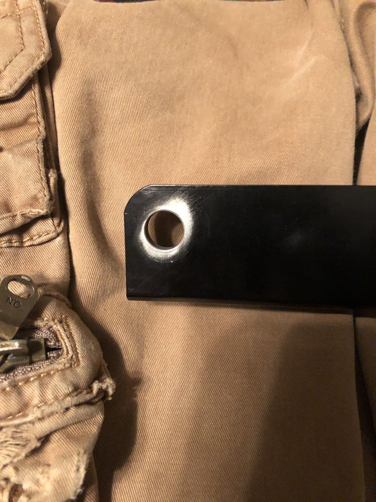

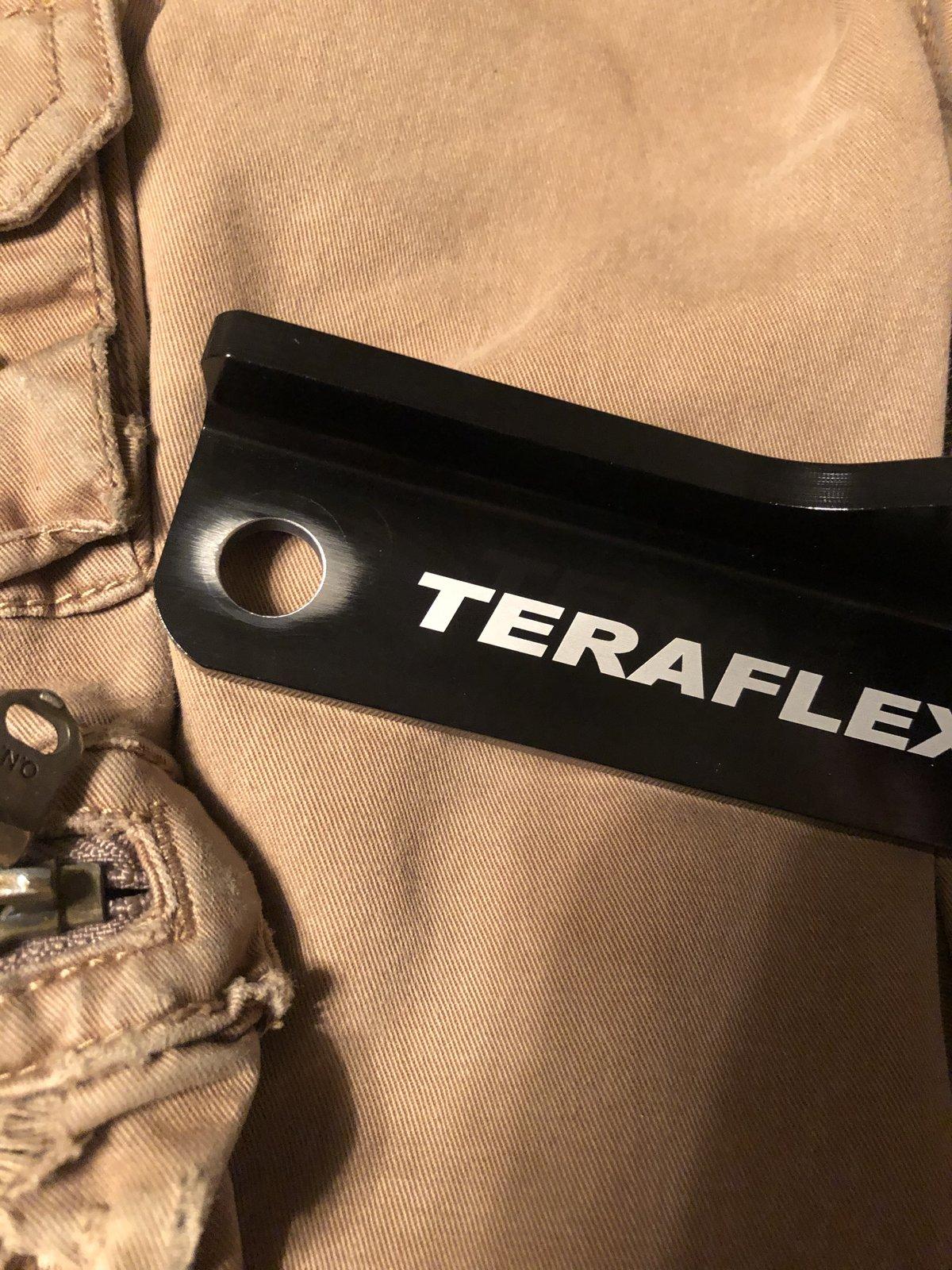

Just mounted my antenna. Used the Teraflex Mount. Not a bad mount. My SWRs are a bit high so I probably need to ground the antenna/mount. Now to figure out how to do that.

I was able to ground the antenna/mount and it seems to have done the trick. I ended up with a 1.0 swr on channel 1 and a 1.3 swr on channel 40. Super happy with it and glad I was able to make it work. Not sure if it’s much different from those NGP antennas but this seems to have done the trick.
