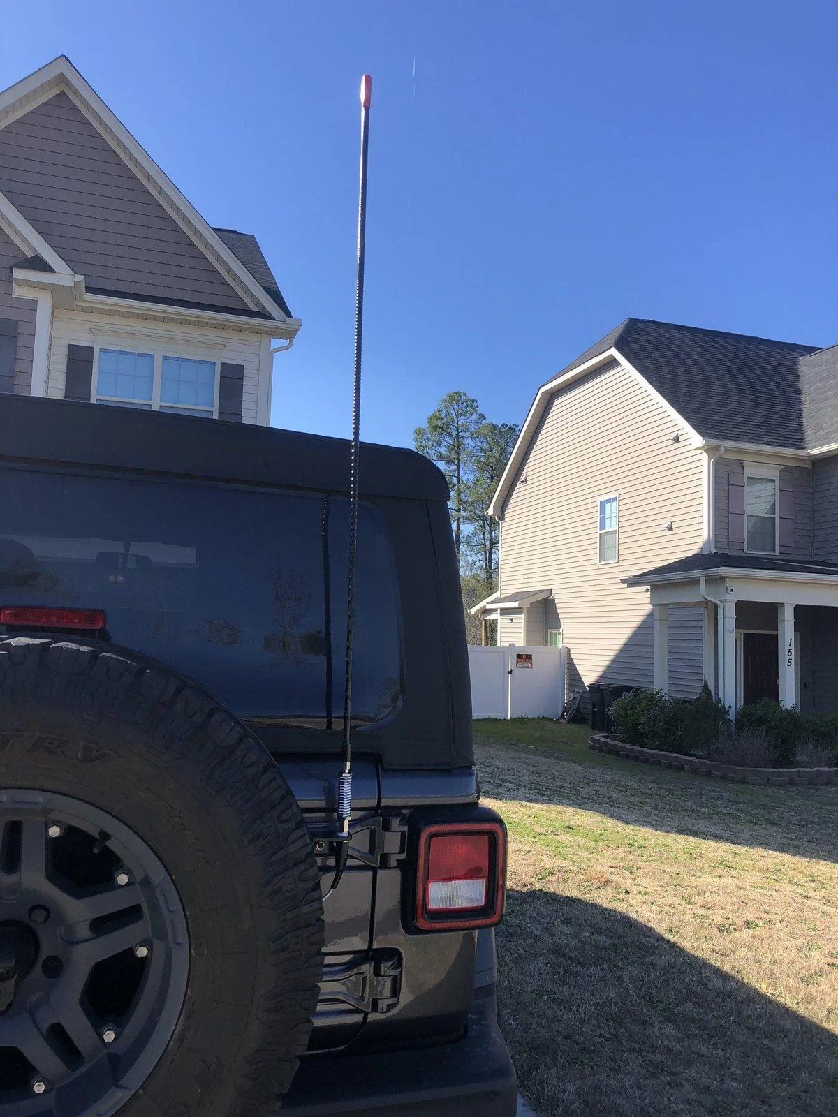

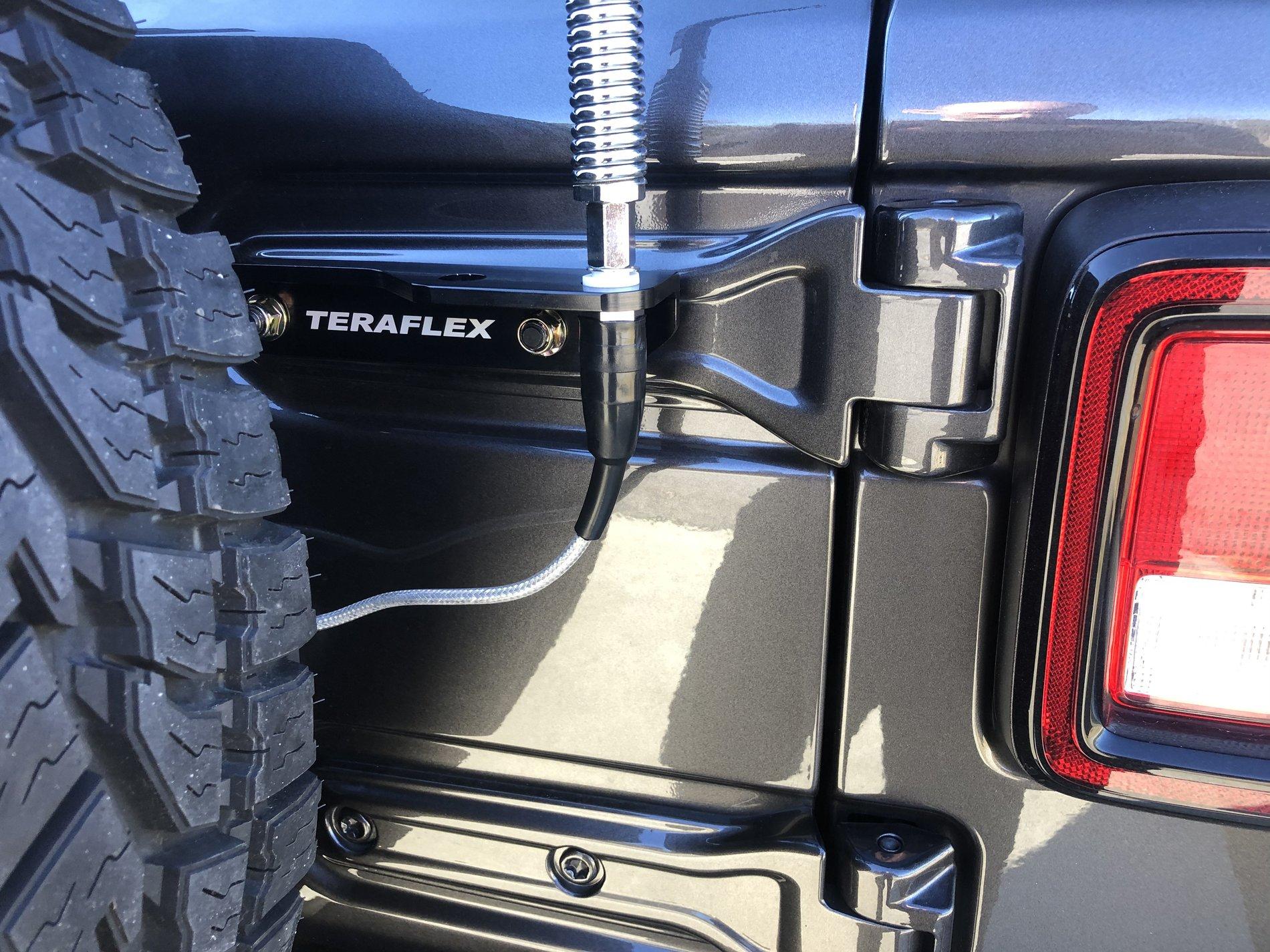

Just mounted my antenna. Used the Teraflex Mount. Not a bad mount. My SWRs are a bit high so I probably need to ground the antenna/mount. Now to figure out how to do that.
Exact Teraflex mount I bought. Did you figure out how to get a lower SWR? Did you have to run a separate grounding wire from the mount to somewhere on the body frame?
I was able to get low SWRs on the 4 foot Firestik 2 antenna. I just scratched off the paint underneath the mount holes so it would ground the antenna and lower the SWRs.
I recently installed a 2 foot firestik so I could leave it on and park it in my garage. That antenna was difficult to keep low SWRs on all 40 channels. I determined that the antenna must be a little short to allow low SWRs on all 40 so I picked a section and got the SWRs low. It works on all 40 but is high on certain channels so I’ll just avoid those.
I’m betting a 3 ft would work well but it’s too late now. My thought was to use a 3 ft and put the mount on the lower bracket of the tailgate. That would allow me to park it in the garage and keep the SWRs low on all 40 Ch. but I can’t take the 2 ft one back so for now, it works.

I have the same mount and also have high SWR readings. Almost 2 on ch 1 and 3 on ch 40 and I cannot shorten the antenna adjustment any further. I have a NGP antenna so it should not need a ground but I am thinking that may be the issue as you stated.

I went to a cb shop and he said my radio did not work well with the NGP antenna and coax. I bought another antenna and he set up as a ground type and it’s working well now.
