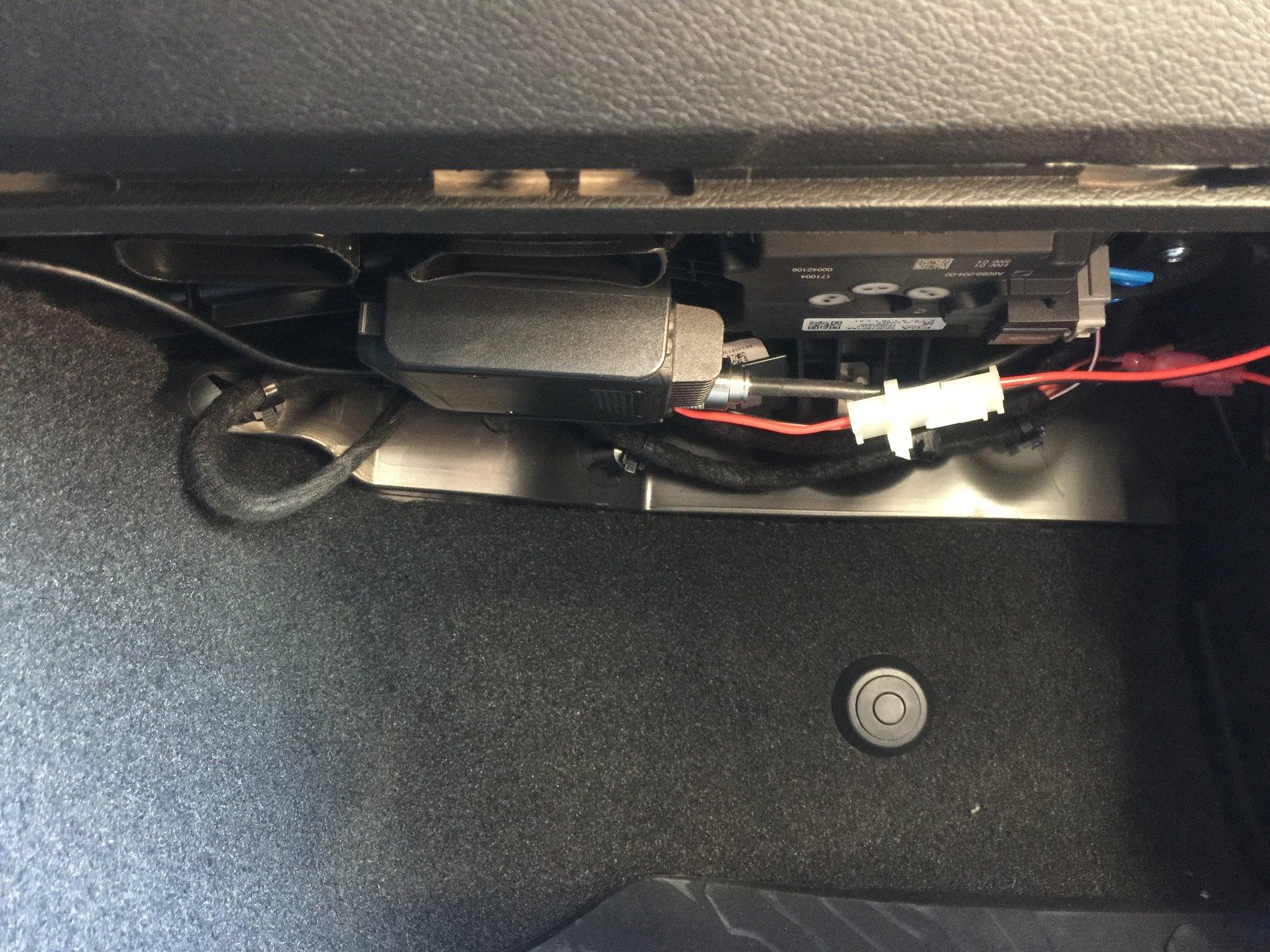

I found a screw tying down a cable for one side, the other side is zip tied to the air vent. Power and antenna cable to the right, microphone extension to the left.
I think that's where I'm going to go with mine. Was there a good place to ground it close by?
Refer to the top of this thread. There are pictures of an unused ground terminal in front of the door sill. That’s what I used.

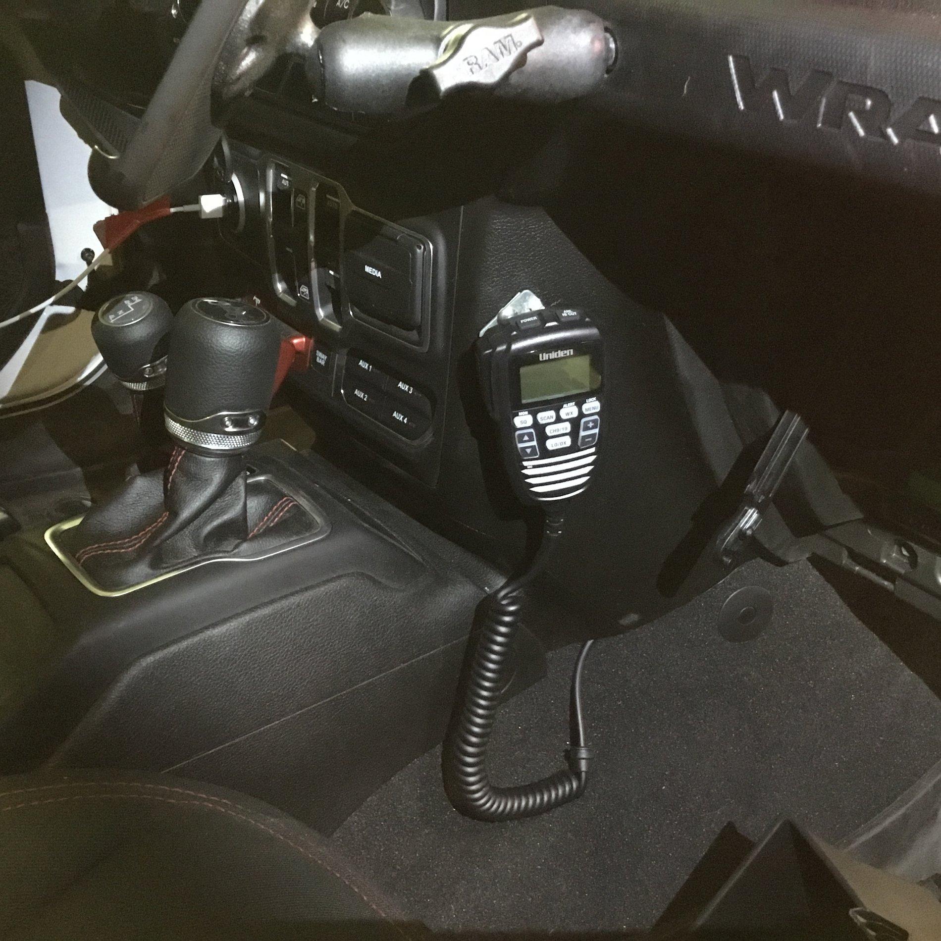

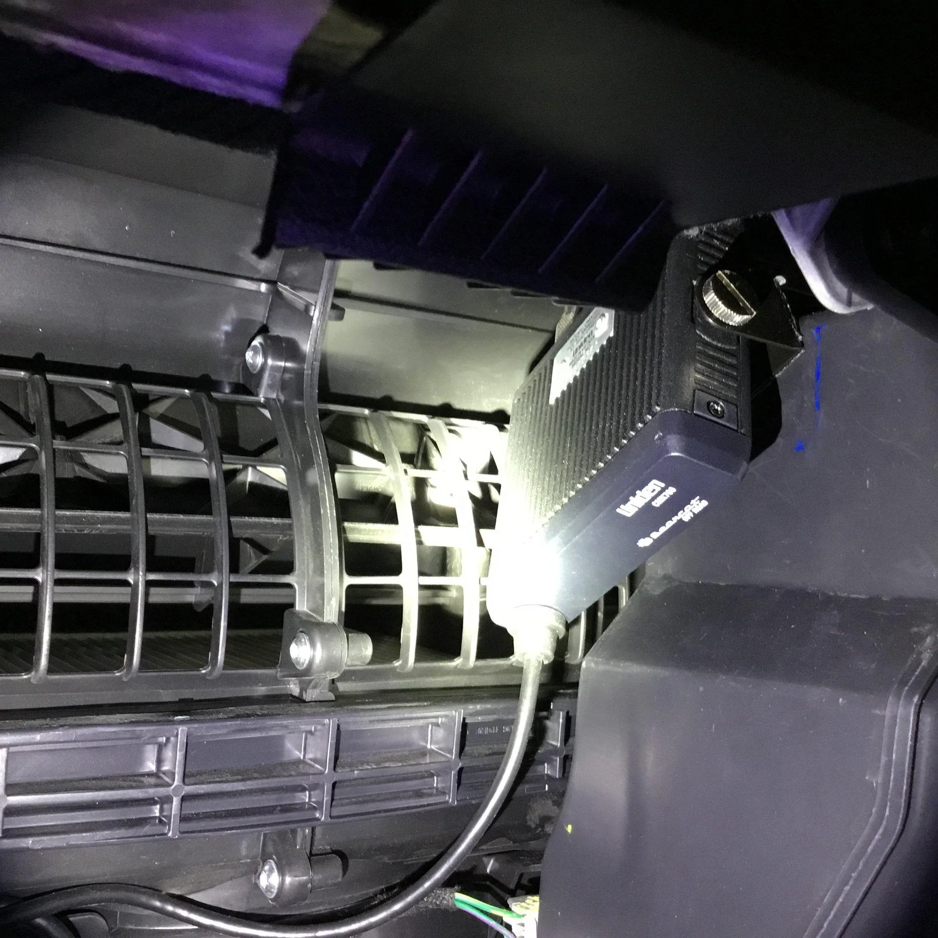

I posted this in another thread, but since it has been revived, I'll throw it on here.. I've got the Cooltech antenna mount with Firestick and a Uniden CMX760 CB. I've played around with it a bit and found the range to be pretty good...much better than my JK, which probably needs a CB tune.

mounted mine behind the glovebox
I like that! That's where I'm going to mount my GMRS microphone. I'll then put whichever mic, CB or GMRS, is in use on the front, and the other on the side, like that.

Its kinda hidden down low, don't use it much.
