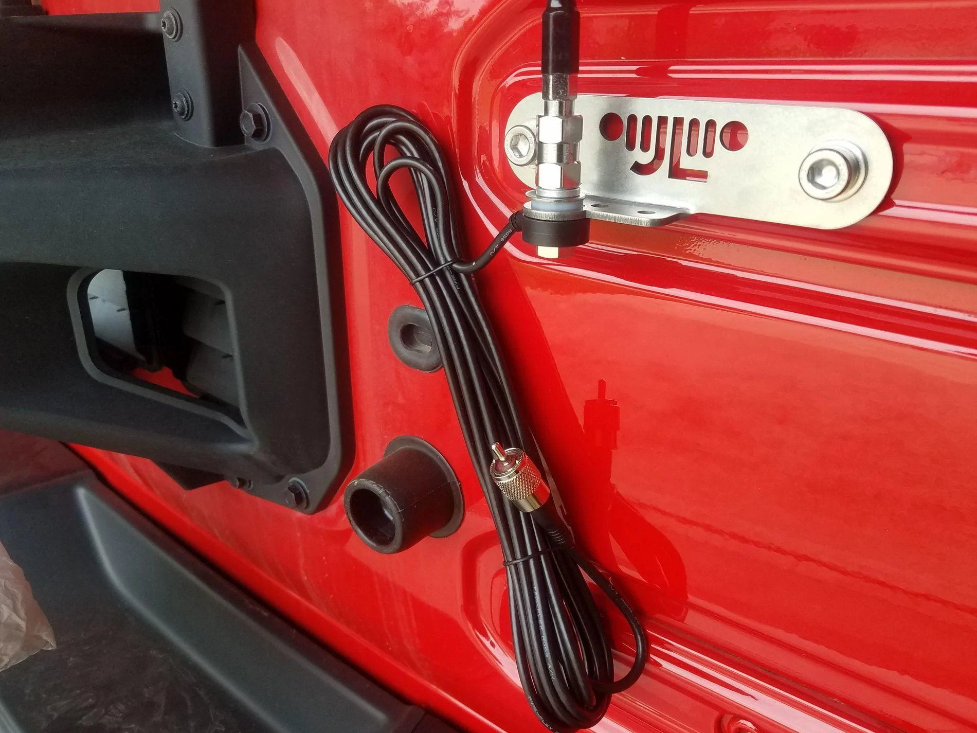

I posted this in another thread, but since it has been revived, I'll throw it on here.. I've got the Cooltech antenna mount with Firestick and a Uniden CMX760 CB. I've played around with it a bit and found the range to be pretty good...much better than my JK, which probably needs a CB tune.
Dan, did you scrape any paint off the tailgate for the CoolTech mount? I have terrible SWR / grounding issue. Not sure what to do. I can receive but not transmit further than 100 yards.

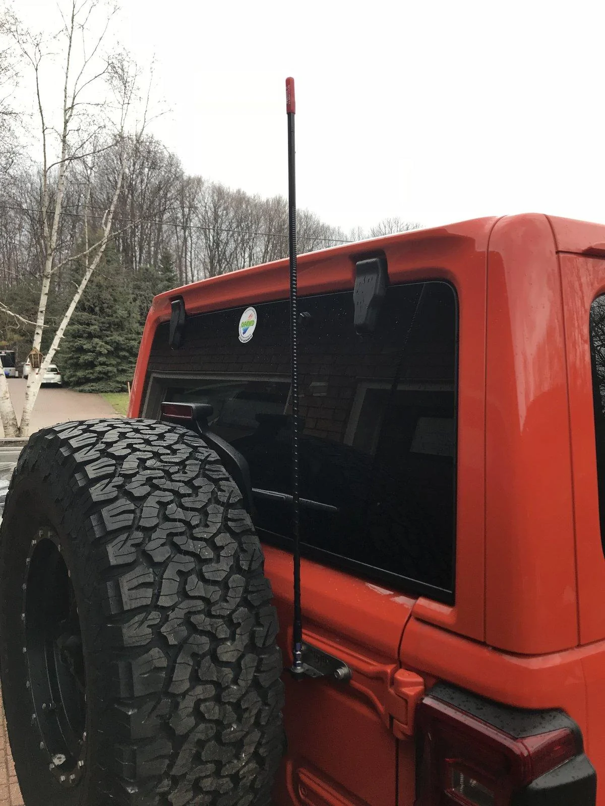

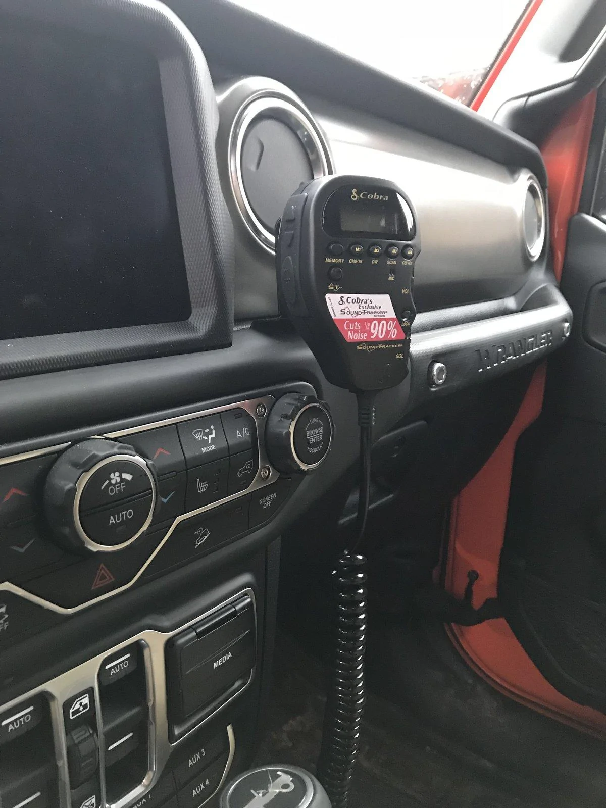

I just put in my cobra 75 with cool tech mic and antenna mount. Work out ok but I still need to tune my CB
Jeep Wrangler JL CB Radio Install IMG_0456
Jeep Wrangler JL CB Radio Install IMG_0457
No. I think the threads on the bolts make enough contact. You might look at a grounding wire. I'd probably start by calling Cooltech and see what they recommend. Even with a good ground, there really isn't an ideal location for an antenna on a Jeep, due to the soft top or fiberglass hard top.

Take grounds across your cooltech cable. Overall it's a good setup, but several folks on the forum including me have had bad cables despite being new. I was able to fix the ground myself in the end connector, but very frustrating. Good luck.

Fire stick lite. I just saw a good video by [Banned Site] using grounding cable on the tailgate door. I ordered on Amazon and will try that. Grounds directly to the frame and hinge bolt. He scraped off all the paint on the bolt as well.

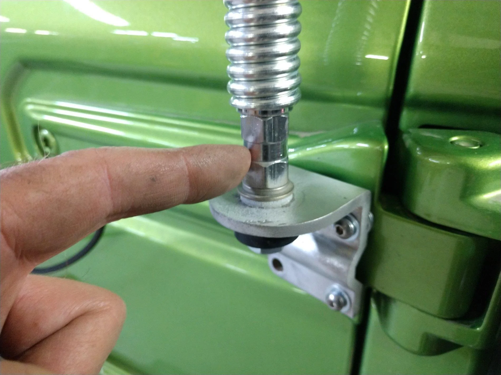

I hope this doesn't sidetrack OP's thread too much but when running the spring is it necessary to run this coupling nut?
The spring is threaded 3/8-24 female so it would be entirely possible to just run the bolt into the spring directly, I'm just not sure if this will affect radio performance
As long as your SWRs are in range you're good.

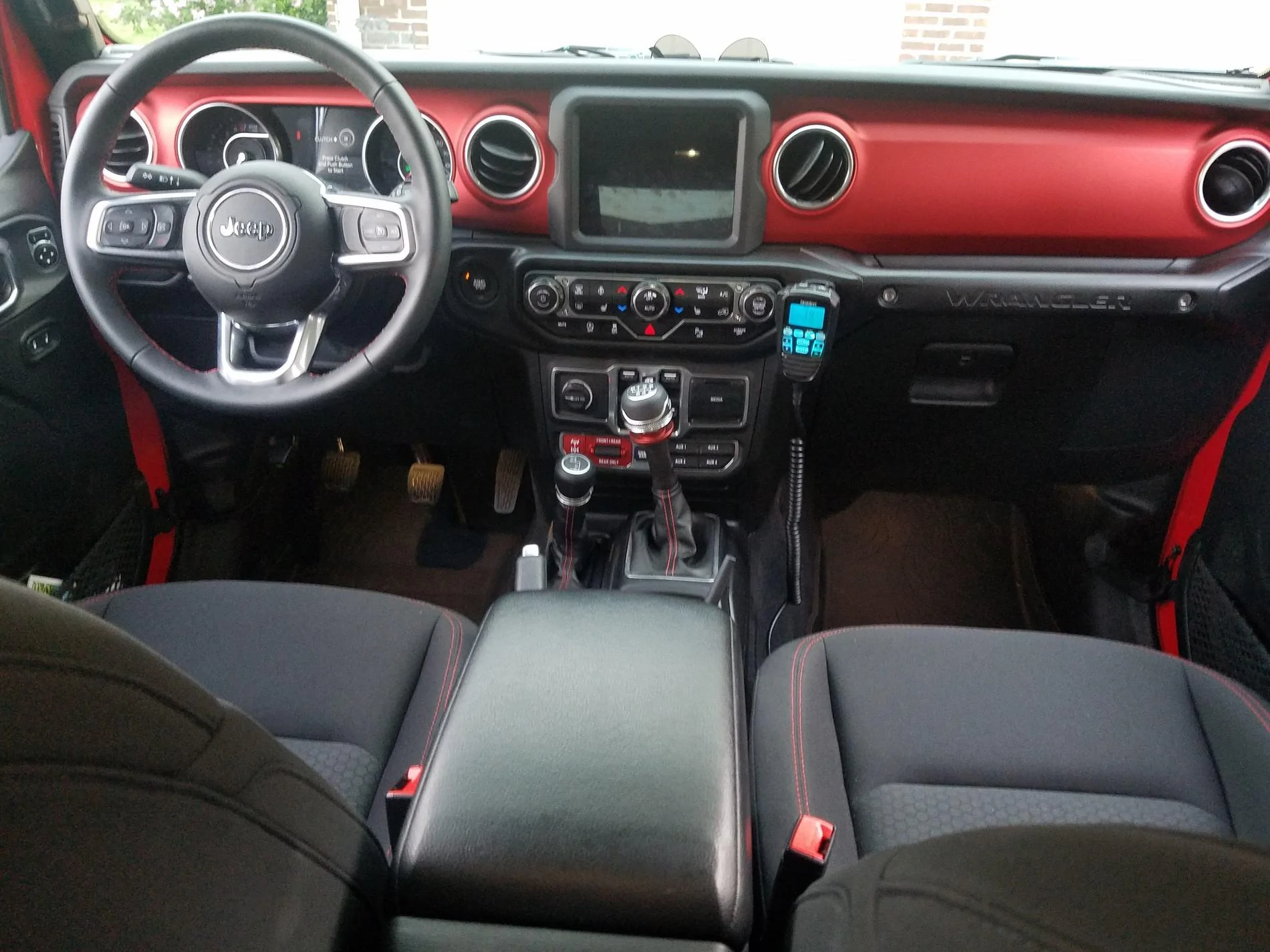

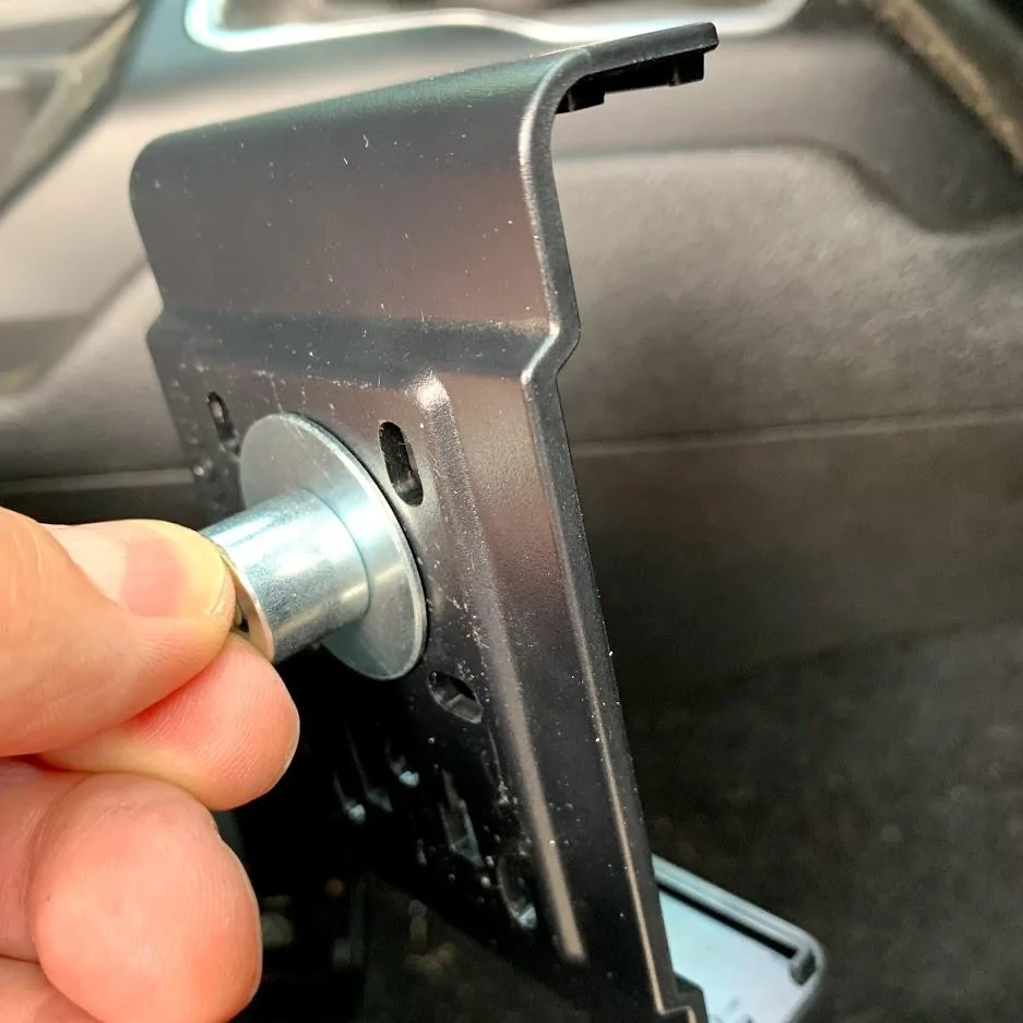

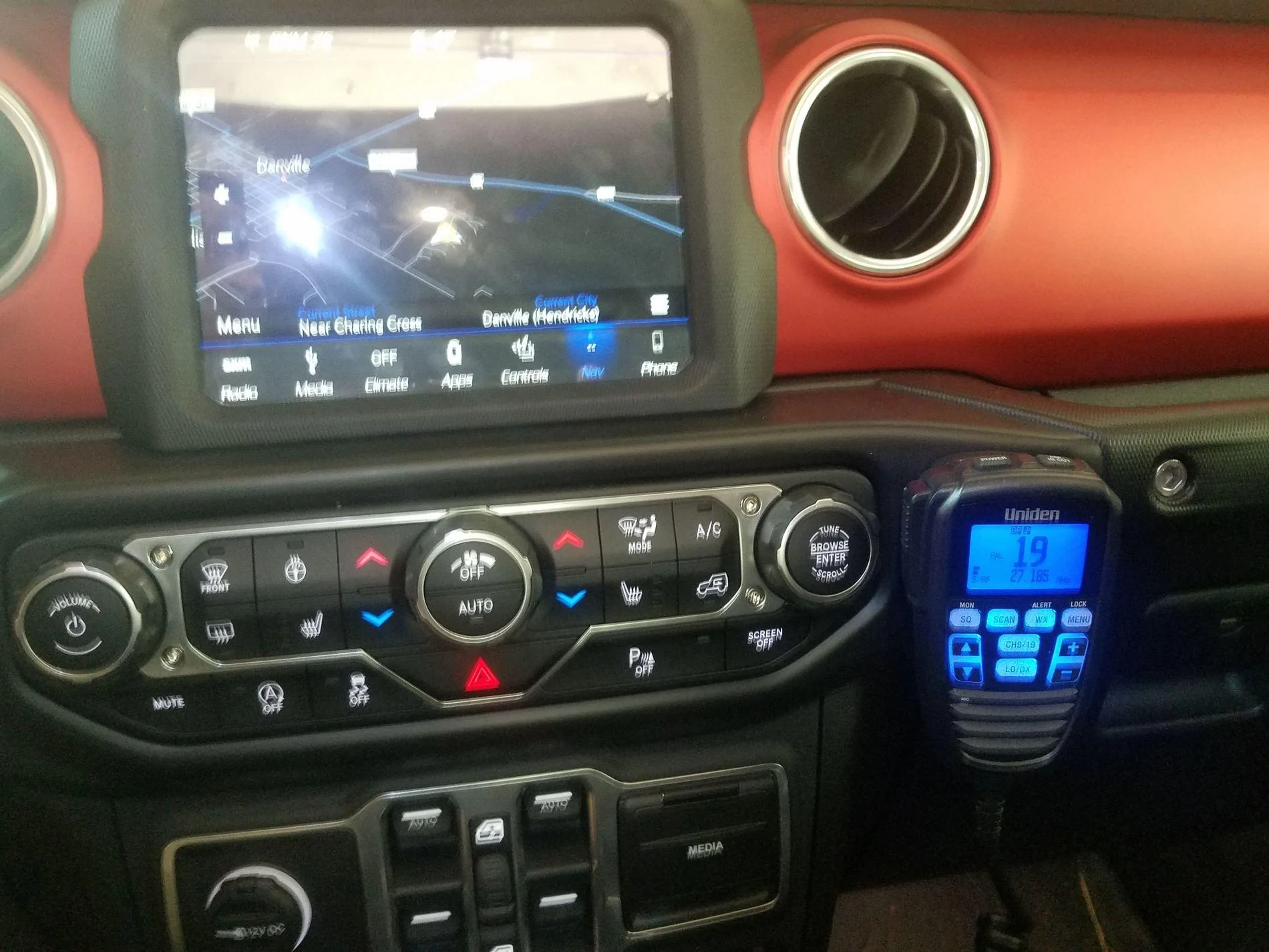

Here is another mounting option I have used for the Uniden radio. It would work for bigger units, too.
The middle console is anchored by a pair of pretty beefy M6 bolts, which may be used to hold the base unit in place:
Jeep Wrangler JL CB Radio Install bPuelYIyHk3kpccLG7Uiuk8LbduPfjrDovkF1Pn_hrggNvEymRyJkdw6O56YHXaPYBn4M5yejg-NBdrzCmcX8sK1=s937-no
I replaced the stock M6 x 30mm bolt by an M6 x 40mm version, and added a spacer and washers to hold the slide-in frame in place.
Jeep Wrangler JL CB Radio Install haI3OHtQlcxP7HqjQGK4g4QFjsTr4gIayfGJzlKyAv2sVwtlwHM57mlmfRgVHxqt9-da0NBz-d9-m1ARe6W7FIha=s937
Jeep Wrangler JL CB Radio Install um45Kbk3eKEfLFtbpvLA0we-ek3I1btS_z0hSQ2KTe98dIY0xeW4GonS_wfGDzZ2pjIxGiqxws5pqTkiGSpzRqZL=s937-no
this setup allows me to quickly remove and stow the radio (e.g. when parking doorless).
