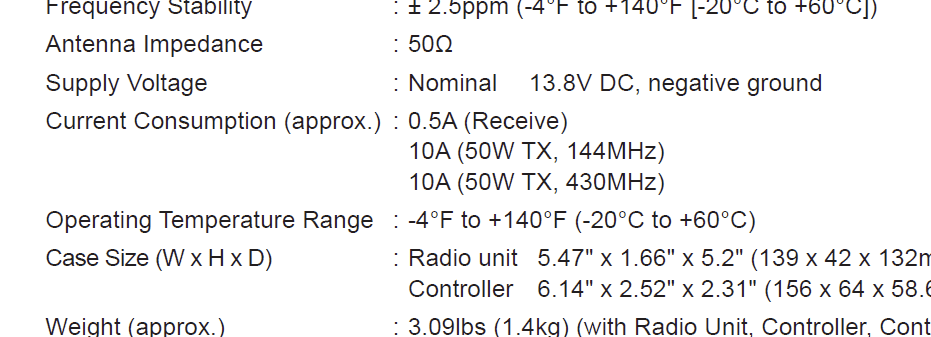

Assuming 100% efficiency, and radios are never [perfectly] efficient. You'll find that most 50-watt VHF/UHF radios draw about ten amps when transmitting at full power.

No need to doubt it. Just measure the actual draw, or check the manual for the radio. Here's the relevant info from the Yaesu FTM-500DR manual, for example:
Jeep Wrangler JL CB RADIO QUESTION 1694531882821
I'd use 12 gauge to supply the radio. If you end up using 10 or 8 gauge, it'll be great -- but you'll have problems finding connectors that accommodate such large wire sizes and fit the radio.

BTDT; never seen double the calculated draw IRL.
