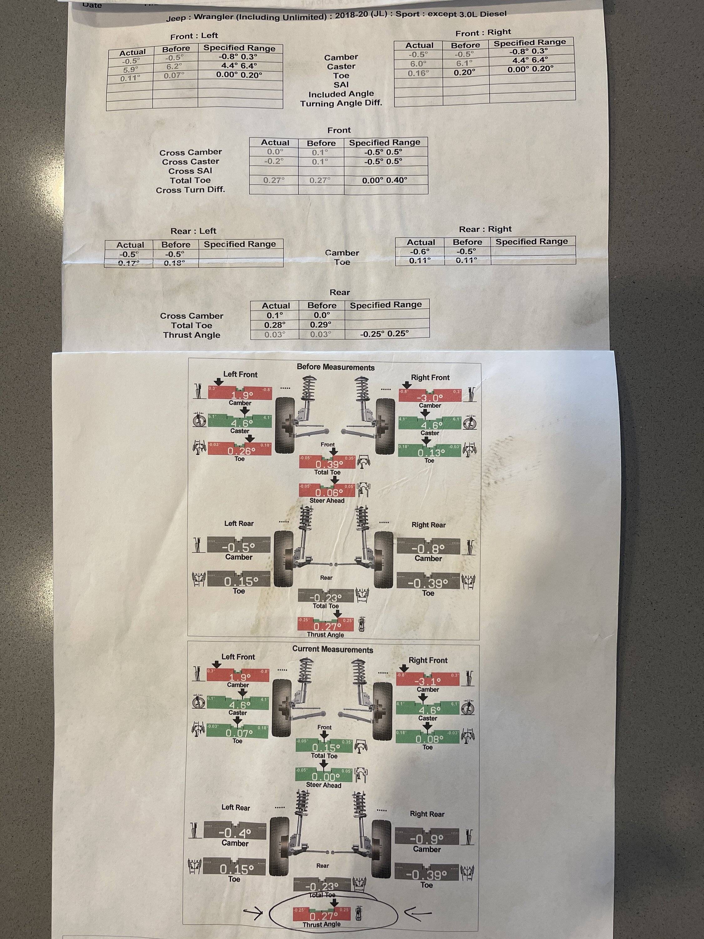

Camber or Thrust angle causing pull?

You should be able to see -3.1 degrees of camber... it should be pretty obvious when comparing to the angle of the rear. If it's not obvious, I'd get the alignment checked again (somewhere else). I question the rear camber measurements also...
Jeez, this made me pull my first alignment to compare. Looks like it was a completely different reading. Ughhhh
