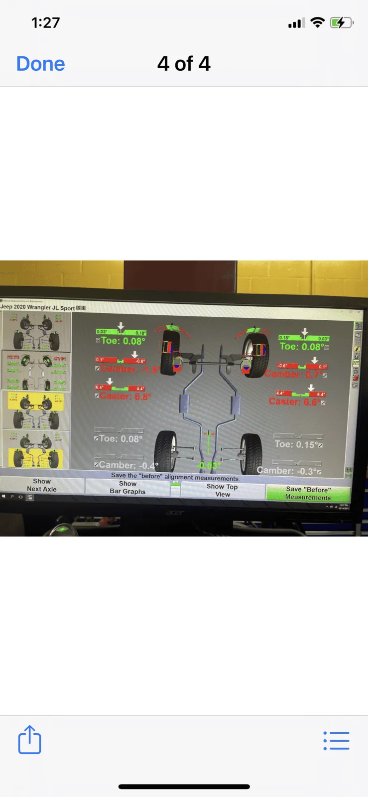

hey i have lcas from the mopar lift. Is that good or you mean front control arms by the tire? And what did you get ? And do you remember what it was before and after with caster? This is me after an alignment
Jeep Wrangler JL Camber off, pull to left -- NEED HELP! 1CD03E56-37CA-46C2-9DC7-524B3738FD01

If Camber concerns are raised after an alignment shop performs the measurements, you should ascertain if the tires were determined to be equally inflated just before the measurements were observed.
Camber measurements assume the tires are nearly identical and the axle is parallel to the test reference. If the tires are not inflated equally and closely matched in size, including deflection characteristics, the camber measurements will not accurately describe the relationship between the hub and the axle.
Good luck!
Hey yes a plug when into each tire to ensure the psi was the same.

If you are explaining that they used some sort of pressure balance line to equalize the pressure I would offer the suggestion that, in my experience, the expectation that the pressure will actually equalize has been met with disappointment. The equalizing hoses work "theoretically" but in practice, you should probably trust but verify with a reliable gauge.
I use equalizing hose assemblies frequently, but rely on a traditional, consistently accurate, one at a time tire pressure gauge when I want to balance the tire pressures on my vehicles.
Having said that, you have a list of possibilities to consider. You can start with the hard stuff or the easy stuff or hunt and peck.
In order from easy to hard:
  1. Equalize tire pressure
  2. Assure that you do not have some sort of unique payload in the vehicle that is causing a temporary state where one tire is deflecting more than the others.
  3. Confirm measurement accuracy/repeatability - THIS IS A OFTEN OVERLOOKED YET IMPORTANT CONSIDERATION.
  4. Confirm that tires are equal in size, shape, tread wear etc. Does swapping tires side to side change the camber measurement?
  5. Remove the steering knuckle and inspect/replace Ball Joints
  6. Disassemble and inspect axle for misaligned fitment of the end forgings
Another thing to keep in mind is that extended Scrub Radius and or relaxed Caster will affect camber when the wheels are turned, which would not seem to apply to an alignment measurement, but these factors are related to the Toe settings in the same manner that they relate to purposeful steering.
This can be a reason why when minor toe adjustments are made, the camber, which is presumably non adjustable, may seem to have been altered by some small increment.
Your toe settings seem to be normal so this would not apply to your circumstance, but the relationship is worth keeping in mind if you are working with a situation where toe settings are significantly out of bounds.
