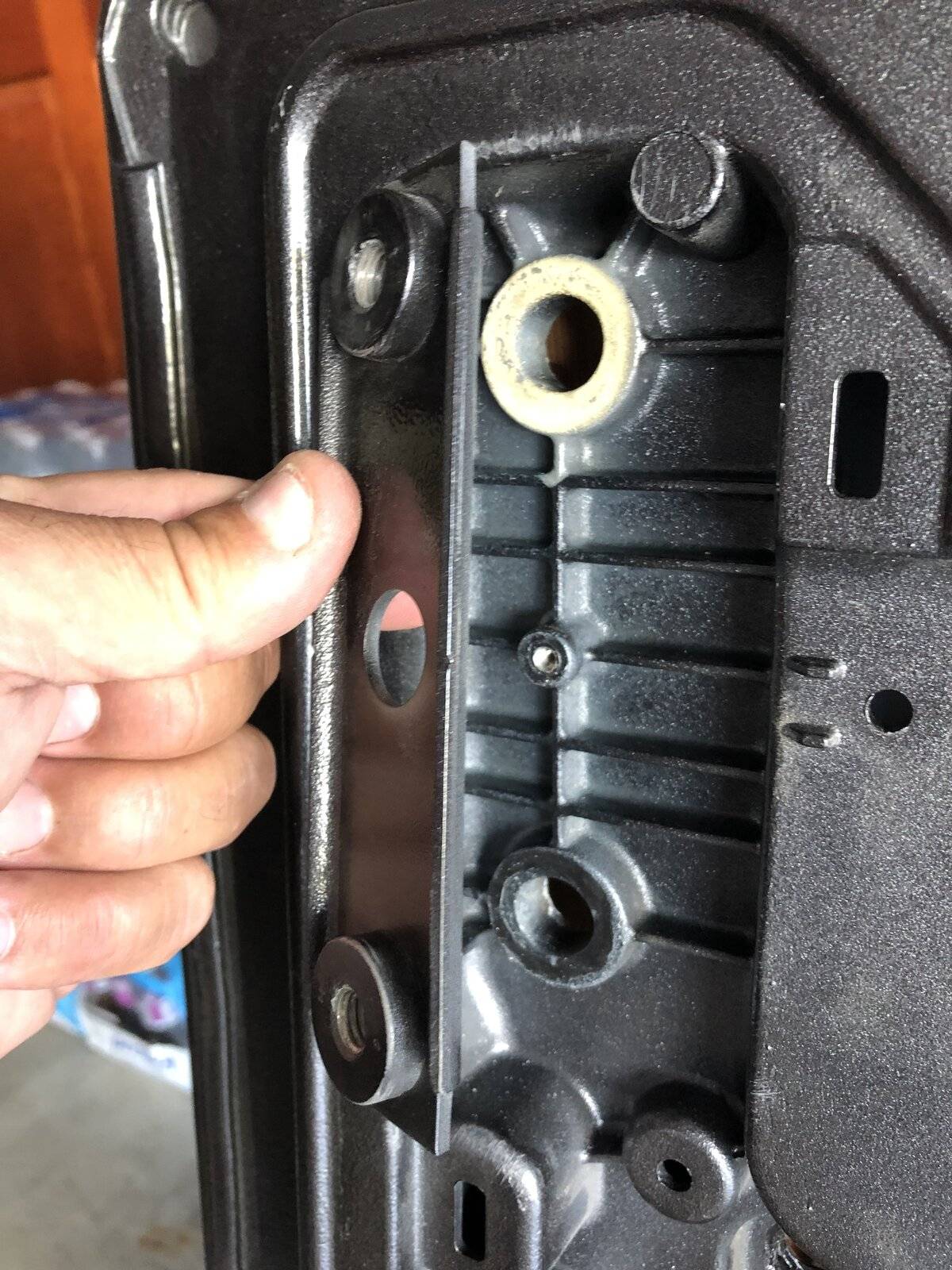

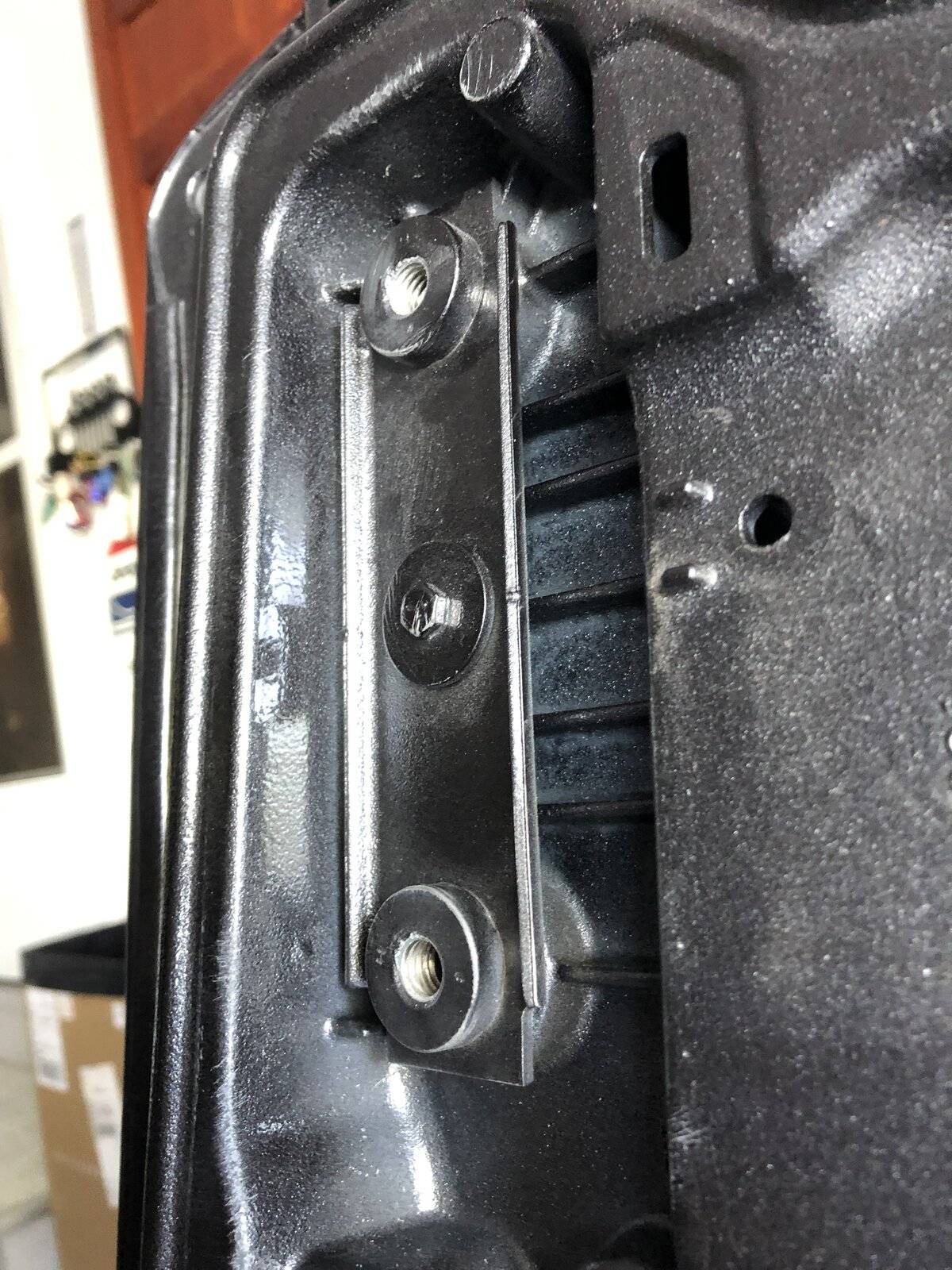

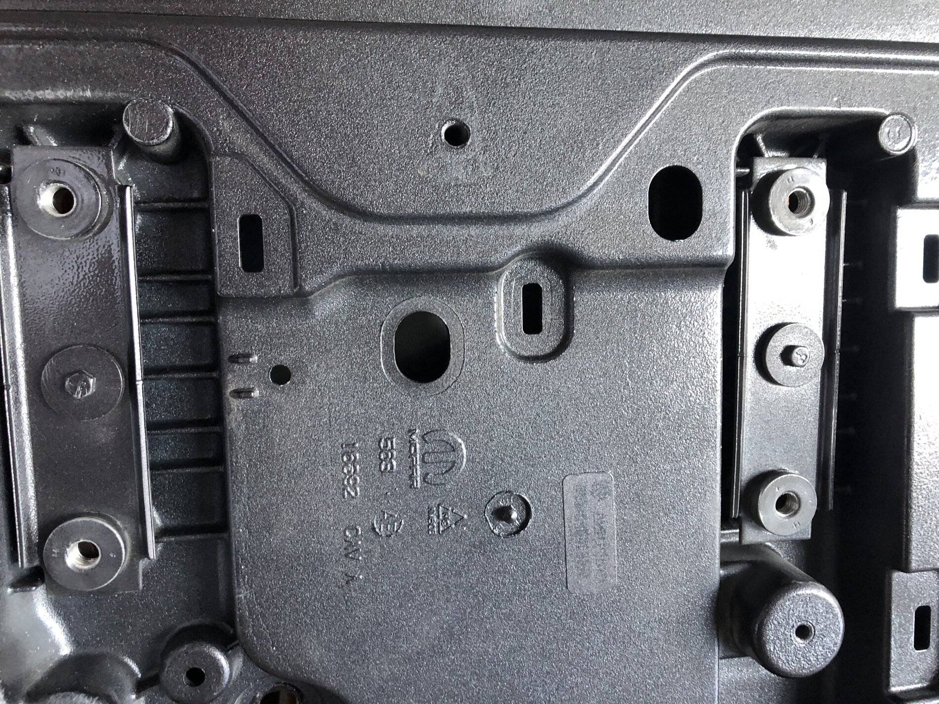

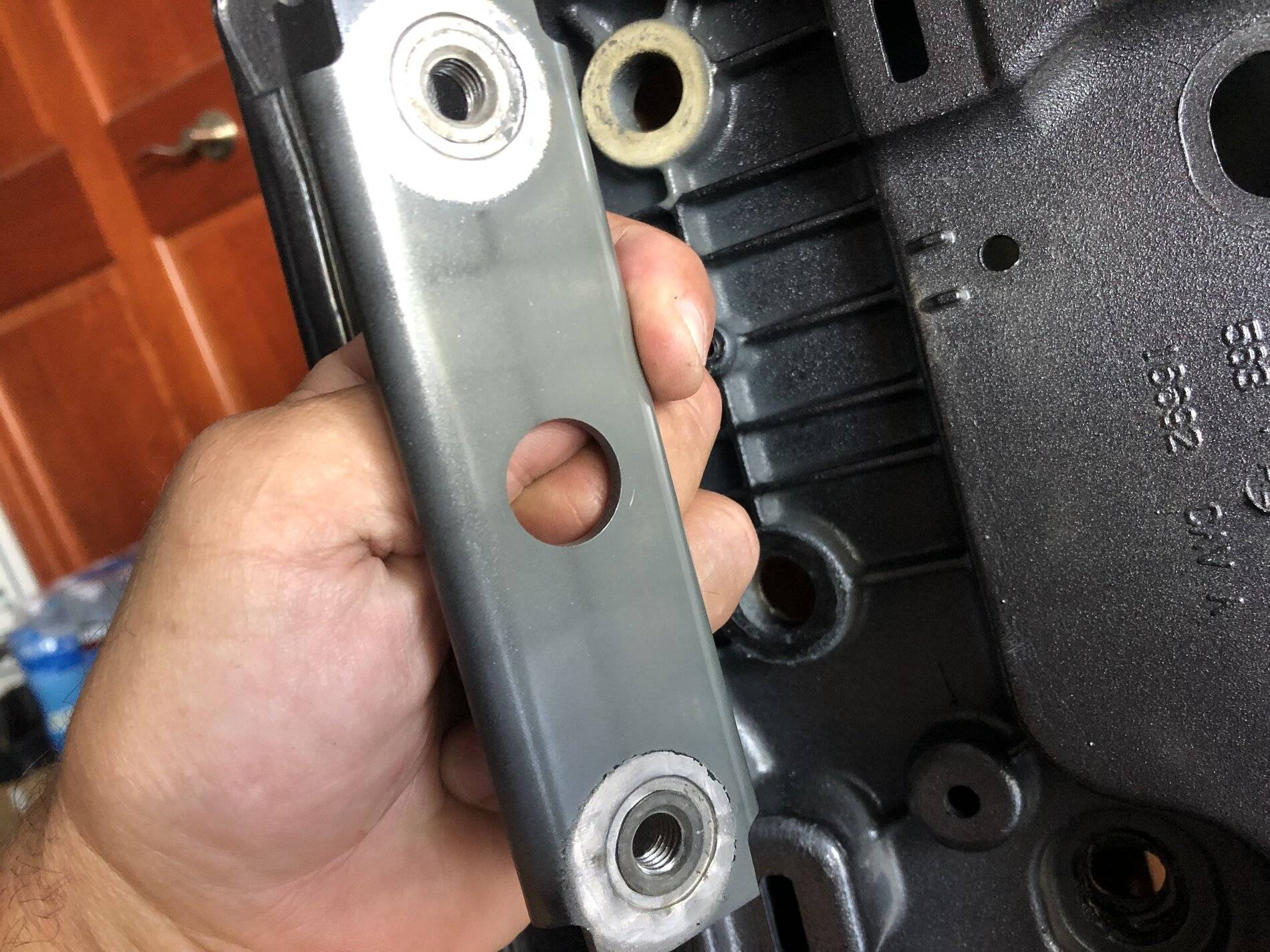

Nut plate is held to back of gate but allowed to “float for alignment .

Thanks Bryan
The nut seems to made out of steel, is the plate made out of aluminium or steel?
