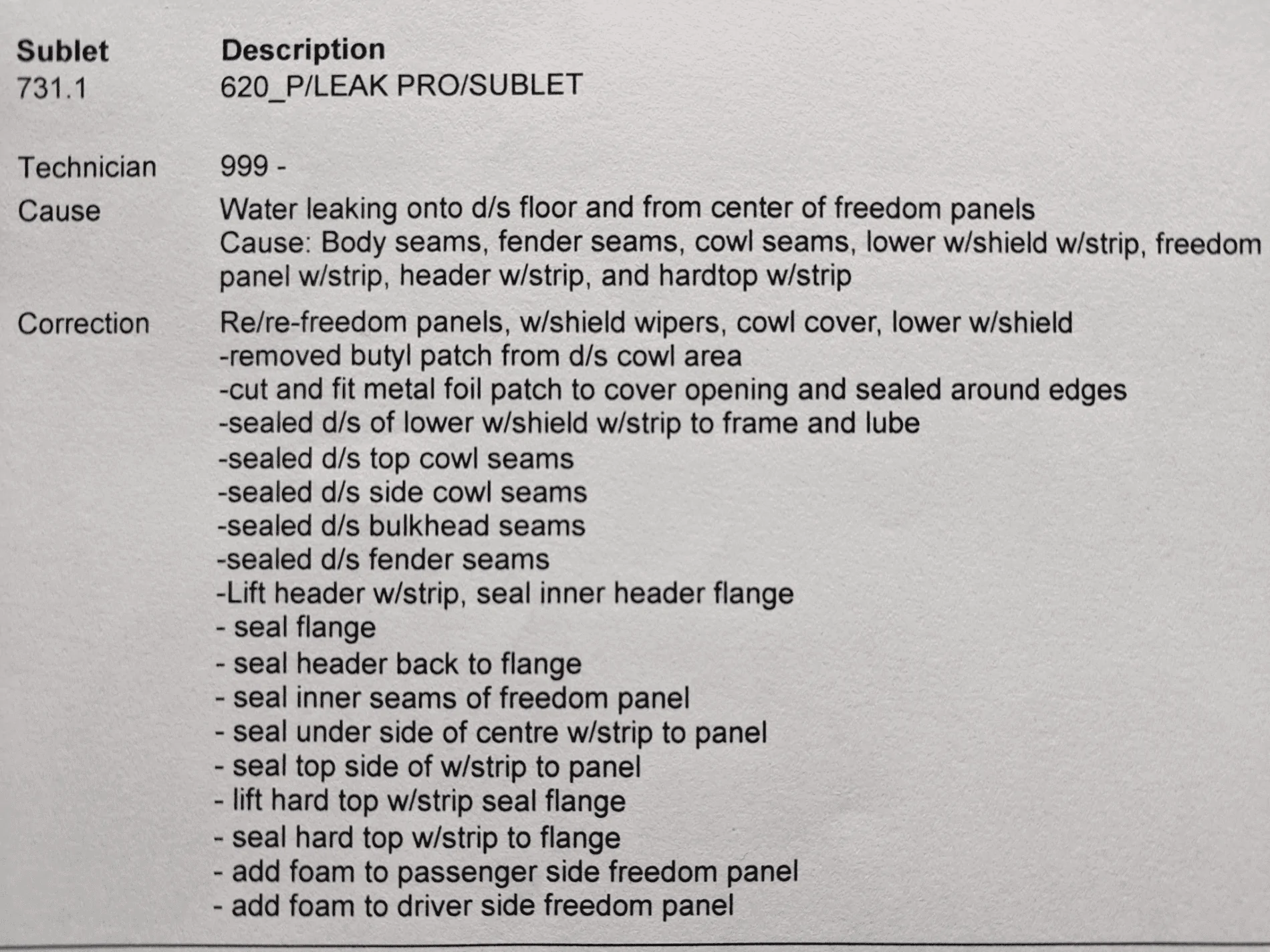

What was the leaking water issue??
Completely flooded driver footwell. Also footwell behind driver. Small amount under footwell behind passenger. Passenger footwell dry. Small drips from freedom top hitting center armrest storage bin. Everything corrected but you have to dry out for about a week with carpets all left lifted otherwise pan will stay saturated. Positive is pan looks to have a clear rock solid epoxy type sealer over the metal.
Is very hard to know for sure unless you actually lift the carpet. As can feel completely dry on top but is still fully saturated below. Is a very extensive list as shown. So get a leak specialist vs some random FCA tech. Is a very common problem on the JK. Someone we know asked me if the JL also had this problem as she wants to sell her JK to get rid of this problem. She has massive footwell flooding every time it rains. Unfortunately I had to tell her. Youtube has a bunch of vids on this as well.

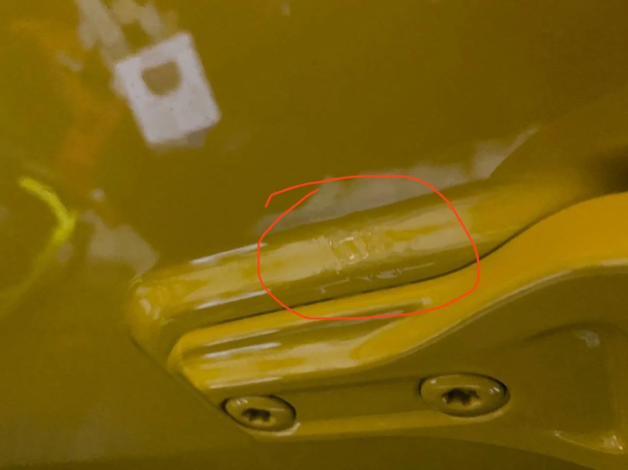

I think i will try to go check some used JLs out at car lots and check the hinges. I will also try to check JLs i come across in parking lots. Some of these bubbles in this thread would be easy to notice as casually walk by.
Is this something that is happening to 100% of the JL population?? Has anyone owned a JL for a couple years that does not have the bubbles on the hinges??

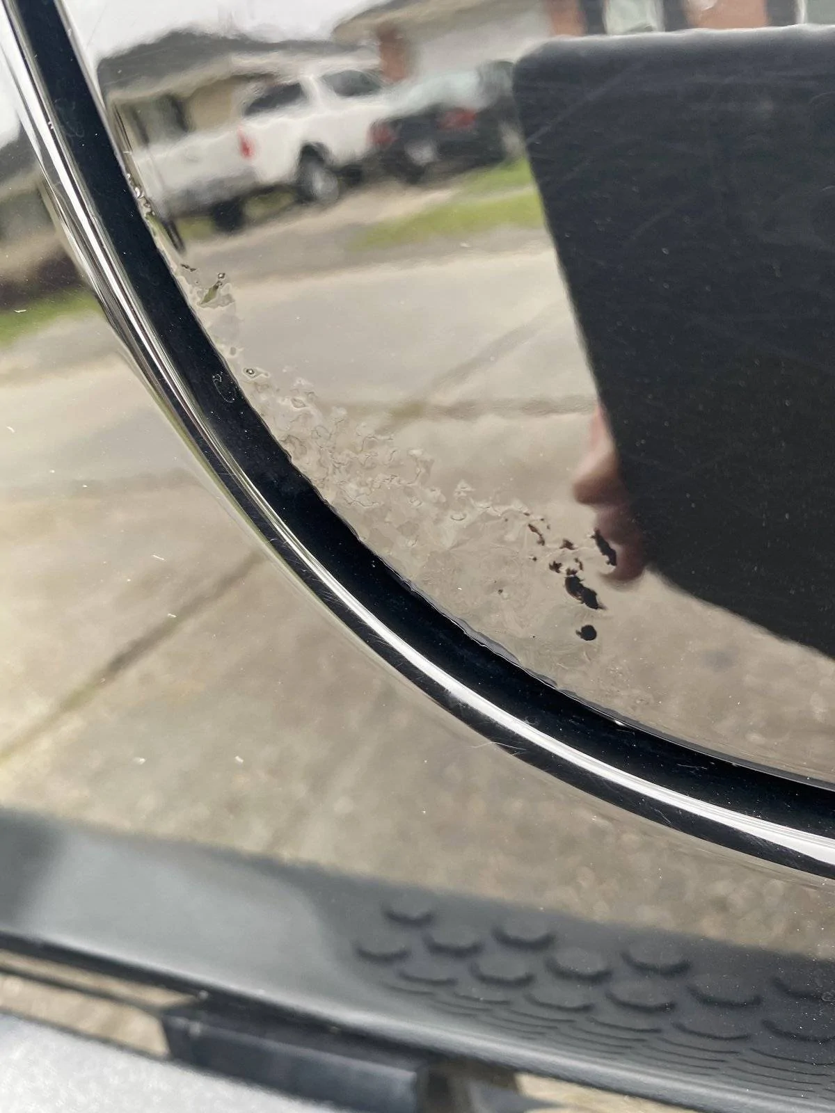

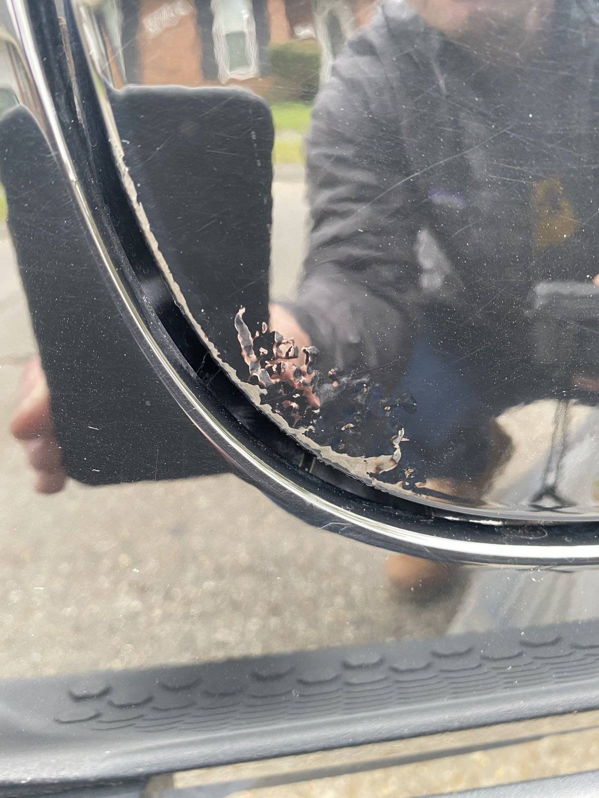

Just noticed this was happening on my driver side door. Nothing around the hinges yet. 2020 Rubicon. Will be bringing it to the dealer this week to see what they suggest.
