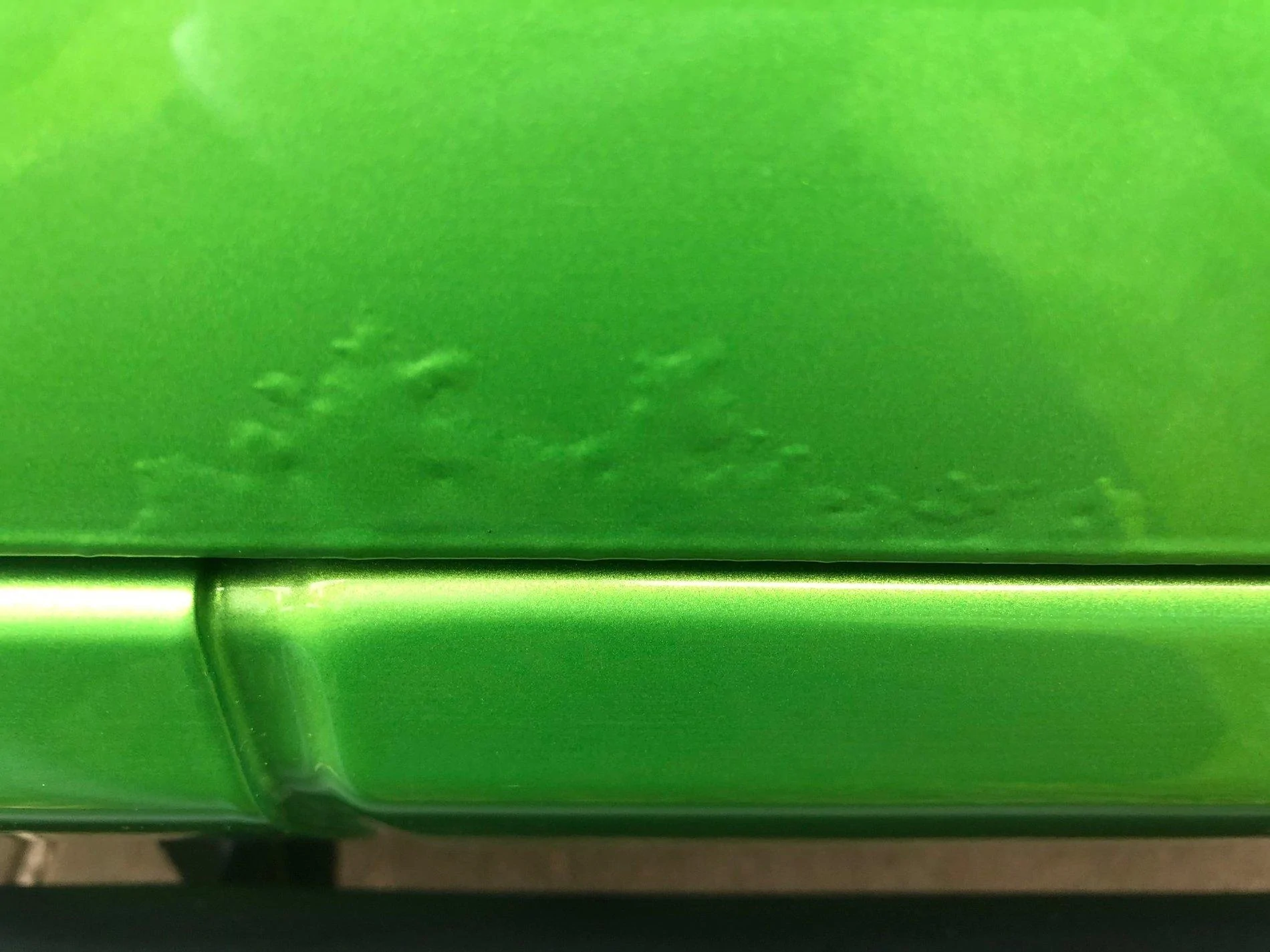

I have a 2019 Mojito and four of the eight door hinges are showing signs of bubbling and found the bottom of the drivers door bottom is real bad. I have 15k miles and Im in Colorado where we are having some of the worst drought conditions on record.
Whoa..... Its such a shame cause Mojito is the best color for these Jeeps. I have small bubbling, no where near this bad. I would be so beside myself.
