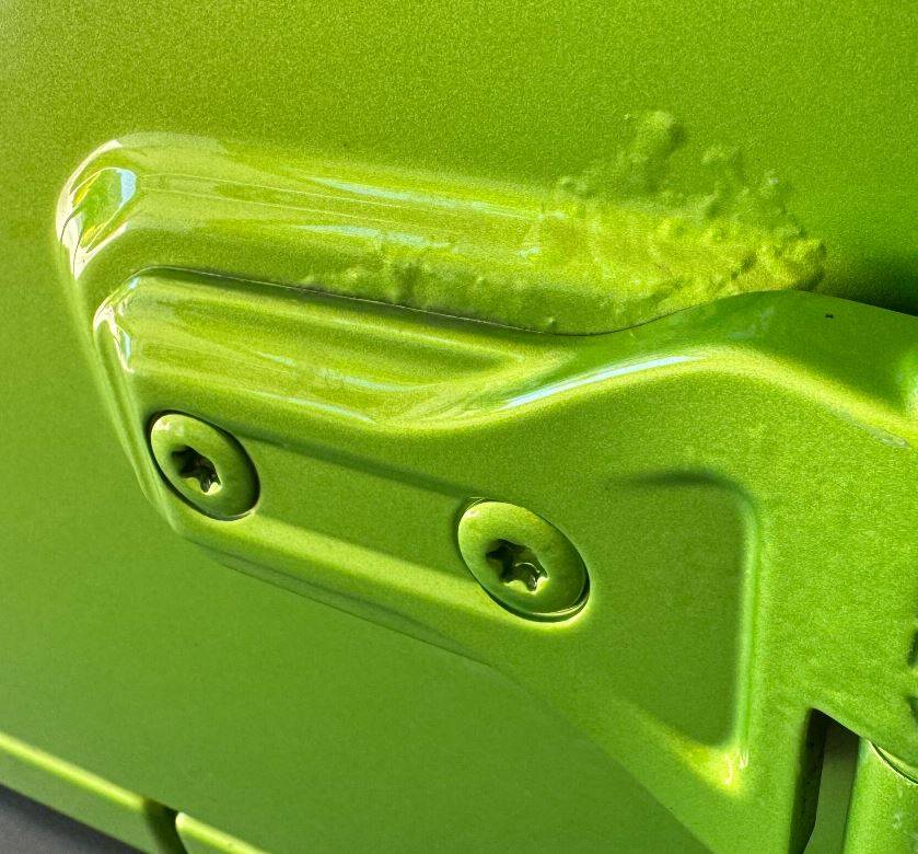

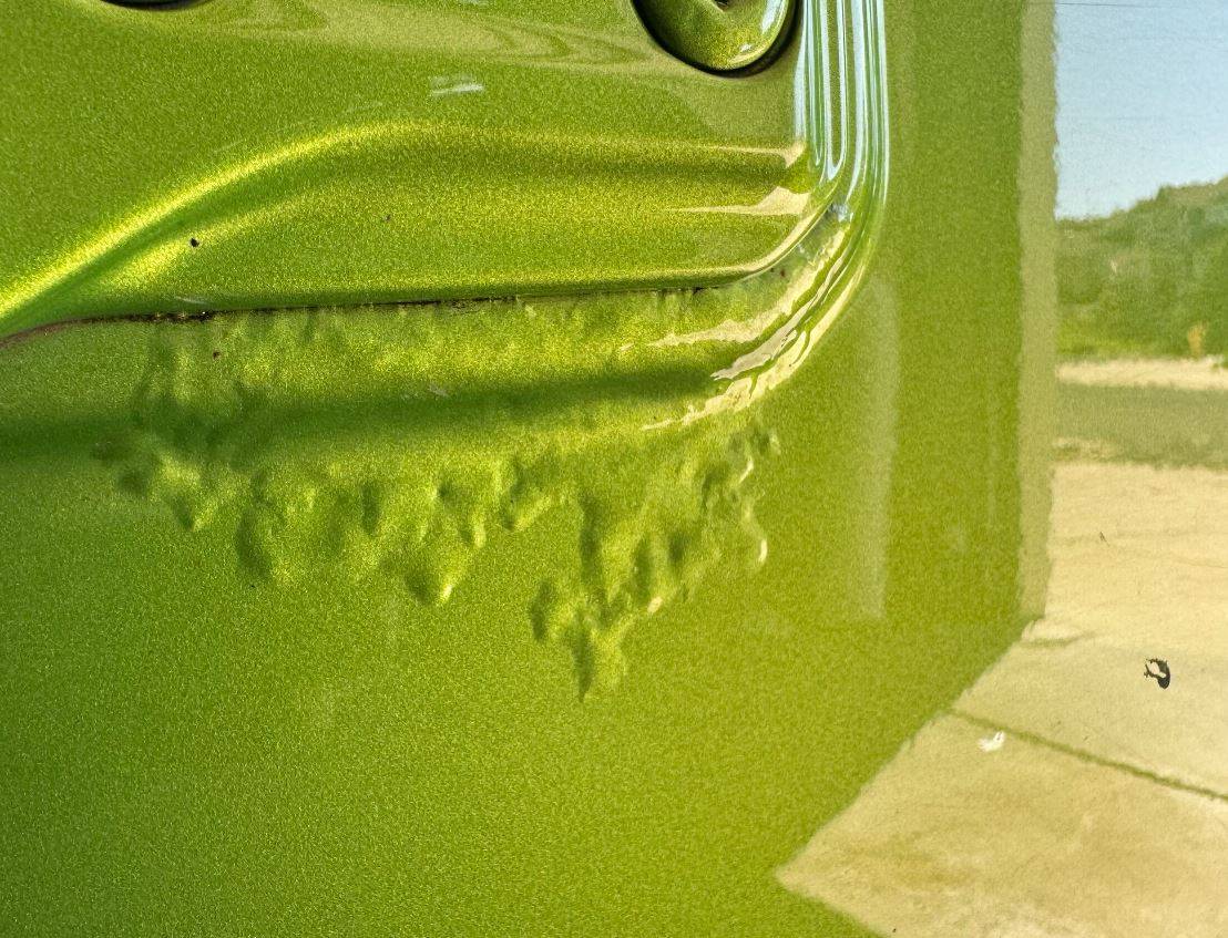

Bummer. Just noticed this major issue on my '18 JLUR which is now out of its 5 year warranty.
Was just pointed to this thread and I can now see many other JLU jeeps are also impacted. Sounds like a corrosion issue under the paint due to a mismatch of metals coming together based on my quick scan of these pages.
So my question to the community is what are my options at this point? I am mostly inclined to leave it as I am more interested in the mechanical functionality of the vehicle which is still working great on the trails of Colorado and Utah. My concern is that this could get way worse if left fully untreated.
What should I expect to pay for a reputable auto body shop to fully address this issue? would their rework fully prevent this from occurring again, or is it just a cosmetic band-aid? I know matching paint is also a concern. Are there any aftermarket hinge caps that would mask this issue fully/partially that others have tried? I am hoping to not have to do much and just roll with it, but also don't want a major issue 2-3 years down the road.
Lesson learned...stay up to date on this forum, and don't just visit when I have an issue!
So I just got mine done. Also a 2018 but I submitted the claim in October before my warranty was up. They actually replace the whole door because technically there is no way to stop it once it starts. They now put a titanium shim in between the door hinge and the door itself. You could get it painted like they did to mine the first time back in 2020 but it will almost always come back. I would just leave it until it gets really bad, like flakes off.
