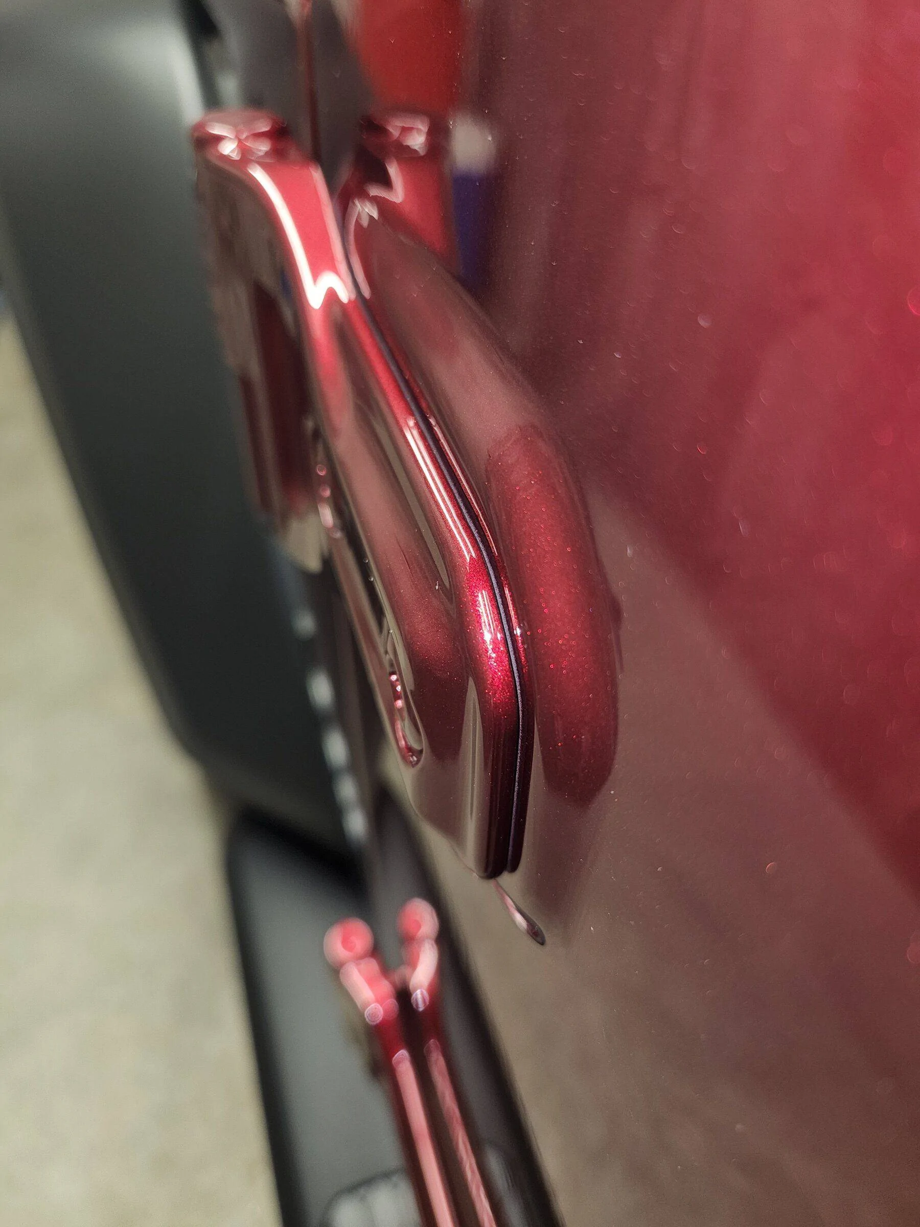

This is a pic of a hinge on my 10/11 build
Jeep Wrangler JL Bubbles in Paint at Door Hinges Resized_20220501_210942

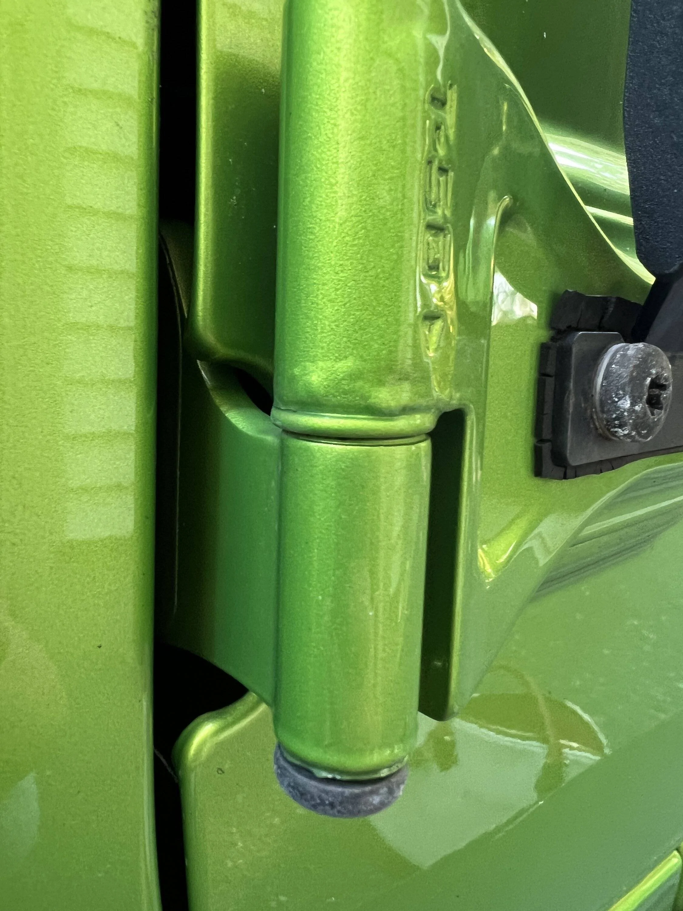

That isn't a gasket you are seeing, it's the unpainted metal in there. My 2019 Rubi is black and has the same look. I stopped at a dealer and looked at a new one in white, same deal. No gasket, but it "looks" like one due to the lack of paint. Here is a picture of mine.
Jeep Wrangler JL Bubbles in Paint at Door Hinges 20220621_135301
Considering all the painting is done by robot, it's odd that there is so much variance from one JL to another. Some hinges have that seam completely covered and some completely open.

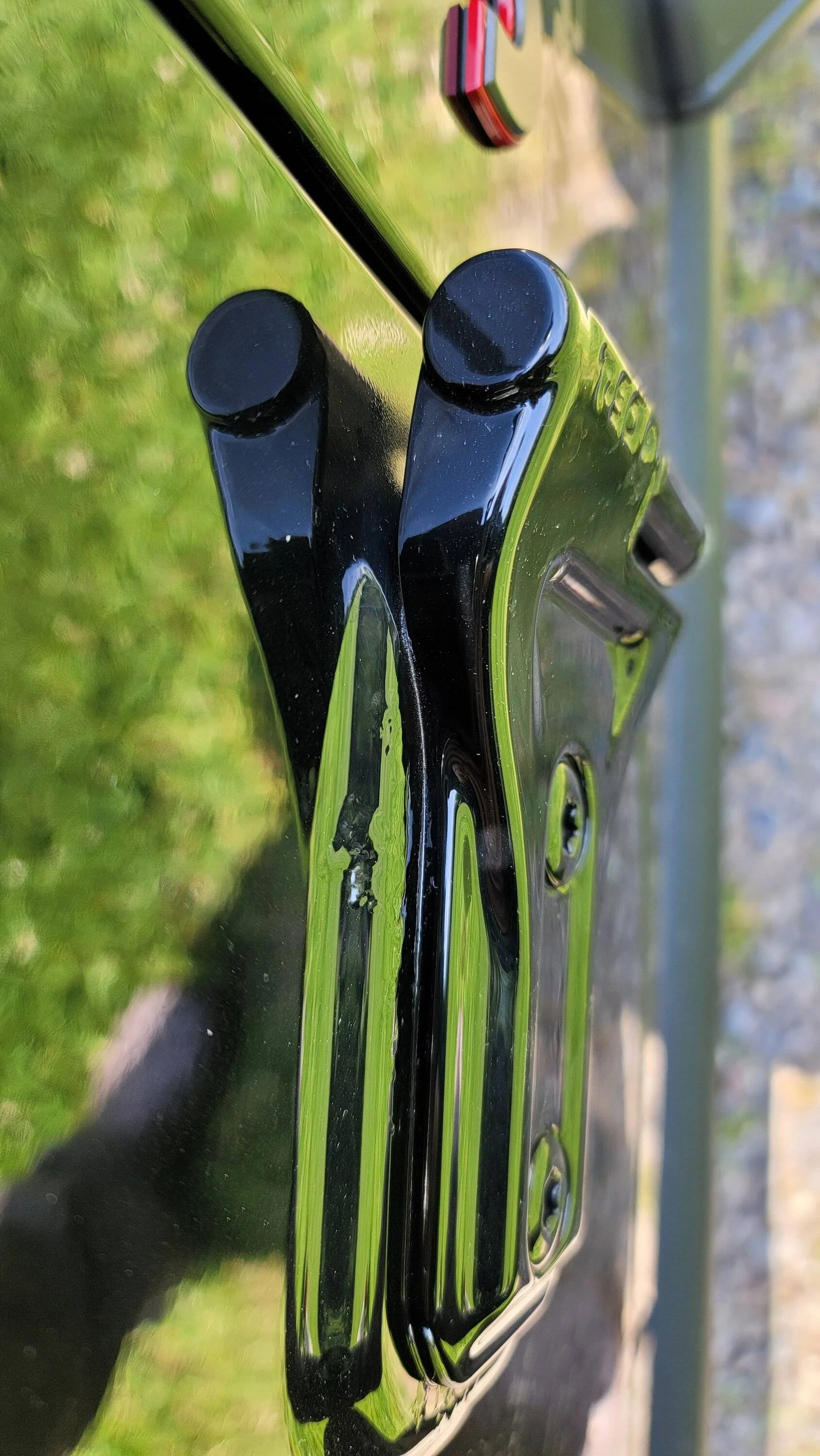

While I agree that that may not be a gasket and may be lack of paint, I will say that the newer Jeeps (late 21 and newer) seem to have a gap between the hinge and door that earlier Jeeps do not. To me that indicates something is between the door and hinge now that wasn’t there before.
https://www.jlwranglerforums.com/forum/threads/bubbles-in-paint-at-door-hinges.32756/post-1932799

Jeep Wrangler JL Bubbles in Paint at Door Hinges 07162AAD-05CC-48FB-B6E9-105341723768
Mine isn’t bubbling where the bolt is it’s the side by of the hinge pin. But I guess it’s the same thing?
