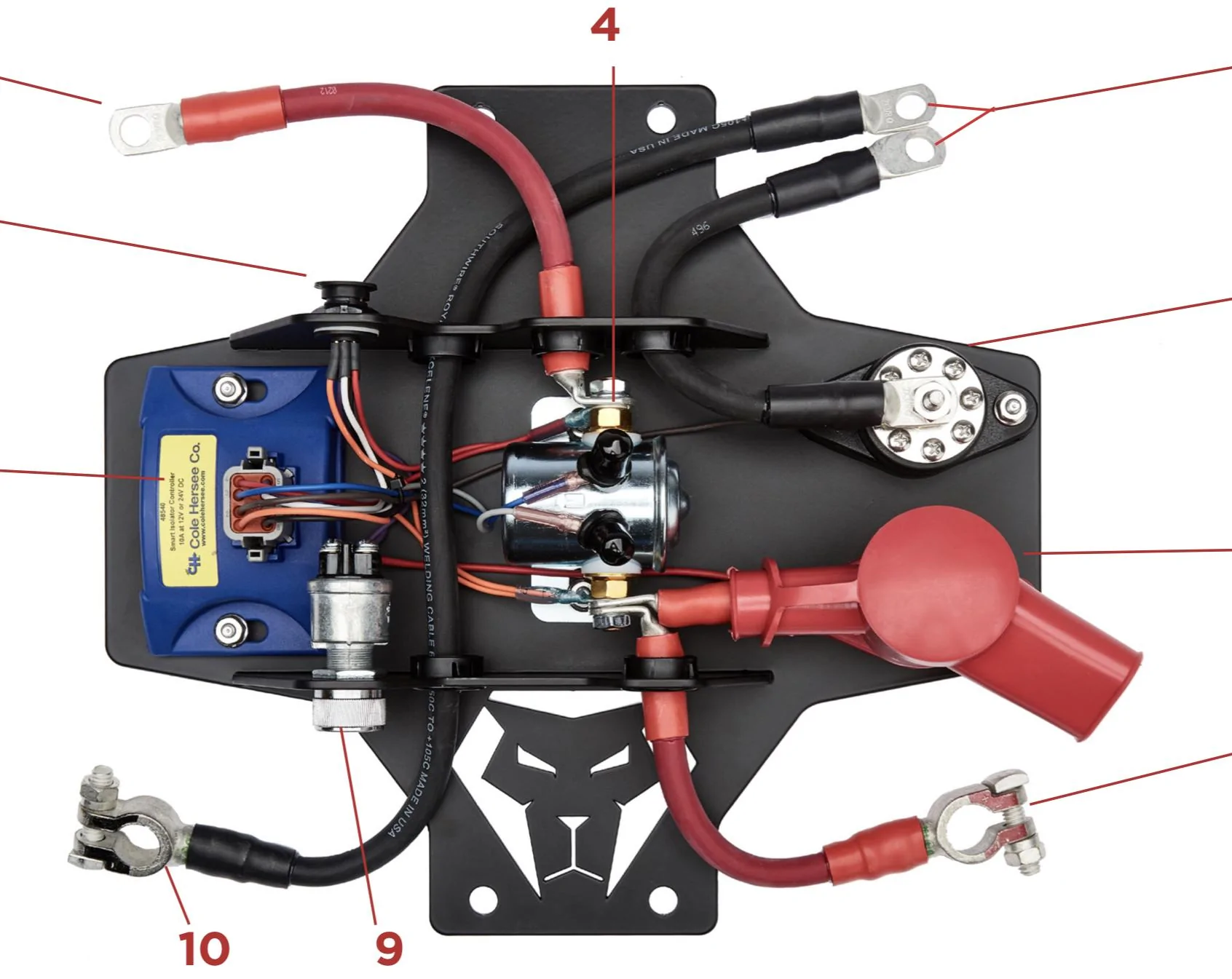

My reality is, I have aux. power needs and added eight additions fuses. With power needs for a winch, gmrs, cb, driving lights, twin ARB compressors. I am thinking of going to Genesis dual battery system and wondering if I can fit it in, Haha.
You can clean all of that up with the Genesis system, the aux battery has both + & - bus bars to connect to for all you aux needs, I have winch and compressor feeds coming off the aux and then I have some portable lights that I can clamp on to the aux if needed when needed.

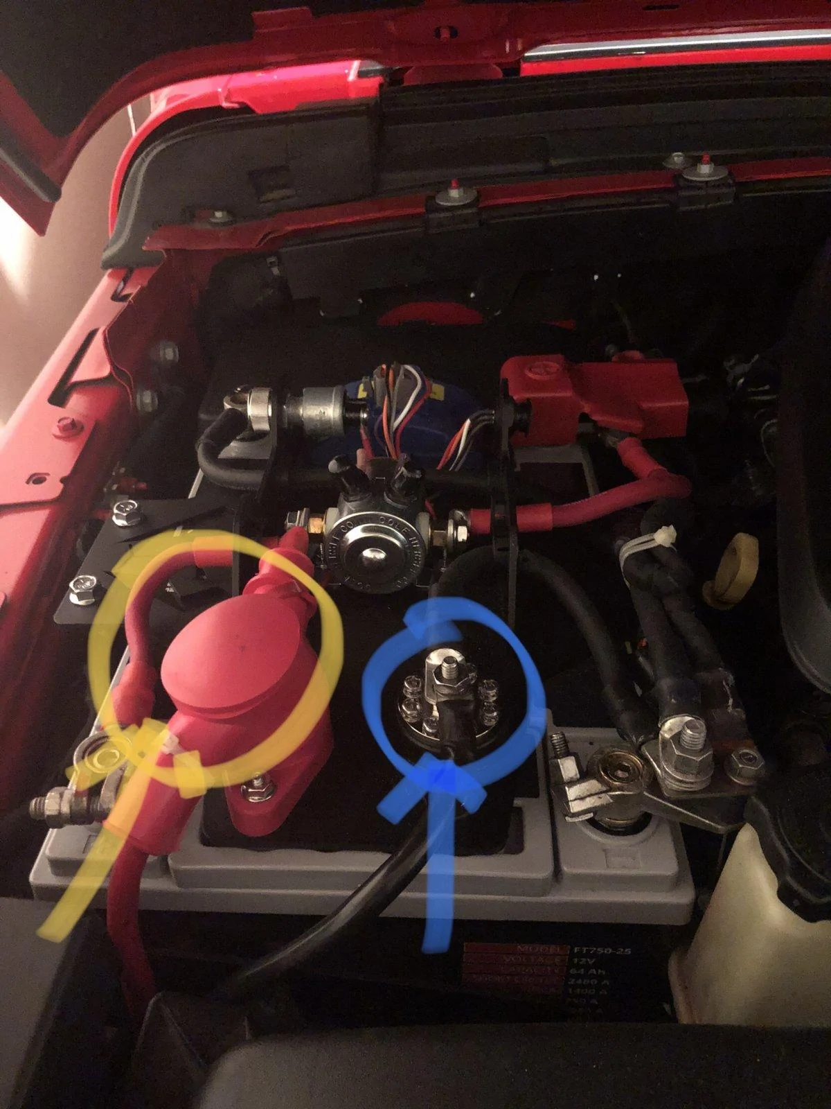

Here’s a better view
Jeep Wrangler JL Battery Replacement Question for the Experts 3D243857-07D7-46D9-A926-4AA906F42491

I second that the genesis will fit-I have all that crap on dual odysseys-some stuff like arb and lights are on main w aux-radios wench others on the aux.
might have todo a minor rework of bus but if u wired it-it will be simple.

I made this mess and might have to relocate the aux. fuse panel a tad. The Genesis kit will have to be on hand cause it looks pretty close to fitting. Something I will be looking into this year. I have the n1-n2 jumper and a battery jumper pack and jumper cables in the rig at all times.
I ran with the jumper on N1 to N2 with the ESS negative disconnected for a month so and had zero issues but I have ESS disabled with a SSS module and just never liked the ESS battery location and the possible issues it would have generated as I did not have the TSB applied for the battery ( this fix was made permanent past 2018’s) anyway as my concerns and needs grew I wanted a more stable system so opted for the dual Genesis, is the system perfect ..NO ITS NOT but it’s alot better than the stock system for my needs as I want the extra power available to run auxiliary equipment and don’t want to tax the main battery plus as you well know the Genesis has the boost ability which I have tested several times and also used once and the one time I needed it to boost me it was there and worked like a charm, just think built in jump pack without the hassle.

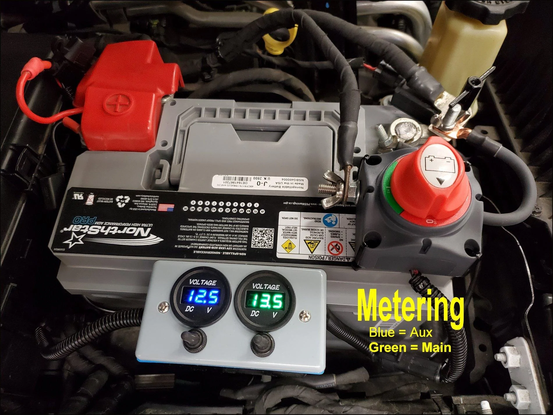

As you and many other's here know, I do not use/run with the Aux battery so my stock Aux just sits in it's cradle... sits doing nothing, acting as a backup if I were to ever need it. I do maintain it with a battery maintainer..
For those that have not seen my dual battery set-up ..... the set-up that has me running with just the Main, you can read more / see, etc. here... https://www.jlwranglerforums.com/forum/threads/ess-dual-battery-management.60034/post-1340536 .
NO, my setup, is not one of those pricey $2000+ aftermarket affairs... I am not foolish enough to go that route/spend that kind of $ with my type of vehicle usage..
Here is a pic of my set-up..
