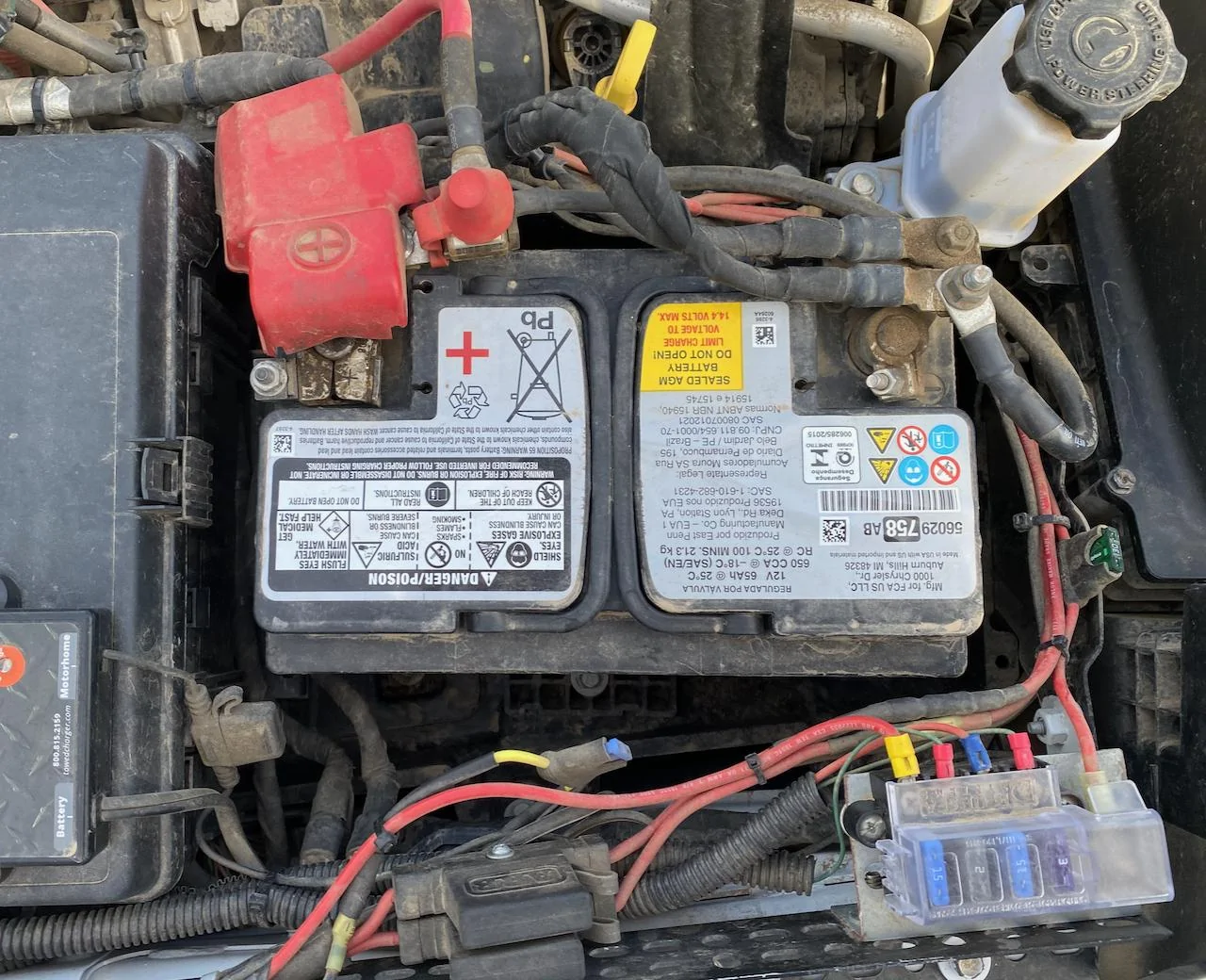

My much less fancy, but equally effective, bypass setup. All credit to Jerry and Bill... easy to implement and great peace of mind.
(I do still maintain my AUX with a tender 2x a month.)

Haha, thought I was going nuts not finding a link to "Jerry's Kit". Now I finally know there is no assembled kit. Too bad. Your installation looks very clean.
@sourdough

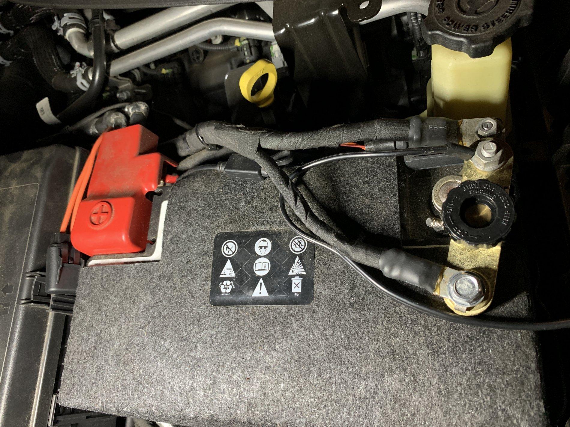

Guess Jerry got bored and figured he'd help this feeble ole 72 yr. old guy out... do me a solid... and he did the dual meter kit assembly for me at his place and mailed it to me. I am very appreciative that he did this for me...
I took what what he sent me and I installed it along with a new Northstar battery.. YES, it is a "very clean " set-up.
Reality is though... as mentioned in my earlier post... and Jerry also mentioned earlier.... that ...
that, I ran just fine for over 2 yrs. with just an N1-N2 fused bypass jumper and the Aux negative cable disconnected... and watching not to use StopStart to often or at all..
