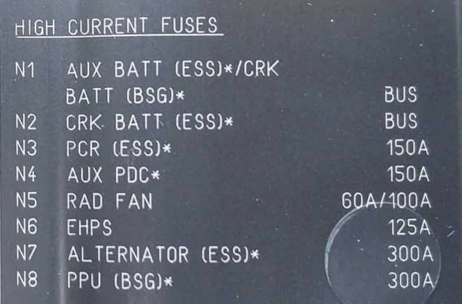

After seeing this post, https://www.jlwranglerforums.com/forum/threads/help-with-n-terminal-connections.74322/ , I looked at what happens if the N3 cable gets connected to N4 instead.
Jeep Wrangler JL ESS Battery Cable Caution and ESS (N3) Fuse Warning pdc label 3
Since both the N3 and N4 fuses supply system power through a 150A fuse, it will not make any difference if the aux battery cable gets connected to N4 instead of N3.
This means that if you get stranded due to a blown N3 fuse isolating the aux battery and system electronics, you can move the aux battery cable from the blown N3 terminal to the good N4 terminal to restore system power to the aux battery and system electronics. If there's already a cable connected to N4, it is providing power to your auxiliary switches. Be aware you will lose power to the auxiliary switches when you remove the existing N4 cable to relocate the N3 cable to the N4 terminal.
@Jebiruph
Great info...... we learn something every day..

WOW! Again you’re fantastic information saved my bacon tonight! I’ve been racking my head trying to figure out what’s going on with my 2018 JL, I pulled off the N3 High capacity fuse array, and tested the N3 with an ommeter and found out that it’s blown. Now I know why my brand new aux battery DIED right in the middle of an intersection. Time for a jumper.
Jebiruph, I owe you at least a pint or more??. Thank you so much, Danny Martin

As I mentioned in post #12, you should be able to pull the cable of off N3 and move it to N4 to bypass the blown N3 fuse until it gets replaced.
