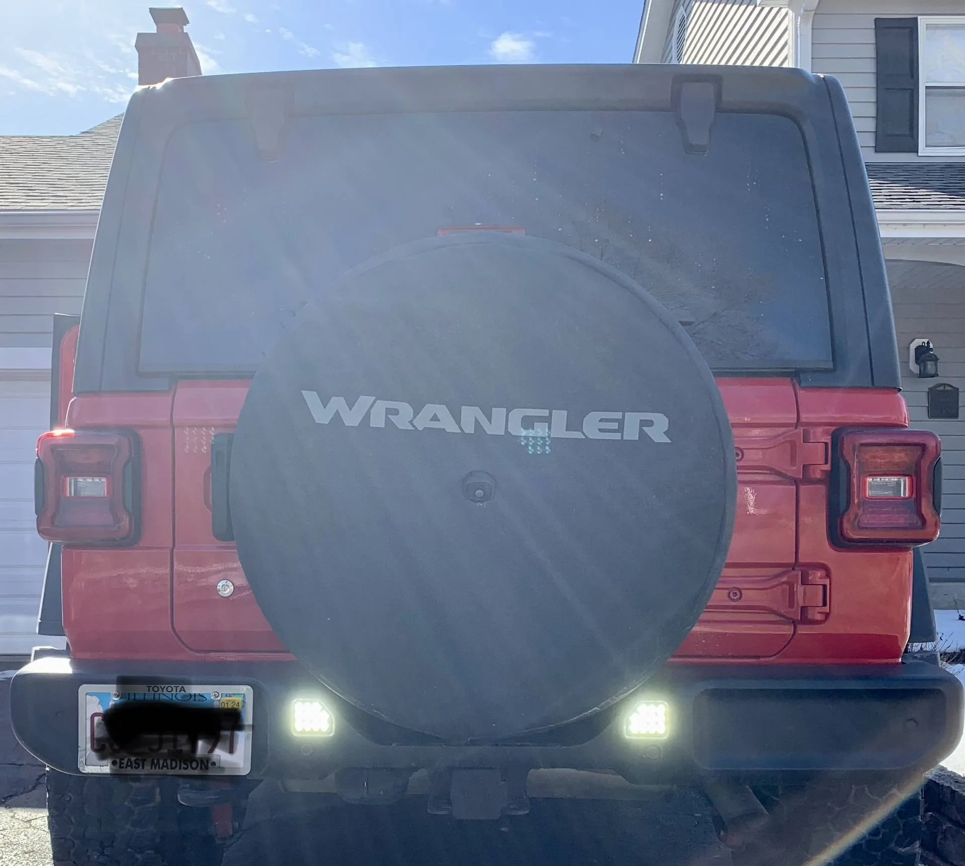

So I got the @ORACLElights bumper mounted backup lights installed finally. Holy hell did I have to grind a lot of material away to make that one fit the steel bumper. I admittedly ground away enough to go through the damn housing. I found myself just before thinking, “This is too much. You’re going to have to grind the bumper.” Then BAM, a small hole. I ended up sealing it up with silicone and switched to grinding the bumper and STILL had to remove a few MM of metal. Good grief.
Once that was done the install was super easy and the result is they are really damn bright, even during the day. I haven’t had a chance to see them in action backing down our very dark driveway, but I’m confident they will make a big difference.

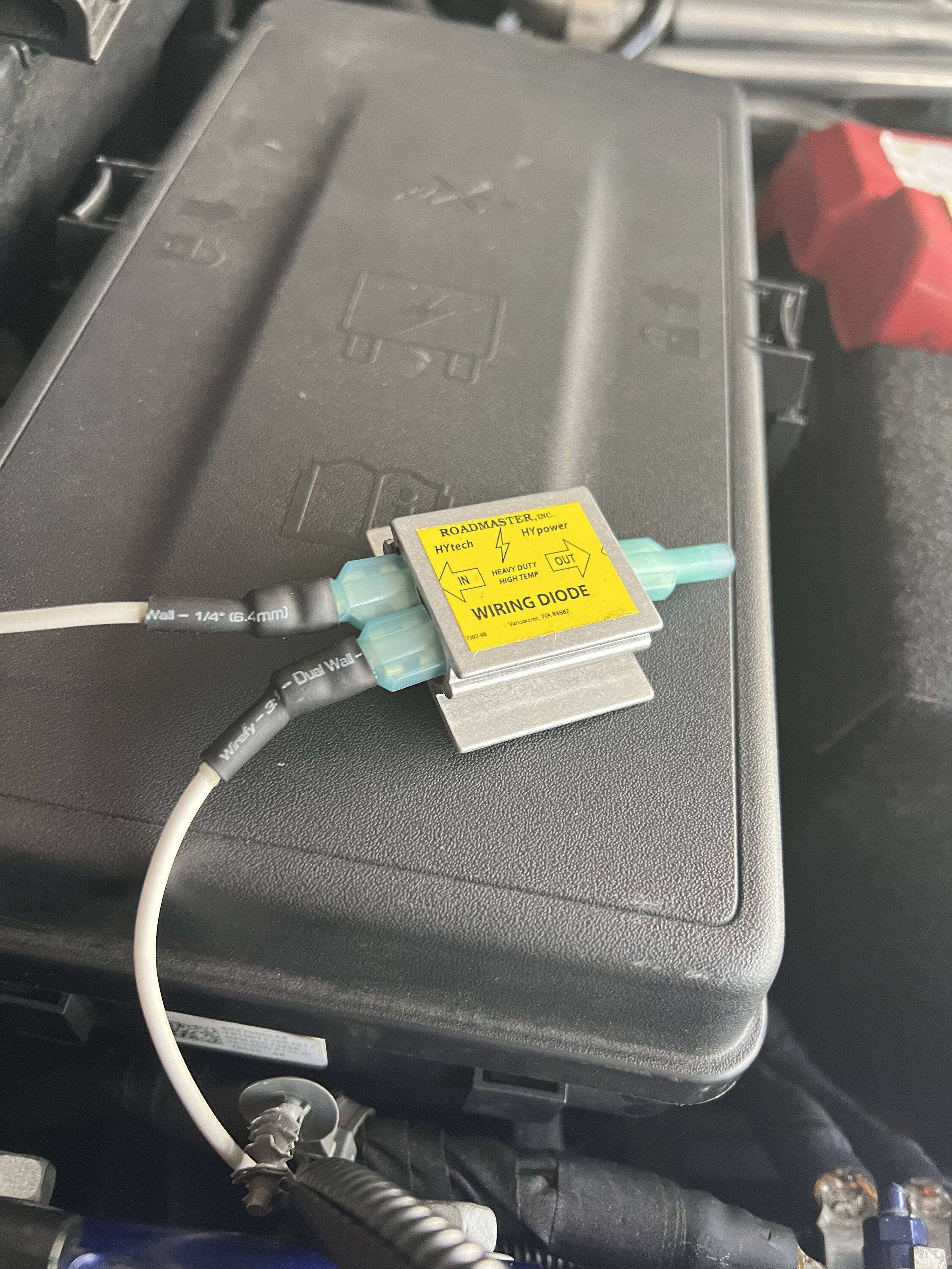

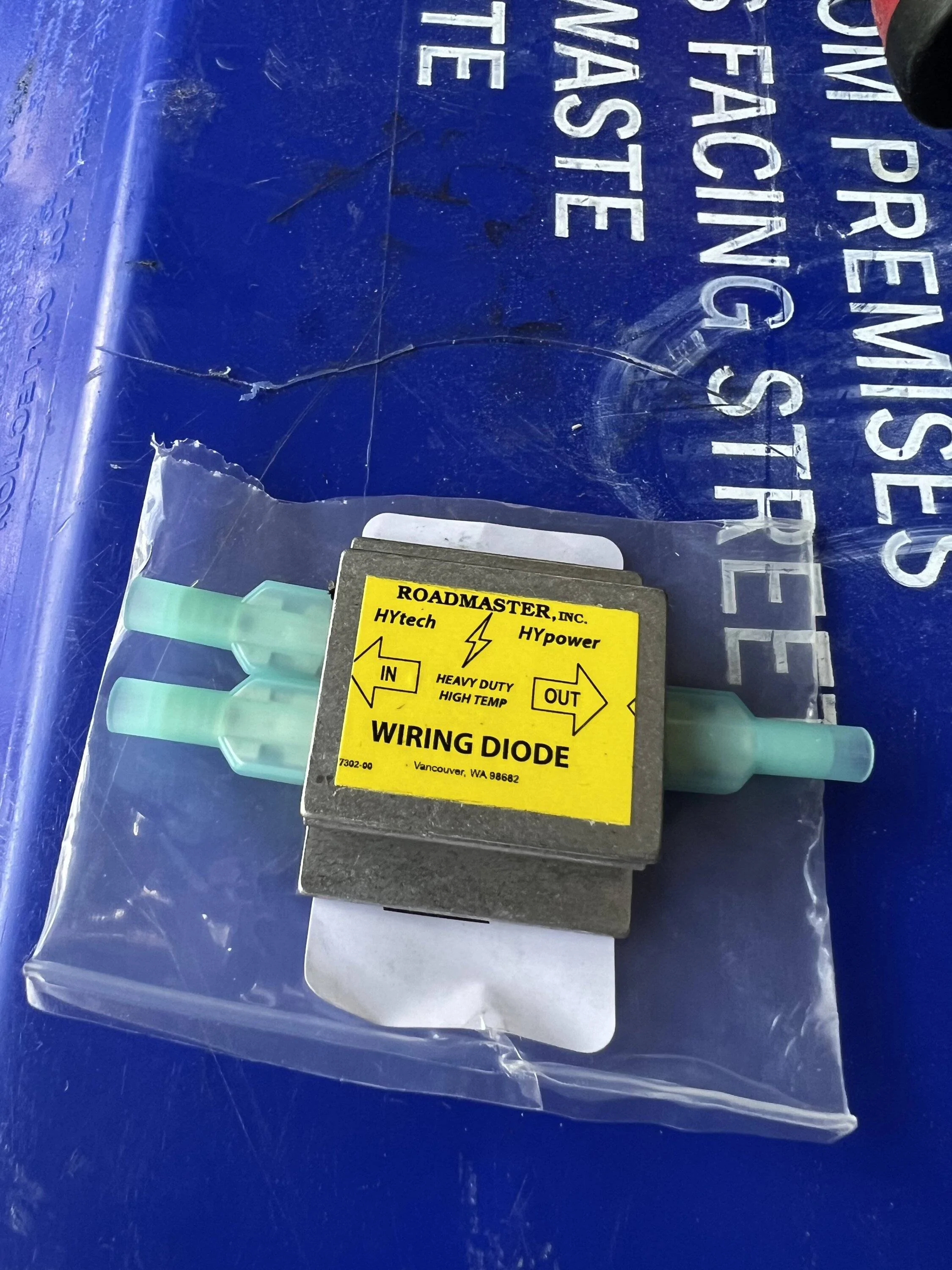

You no matter what will have to run a wire from engine back to Oracle light. You can tap into 'reverse light" wiring in the engine compartment but that will be connected to a singular diode to wire to Oracle lights or a dual input diode to Oracle lights. Then is you did a singular diode versions, you need a second diode from Aux switch wire into another diode and then tie into wire from the first diode to wire going back to Orable light. OR if you use a the dual input diode, first input will be from tow tapped wire & second input from Aux switch and singular output will run back to Oracle light and then oracle light ground just grounded out at rear of your Jeep.
The single input to single output diode (would need 2X):
Roadmaster 690 Single Park Light Diode
With this method you would have to tie the 2 wires coming from each of these diodes outputs together and run to Oracle light.
OR
the dual input to single output diode (would need 1X):
Roadmaster 790 Hy-Power Diode
With this method the singular output would be run down to Oracle light.

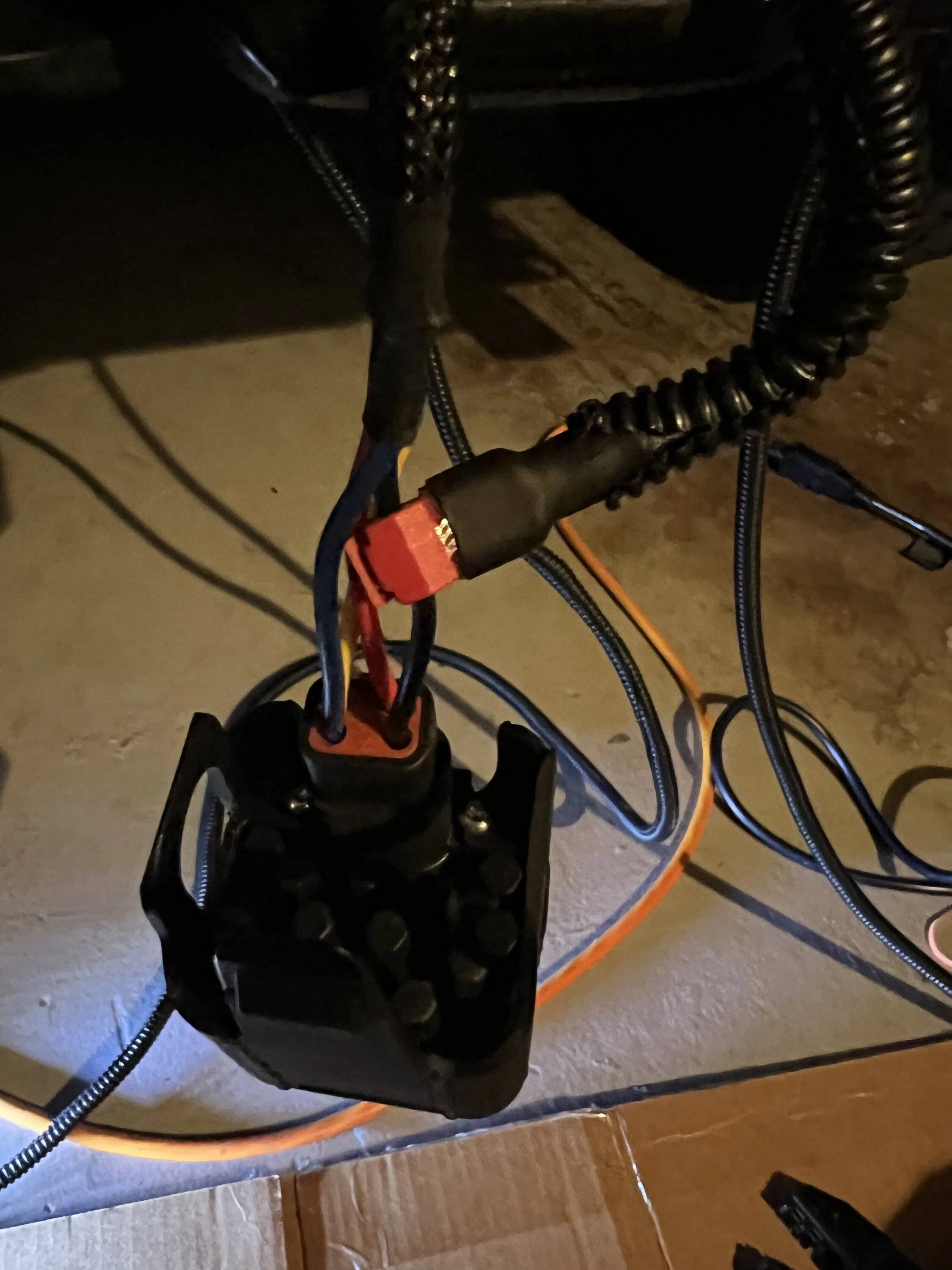

Thanks for the reply, I went with the single 790 diode. Other than some difficulty running the wire through the frame rail it was relatively easy. I made all connections inside the left taillight cavity, using reverse wire from the factory tow package wire harness. Sorry for the crappy picture.

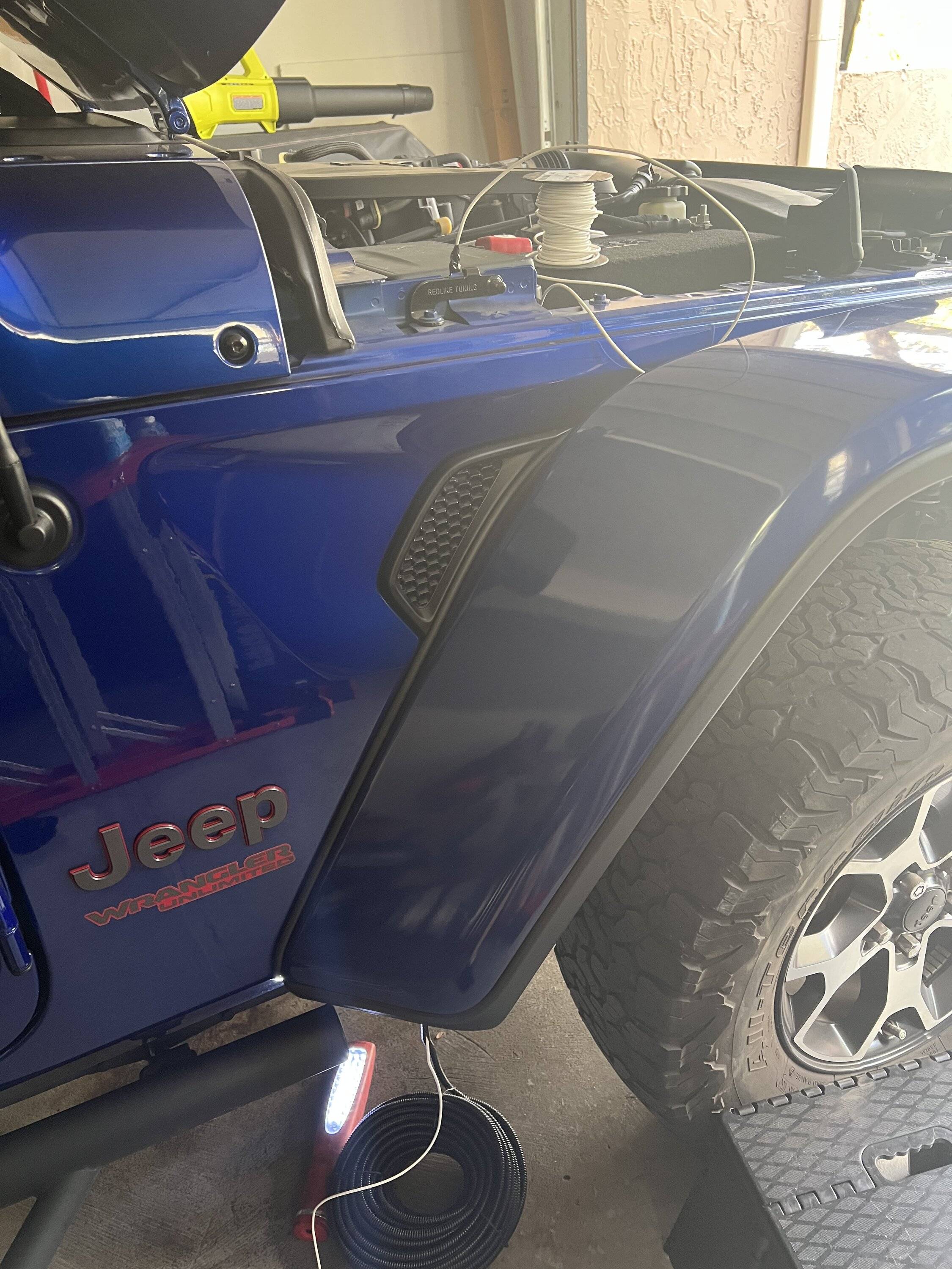

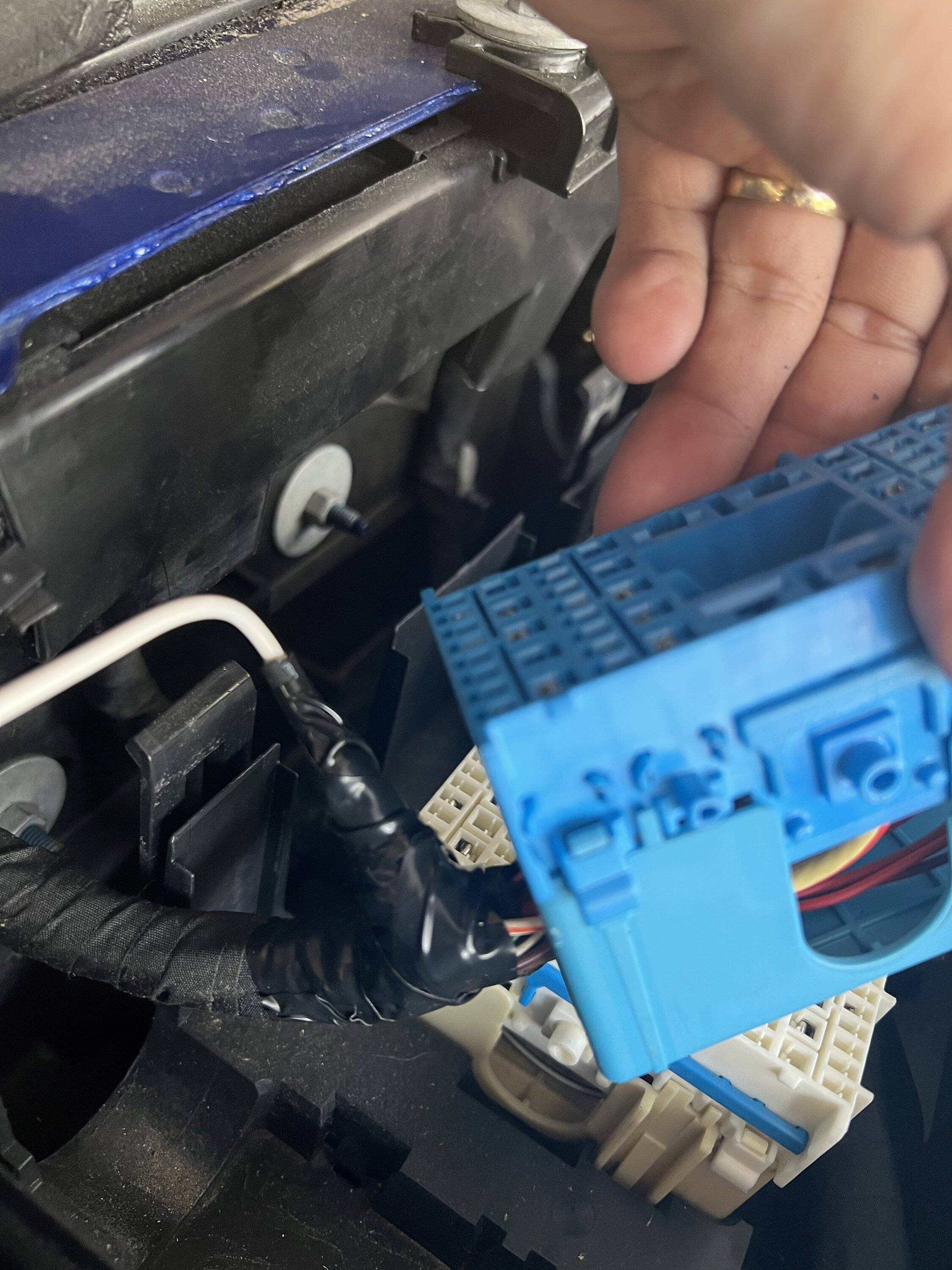

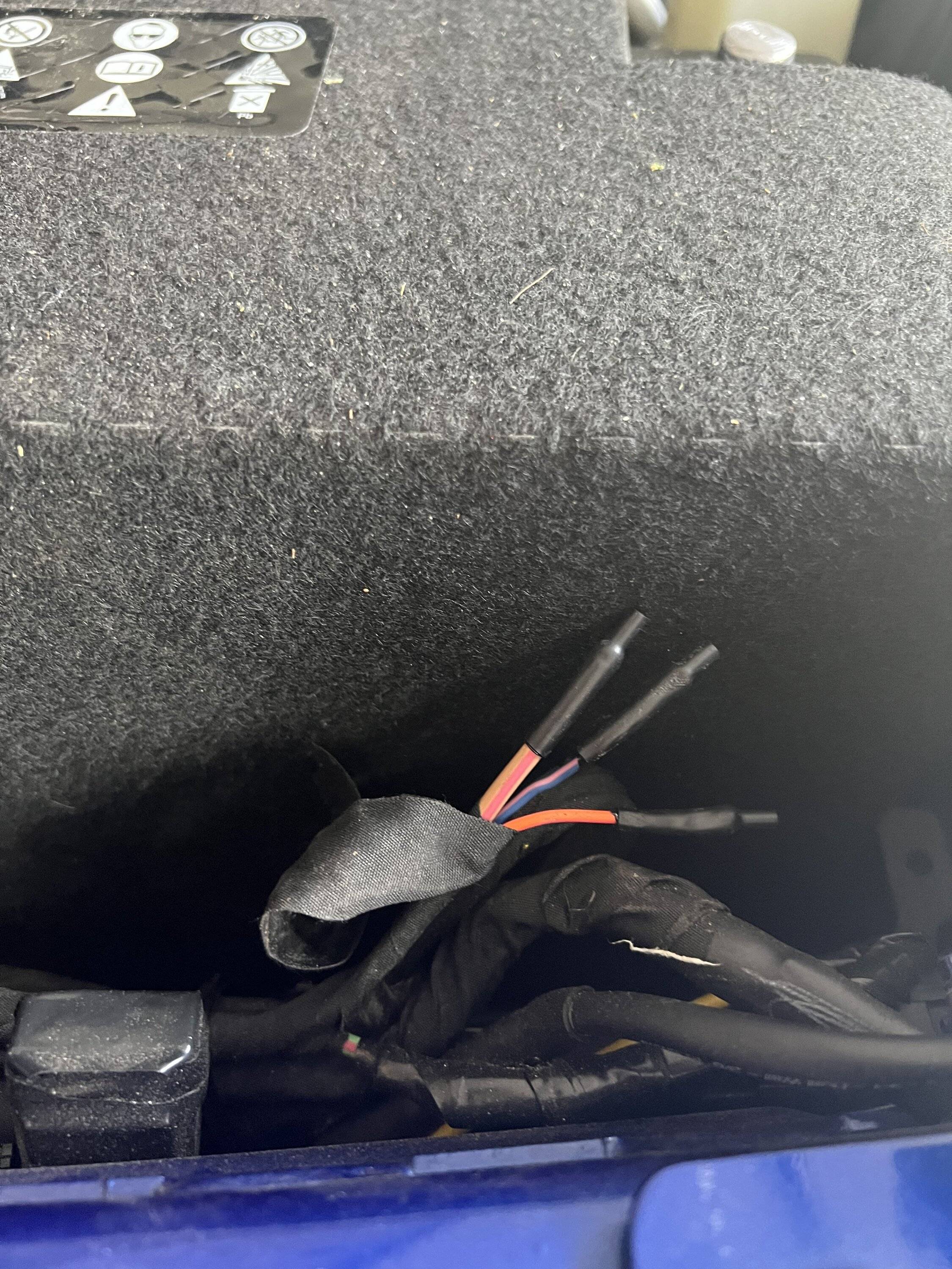

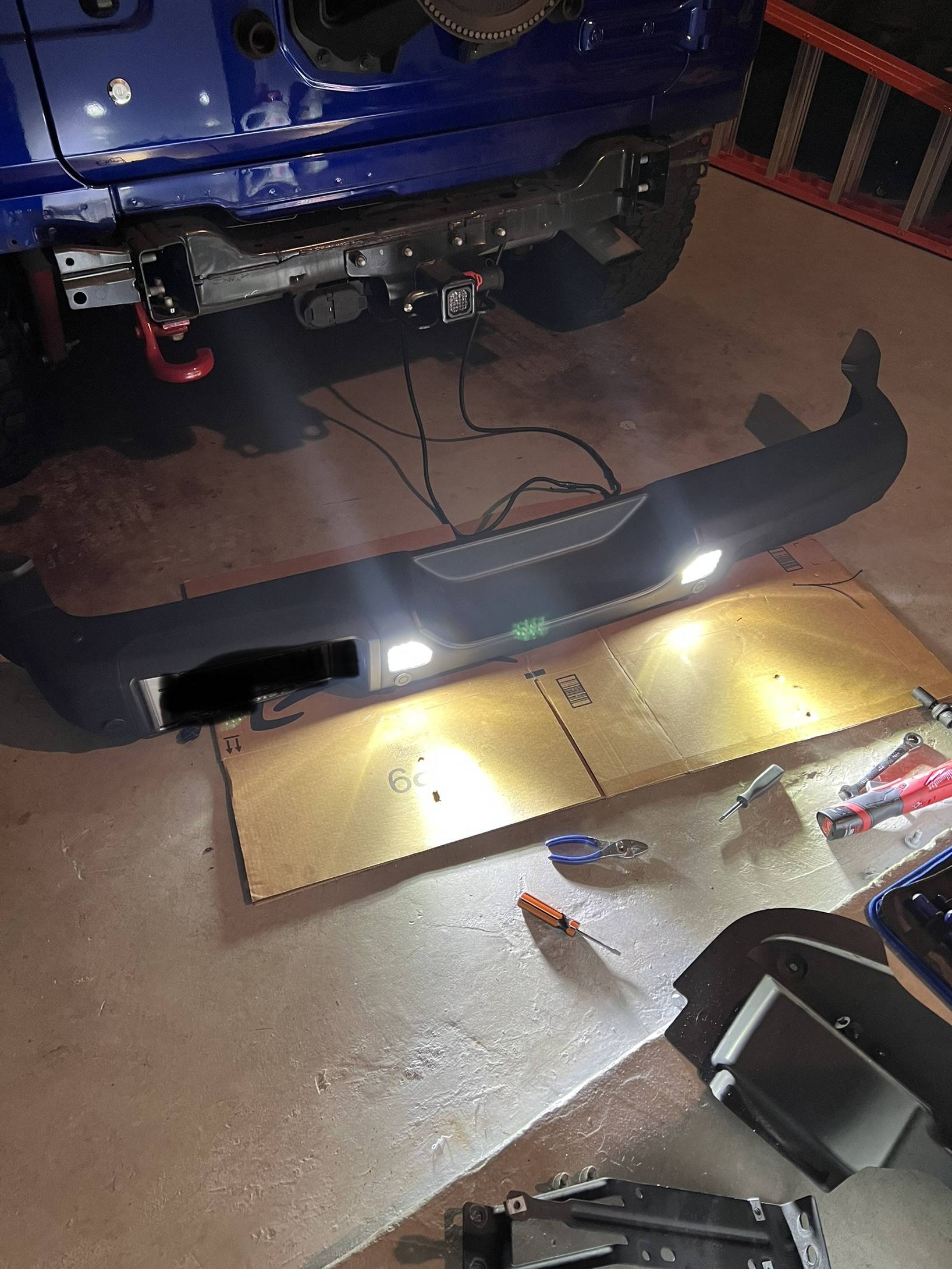

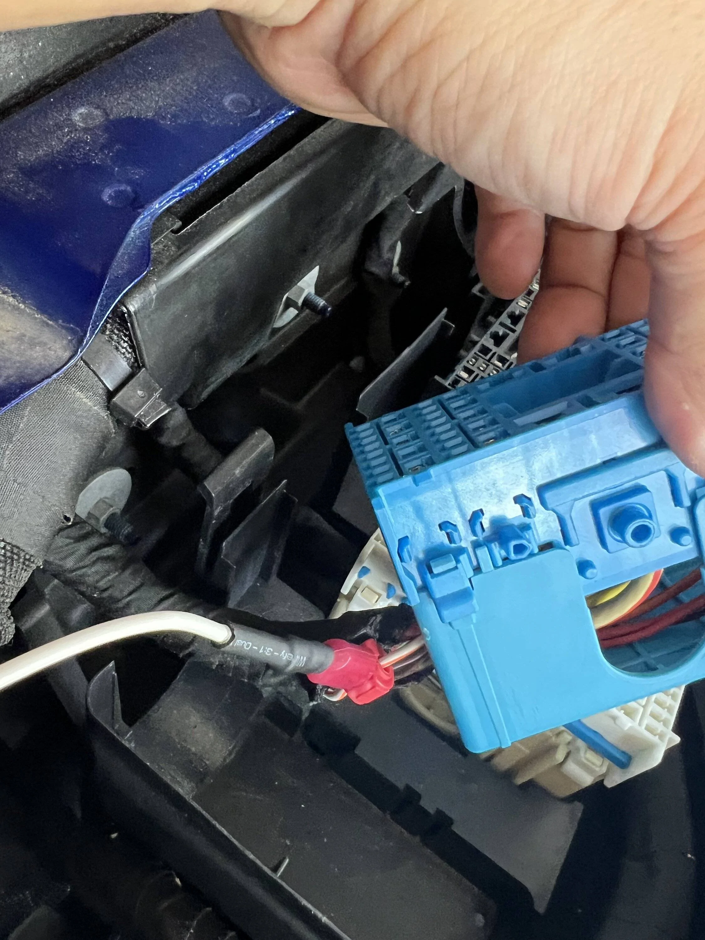

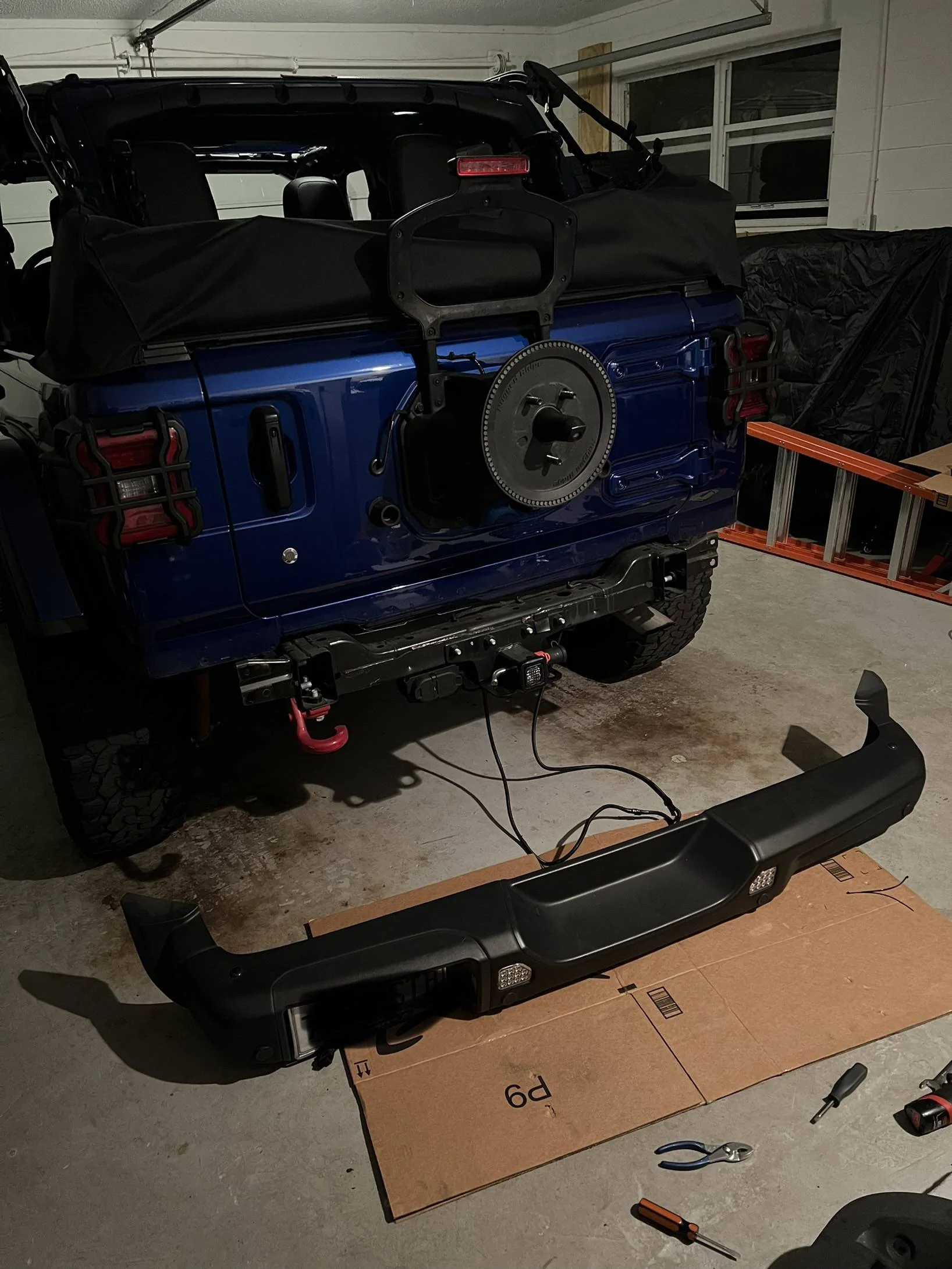

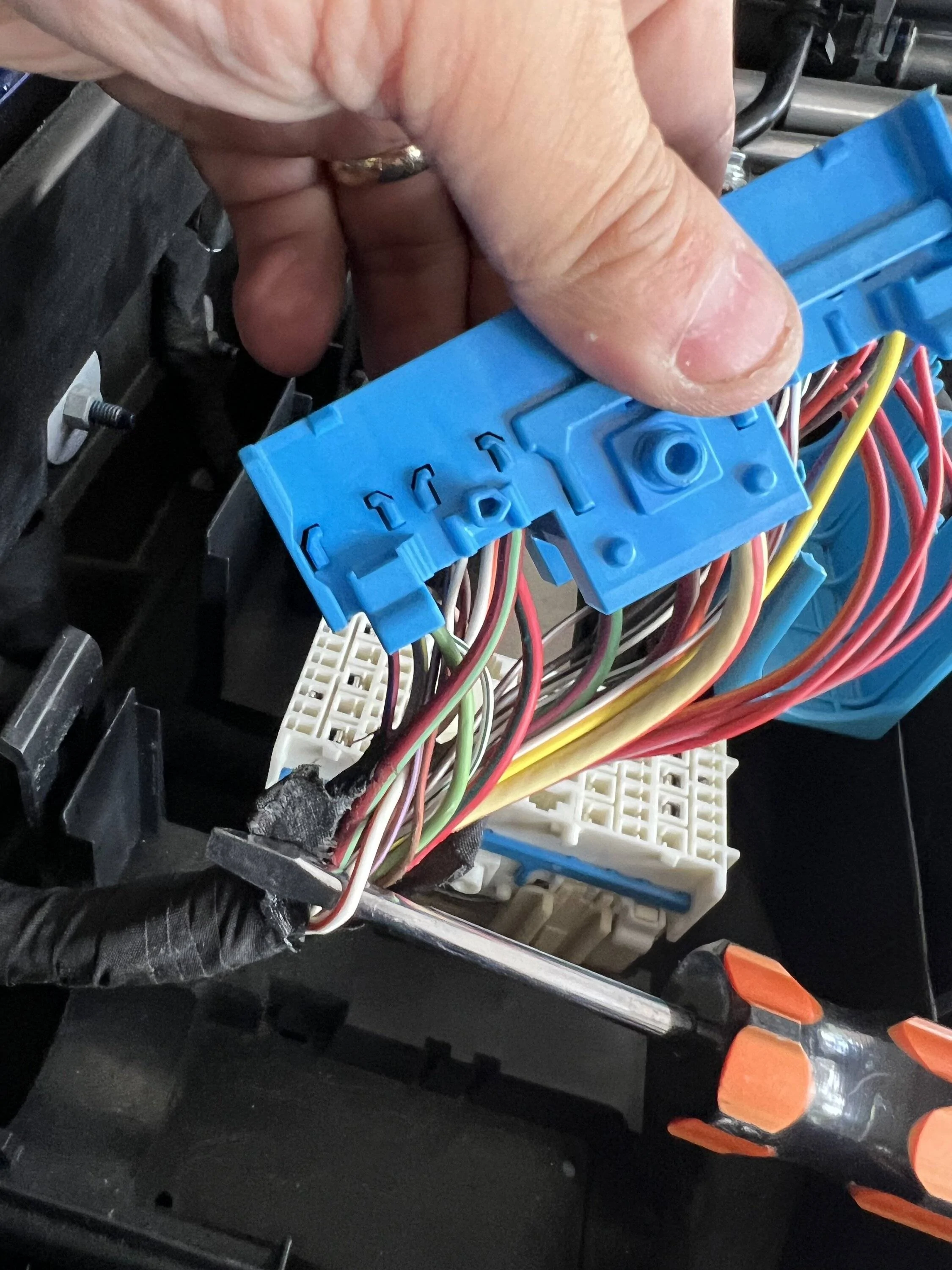

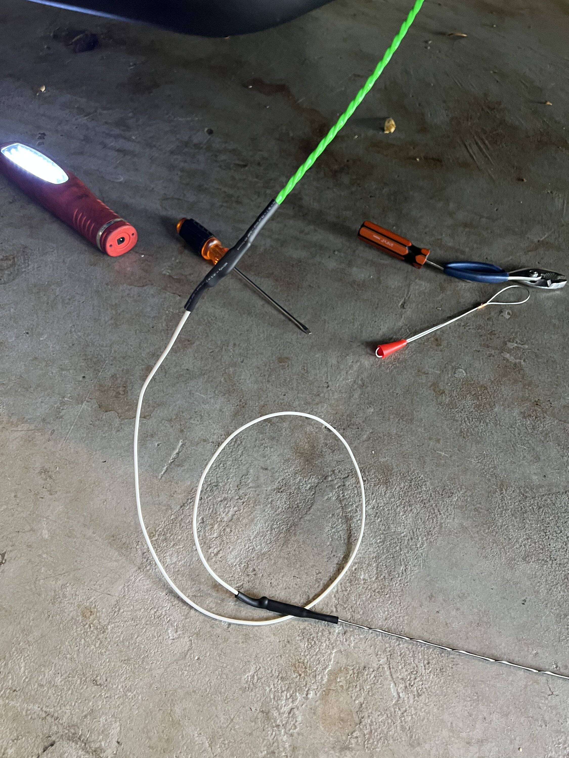

Lol…looks like a bunch of us did the install the last couple days. I did mine today but still need to put the bumper back on. It is all wired up and working.

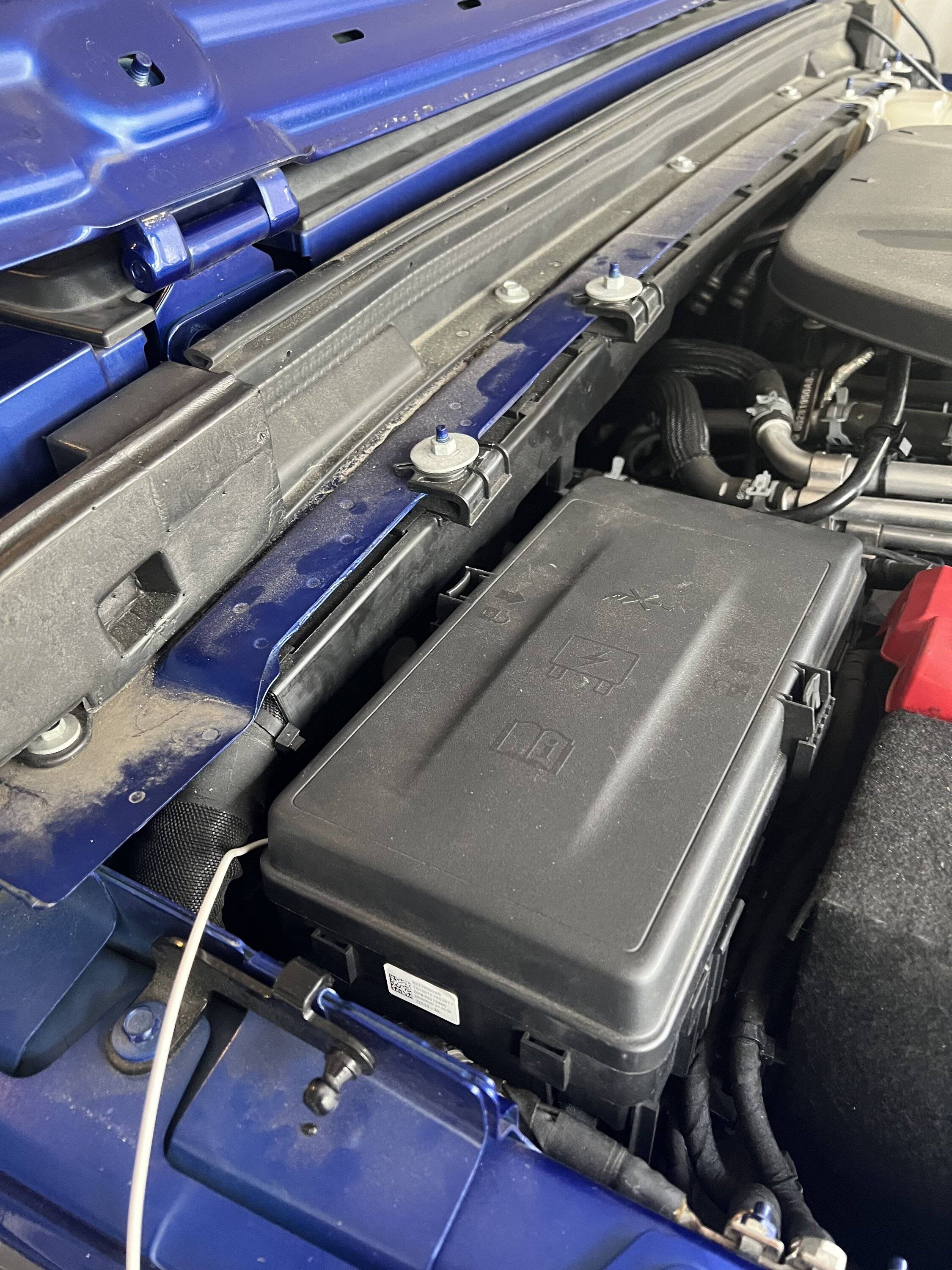

I actually tapped into the reverse light wire int the PCM wiring and the Aux 4 switch wire into a dual input single output diode. Putting the fish line through the frame was a pain and ended up using my stock antenna with wire to get past a small stretch of the frame. Once I got the fish line through, pulling the wire and conduit through was a cinch.
I ended up tapping the ground from the lights into the DD Hitch Light wiring ground.

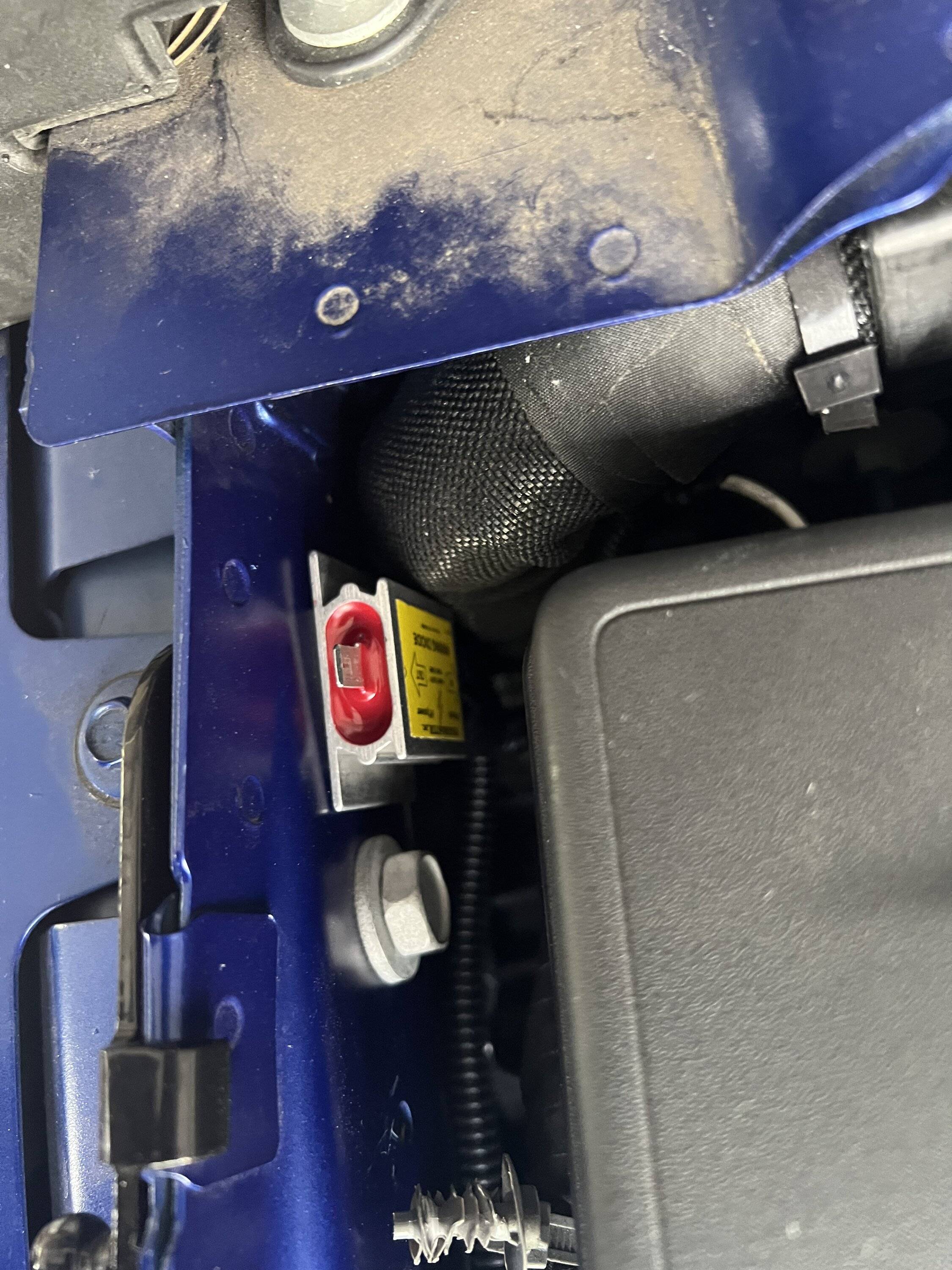

Pics from my install so far:
Jeep Wrangler JL Backup Lights 4E7DADE4-81D3-4A44-B5F7-F4BC82268C0D
Jeep Wrangler JL Backup Lights A40CCCFE-D4DD-4D56-9D82-1C2FBE88692D
Made sure there was continuity from pin in PCM and my tapped in wire:
Jeep Wrangler JL Backup Lights 0E0CD11C-0141-4520-AC6D-30673B6D7DC3

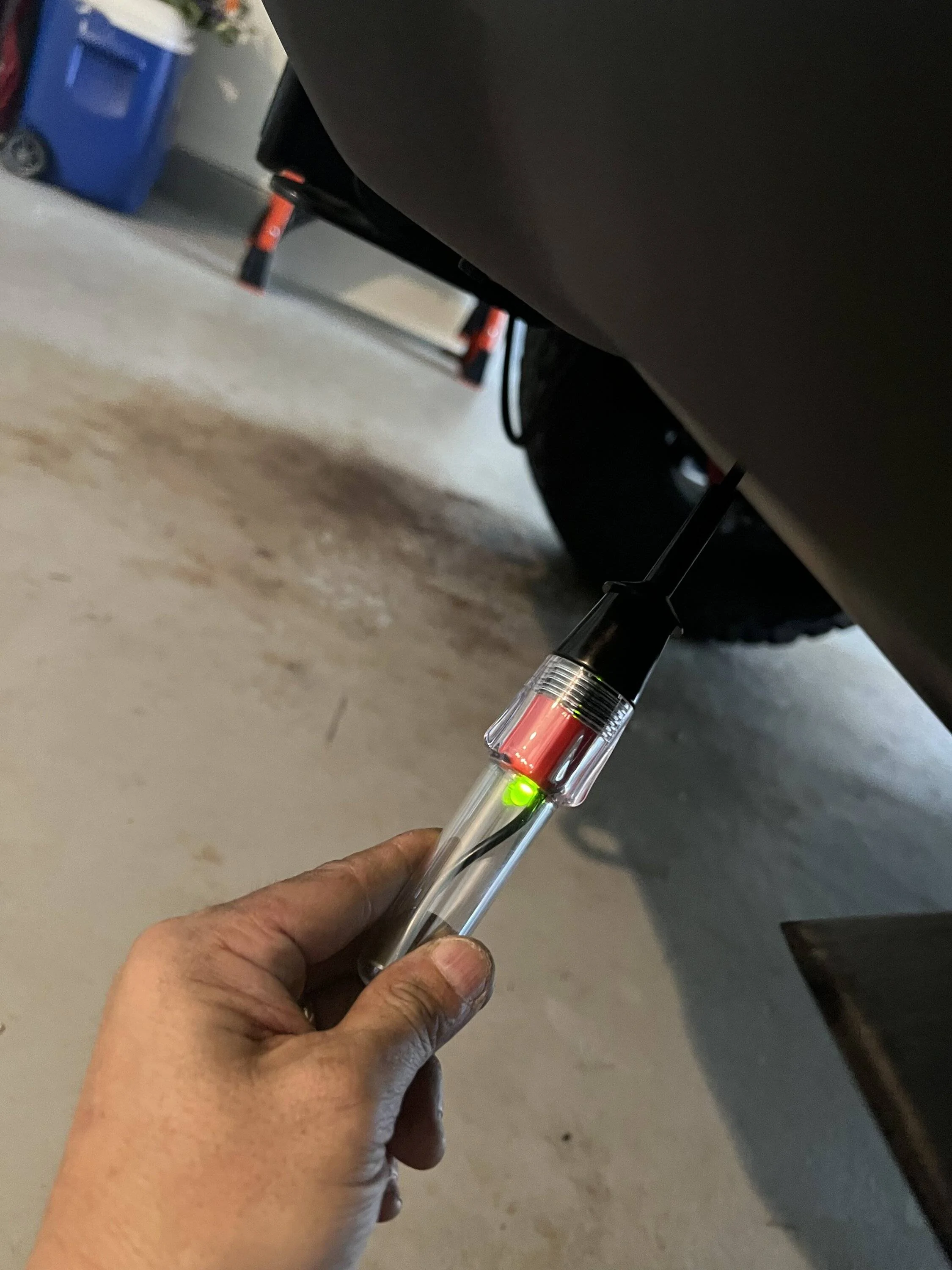

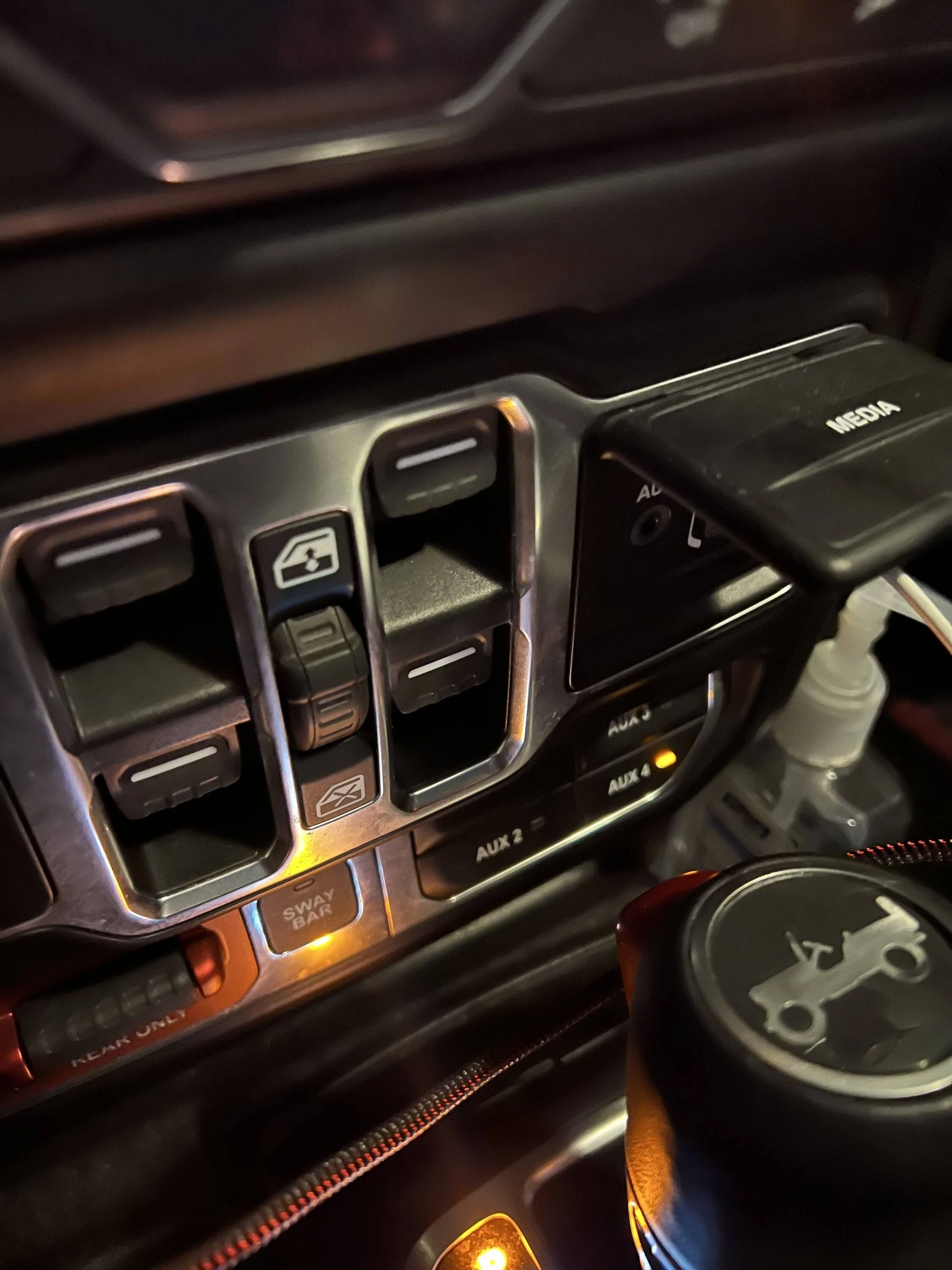

With wire run through the frame, switched the Aux 4 switch on and used a test light to check and it is working ???
Jeep Wrangler JL Backup Lights CB80C8CD-C888-4881-953B-C8AA88F4A861
Tapped into the DD ground
Jeep Wrangler JL Backup Lights 1CF79573-65D9-4CB3-AD09-063961B83739
Will post after bumper is back on and showing the light show ???

Switched on Aux 4:

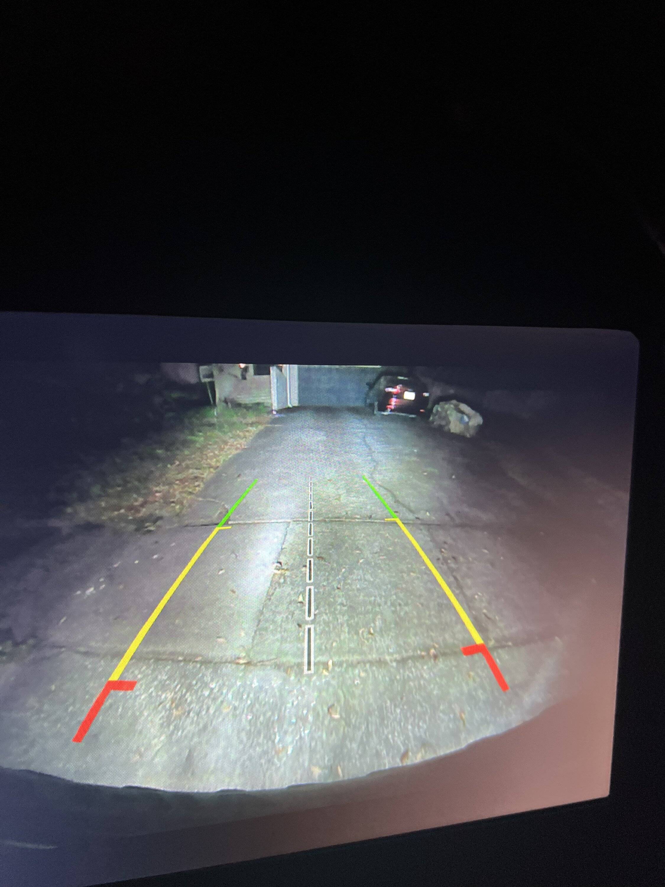

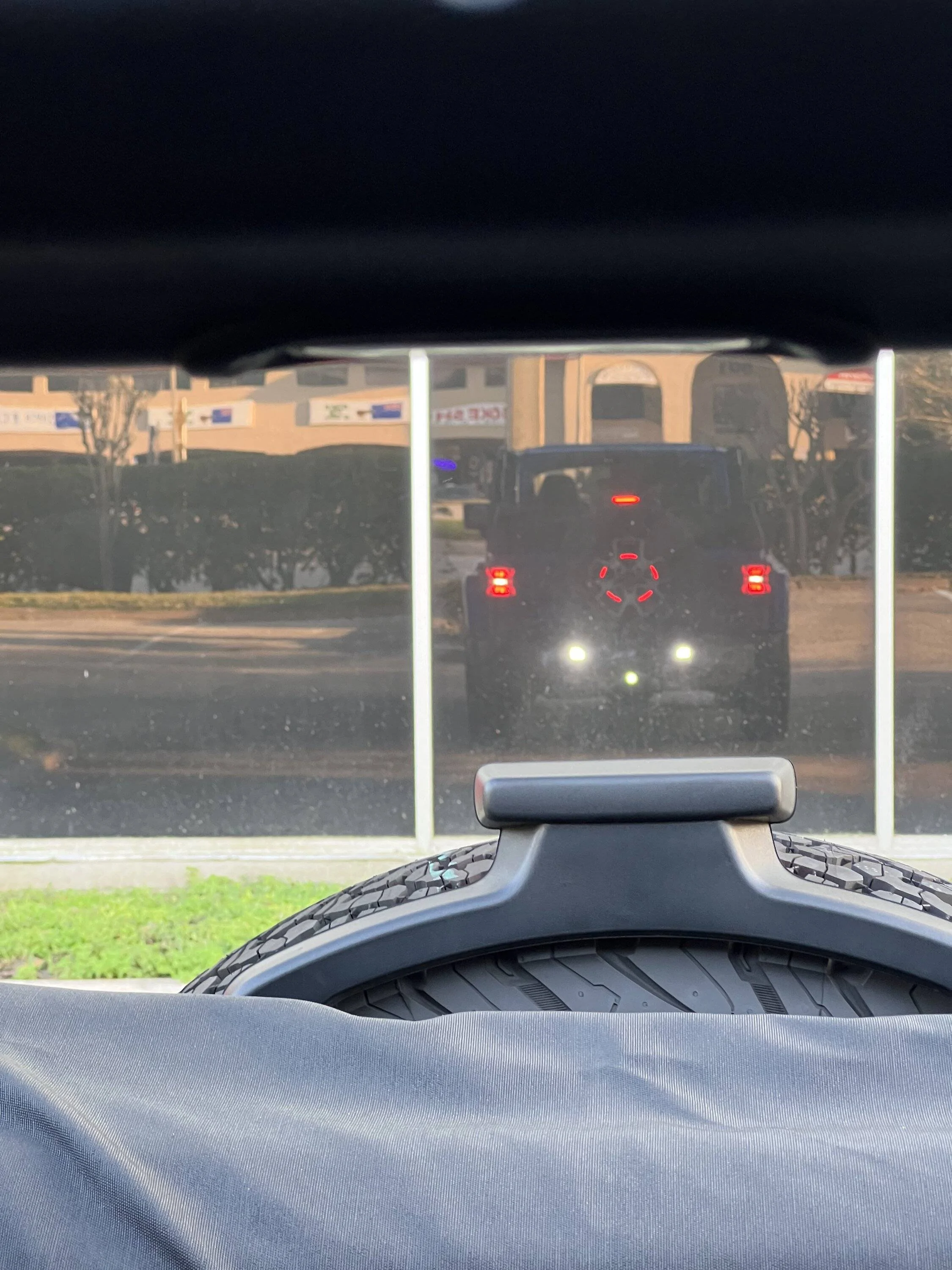

In reverse through backup camera to JUST show they come on also in reverse:
Jeep Wrangler JL Backup Lights 17270111-69E8-4DF1-B909-B46365313454

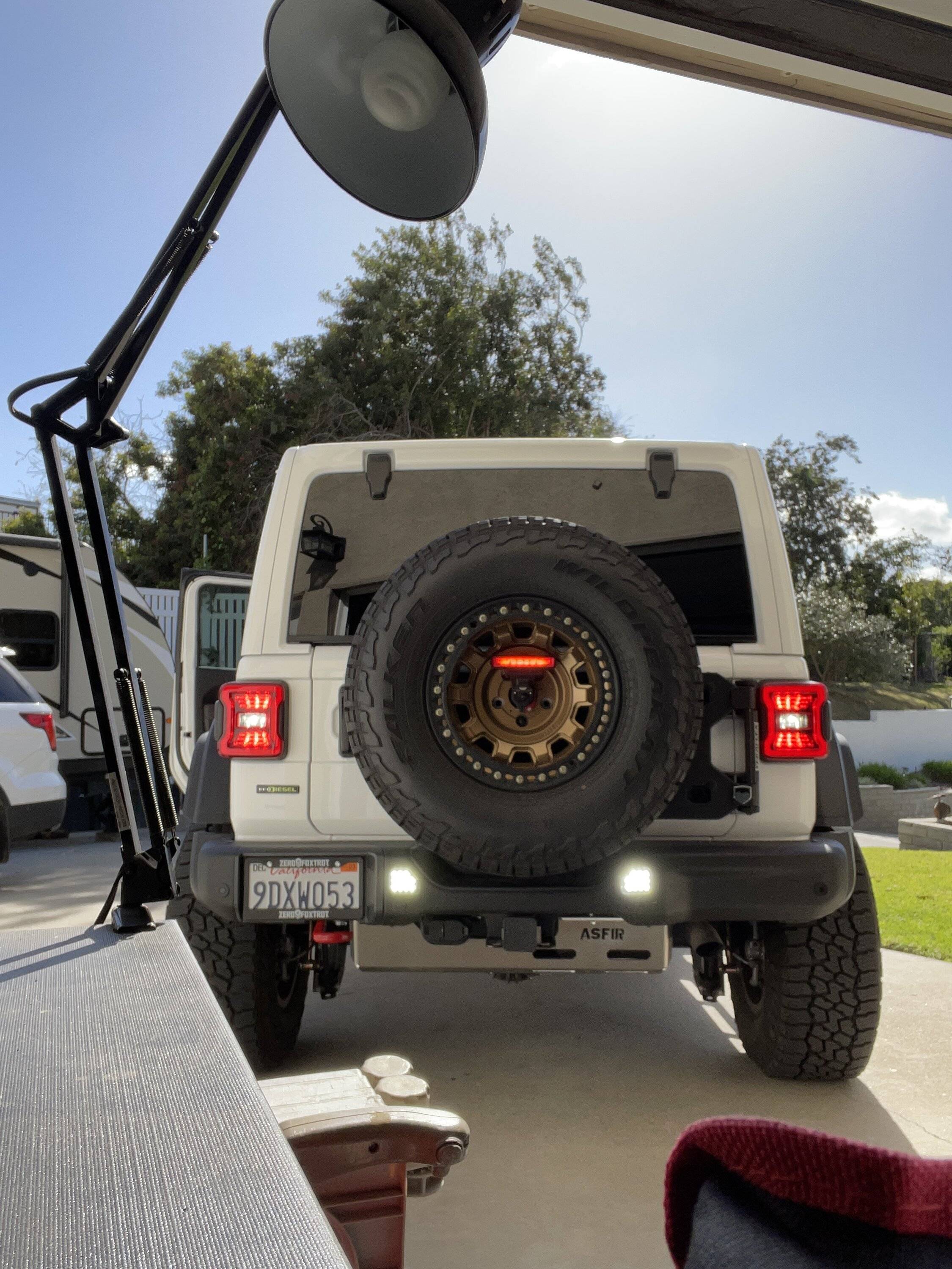

FYI…Difference in brightness in daylight between DD Hitch Light and Oracle Reverse Reflector Replacement lights:
Jeep Wrangler JL Backup Lights FF7E6694-466A-47C8-86D1-D4628C19DD88

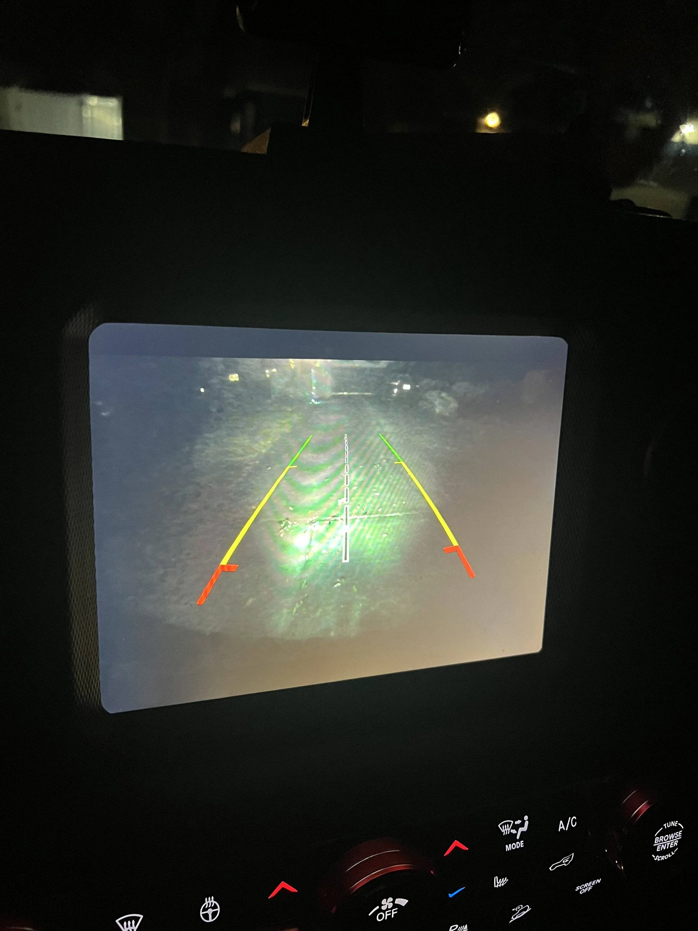

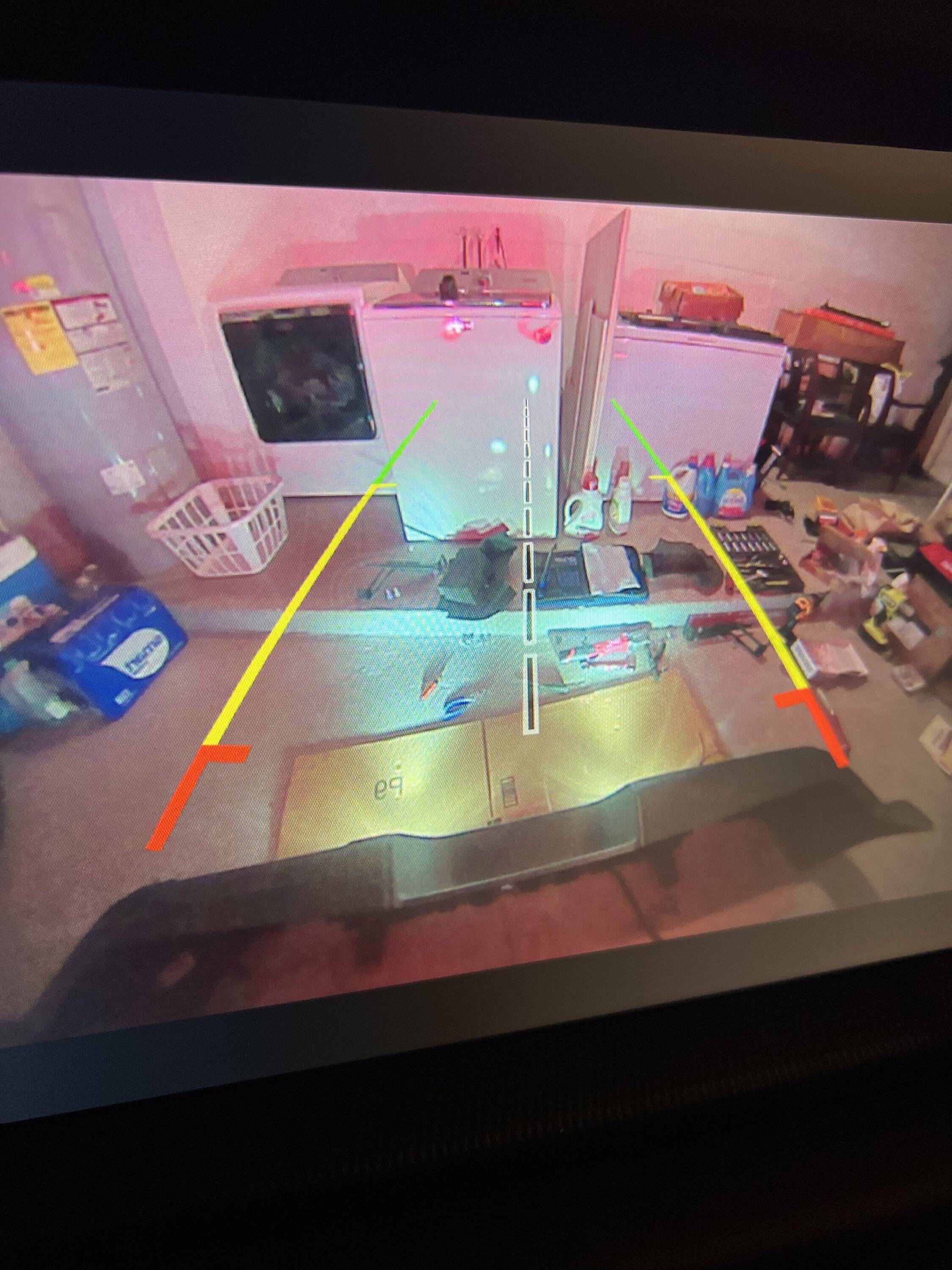

With just the DD Hitch Light through Back-upscreen:
Picture:
Jeep Wrangler JL Backup Lights 6B58965B-DA9D-46AE-B622-239A4134CE4E
With just the DD & Oracle Reverse Light through Back-up screen:
Picture:
Jeep Wrangler JL Backup Lights 5C17AFB2-8822-4076-8E36-4AFF3619949D

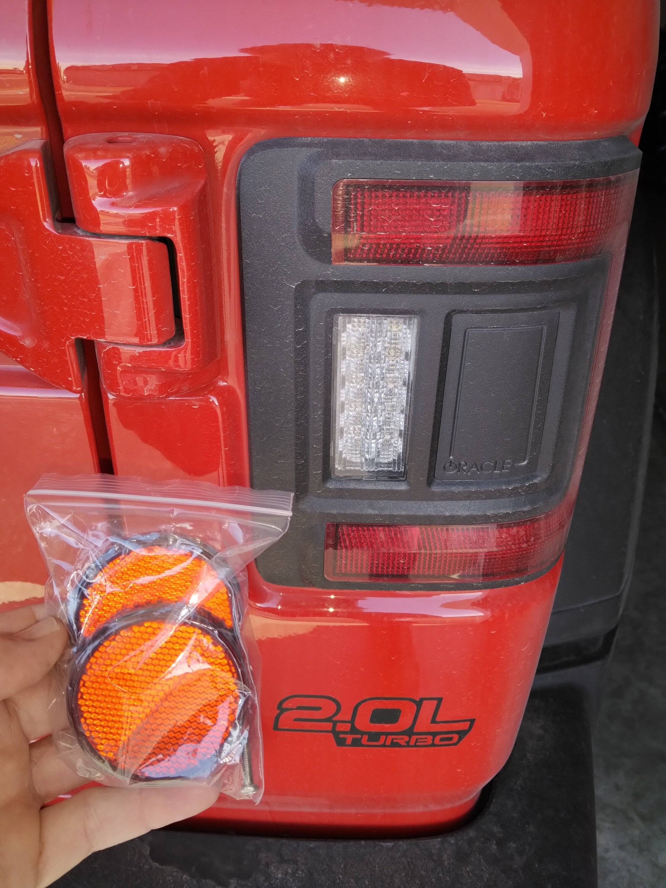

I bought a set of the oracle reflector replacement back up lights, not realizing that the reflectors they replace are the only reflectors on the rear of Jeeps with the [LED] taillights.
Is anyone else concerned about the loss of visibility when the Jeep is parked with the lights off?
That's a judgement call.
By way of example, I've the Oracle flush mount tail lights installed on my JLU. They too don't have integrated reflectives in the design. In recognizance of that issue, the Oracle lights included a pair of small, self-adhesive reflectors that the owner can attach to the vehicle at his discretion. You could do the same if or when you install the bumper reverse lights on your Jeep. Reflectors of varying sizes and colors are easily purchased online, or wherever hitch and trailer accessories are sold.
I didn't add the provided reflectors to my Jeep, because it lives in a garage at night. My lights are on when it's anything less than sunny, too, so on-road visibility isn't compromised.
