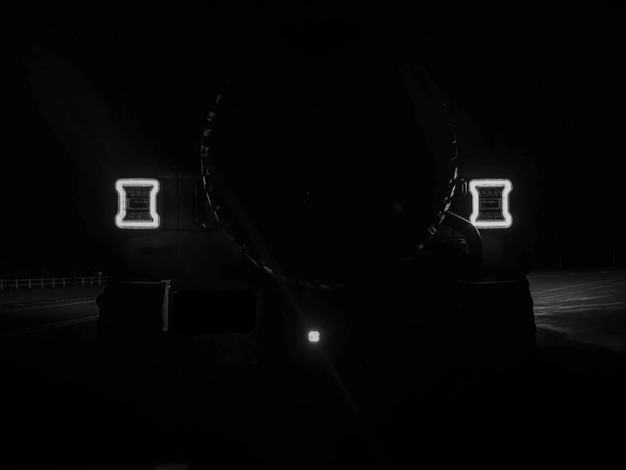

Jeep Wrangler JL Backup Lights Jeep Diode Install Small Size
The C1R operates as a reverse light, running light with the tail lights, and 4th brake light. The SS3 Sport Pod (flood pattern) was wired to only come on as a reverse light. I did this by installing the below DD 7 pin trailer harness and modifying one end with a 2 pin connector for the SS3 pod:
https://www.diodedynamics.com/stage-series-c1r-7-pin-dual-output-trailer-wiring-harness.html
This made for a super clean install and got rid of the need to tap/splice into any OEM wiring. Plus, my tow hitch wiring remains functional.
Here's another 7 Pin trailer wiring harness that could be used for similar auxiliary lighting applications that do not need the brake light function.
C1:
https://www.diodedynamics.com/stage-series-7-pin-dual-output-trailer-wiring-harness.html
Super happy with the result!
Pic of C1R running light with tails (B/W - exposure down):
Jeep Wrangler JL Backup Lights Jeep Diode Night Shot Small JL
SS3 Pod Wiring:

Installed these today. What a difference! They are especially useful if you're running a 37" spare on a swing arm carrier that blocks a significant portion of the the OEM reverse lights output. No tapping or splicing of the factory wire was required either.
C1:
SS3 Pod Wiring:

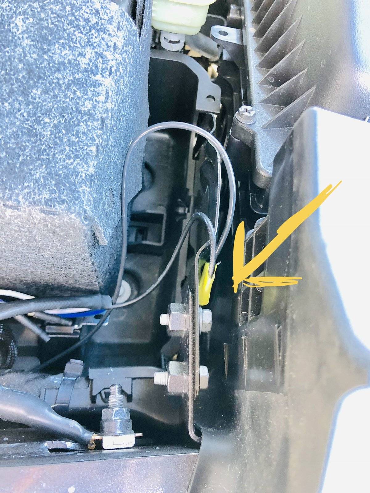

Curious.... Have you ever gotten under a JL or JT with tow package and looked at the 7 pin harness back there? For the most part it's exposed to the elements..
I agree, running both power and ground up front is a valid way but an install with the ground at the rear is also a very valid way.
More often then not trouble shooting an iffy/bad ground, is way easier if the ground wire run is very short in length and also easy to access all of it.
To each his own but I do the ground close to the fixture and in the case of b/u lighting that means in the rear of the JL/JT. Done correctly there is no more inherent problems then when you ground up front.
Speaking of grounds up front... I know more guys that have broken off the factory painted over, ground points in the engine compartment.
I tell guys.... especially novices, if they want to ground simple lighting up front to just use the ground point in the pic below. It's not painted, it's not overtighted at the factory like other bolts ...you are not going to snap off the bolt and the bolt comes free, really easily..
