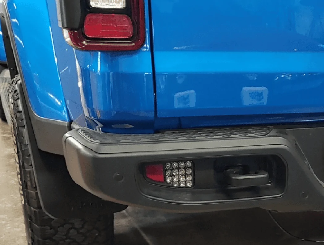

I’m not sure if the JL taillights have a reflector
They would, as a matter of complying with Federal regulations on the matter. E.g., the halogen OEM tail light incorporates a thin reflector around the perimeter of the lenses.
Yawnie'sPapa
Bill
Feb 5, 2023
779
1,136
Central Iowa
'22 JTO, '23 JLUR, '82 SX4, '73 P. Cardin Javelin
If it comes down to it, I can always make a Jeep logo out of red reflective tape and stick them on either end of my bumper.
Love it!!
Actually, it's in case the vehicle loses tail lights, is stalled, electrically dead on the shoulder or roadway and so on. People have had emergencies and pulled over only to hit a vehicle on the shoulder that wasn't visible.
Just saying, that's my experience and what troopers have told me (I've had my share of tickets when younger LOL)
I’m not sure if the JL taillights have a reflector, I’ll check next time I go outside, but I have never seen an aftermarket rear bumper for the JL that comes with reflectors so I assume they do or that no one really cares if they do or not.
Sometimes things come with disclaimers or "for off-road use only" and that sort of thing. Or they rely on the owner to take care of it.
Just was curious.
On the JT, the tail lights are non-reflective.

Question related to these lights..............
How are people getting around the legal requirements for red reflectors in the rear, or does any give a rip?
One reason they went with a half light, half reflector for the JT was to retain a reflector to meet certain requirements.
IF the JL tail lights are like the JT tail lights, there is no reflector provision in the lens. Many vehicles make the tail light lens reflective to meet requirements. The JT does not - thus the in-bumper reflectors to meet legal requirements and make them pass inspections.
If you remove the JL bumper mounted reflectors and install the Oracle back up lights - no reflector.
No one cares? Or do they reflect back red when headlights hit them?

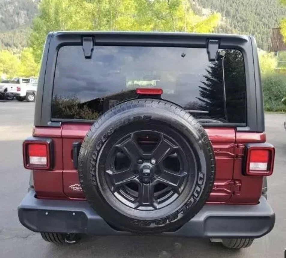

Puzzling as the Wrangler Sport doesn’t have any reflectors in the bumper from the factory. The reflectors built into the tail lights must cover this “requirement“

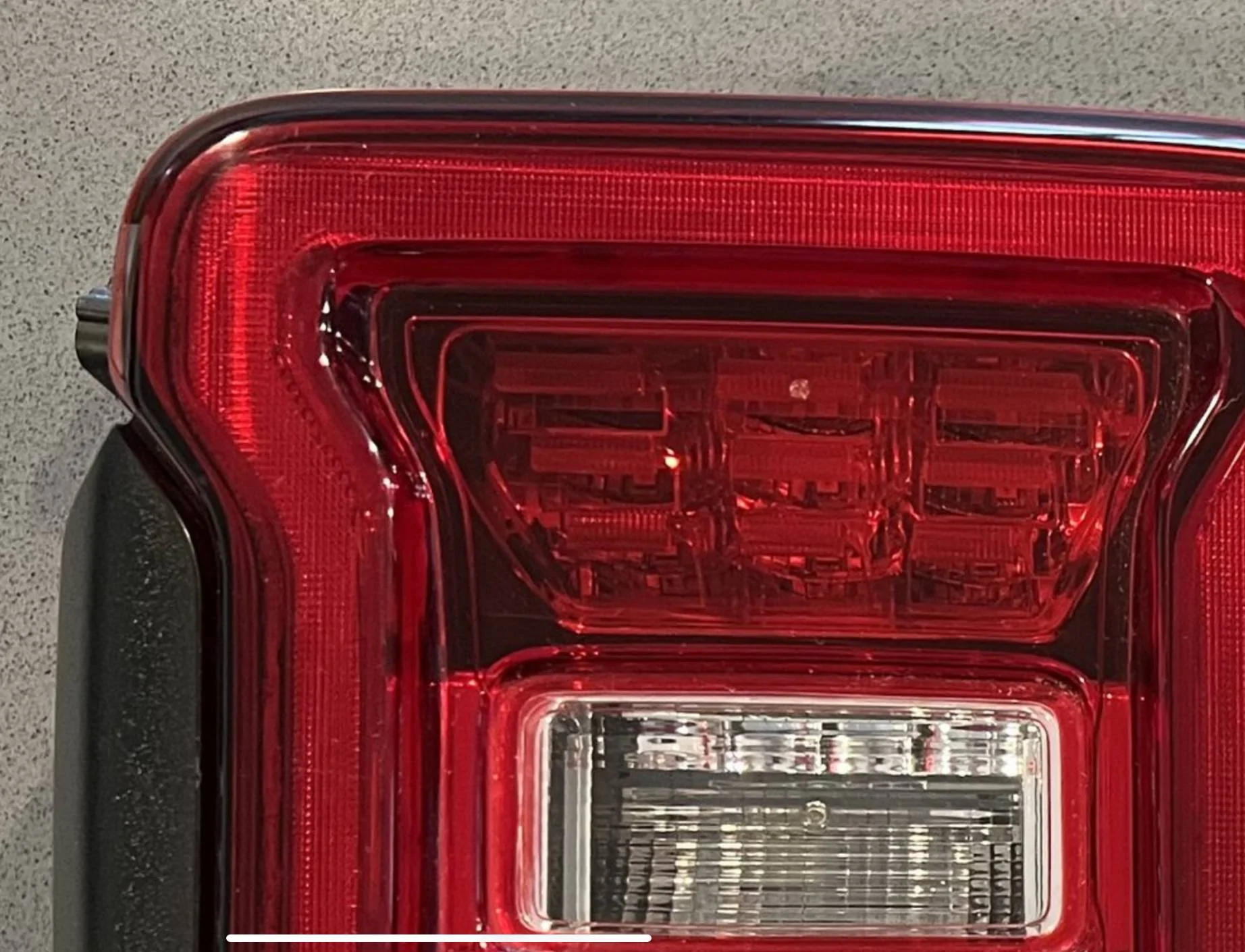

The center red area of those lights "looks reflective" unlike the LED lights on our JL and JT.
bobholthaus
Bob
Apr 4, 2020
612
506
St. Louis, MO
2023 JKURD AEV JL370; 2014 GC Overland Diesel
Technology Integrator
Isn’t there a reflective “ring” around the outside of the sport taillights? Take a pic at night with your flash on and you’ll see what is reflective.
Coming from a Willys Sport I was wondering about this as well. The rearview visibility is absolutely abysmal, even with the camera at night. So, I was hoping to help it out a bit with some backup lights, walked around the back to find there wasn't a place for them. Good thing I didn't order them!

The LED tails definitely have a reflective element as well
Jeep Wrangler JL Backup Lights 27449875-3CB0-4D3B-880F-2FBD11B01AB2
Apexcars
Mar 12, 2021
744
1,614
North Texas
2020 RAM 1500
I checked my LED taillights with my cell phone flashlight last night and they don’t seem to reflect. The ones on my Ram do but not on my JL.

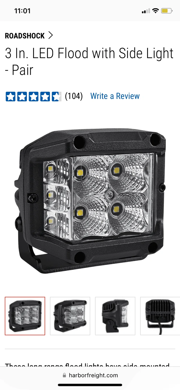

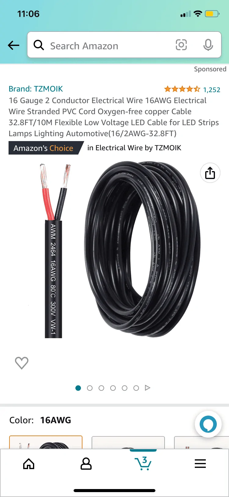

First thank you for all the great ideas and contributions! I learned a lot by reading through this thread.
I’m planning on getting the HF lights and mount them on top of the Mopar steel rear bumper. May drill new holes instead of reusing the two holes on the edge. And will wire to the factory Aux switch in the engine bay. I only want to control the backup lights using Aux switch button and don’t want it come on automatically when in reverse. It was mentioned somewhere in this thread that 16 gauge wire should be used if connecting to Aux 3. And ground to the rear of the frame or body. Could anyone please clarify couple things for me? I’m totally new to wiring and lighting in the rig.
- Should I use 2 conductor wire or 3 conductors?
- Is16 gauge proper for this application? The Aux 3 and 4 is rated to 15 Amp. But I don’t know how much amp these lights would draw.
- Where exactly to ground? I’ve seen some applications ground to the passenger side of the engine compartment, near the battery.

You only need to get a single spool of 18 AWG wire (whatever color you prefer) and run it from the aux switch wire in the engine compartment to the rear of the Jeep to those lights positive wires (single wire to both positive light wires) and then both light ground wires to the chassis (or whatever ground point you chose).
Fast-n-Furious
Jul 29, 2022
756
803
PA
2022 392 XR
Thanks a lot for the help!

I don’t have time this second to give you a write up on all of this, but here is the gauge of wire and the number of amps and watts they’ll handle. 18 gauge is more than enough, and it’s easy to handle and terminate. You need 2 conductor (one for positive, one for negative), so a spool of that is perfect. There are ground studs on the fender in the engine bay next to the battery, next to the aux switch wiring. This is a very simple job. You need flex loom as well to protect your wire run. Call me if you want me to walk you through it.
14 -- 11.8 amps (162 watts)
16 -- 7.4 amps (102 watts)
18 -- 4.6 amps (63 watts)
