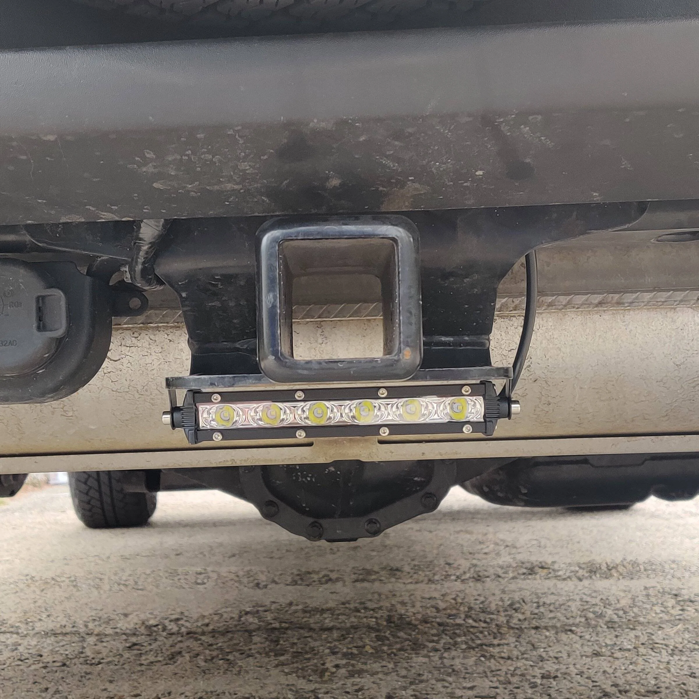

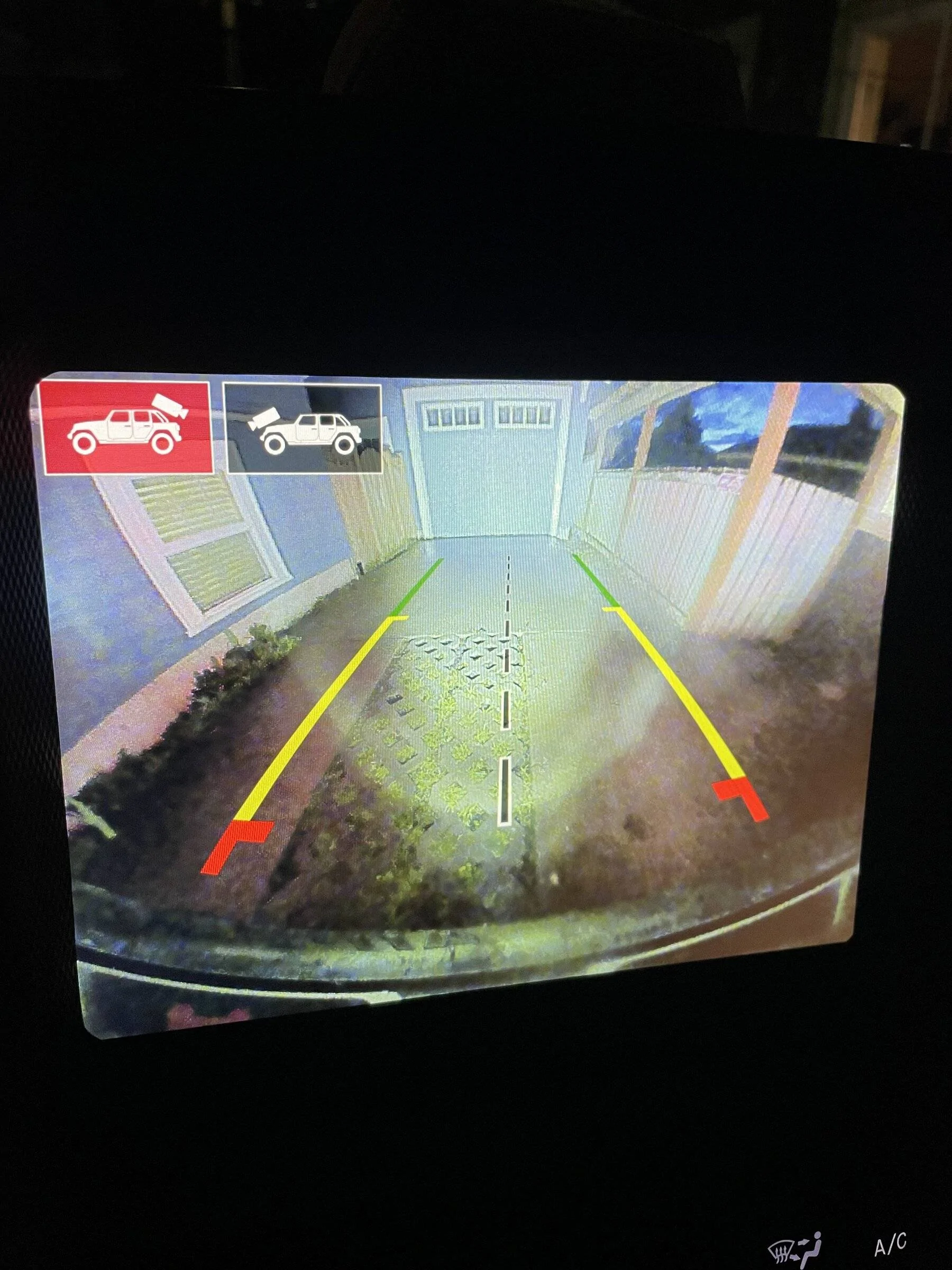

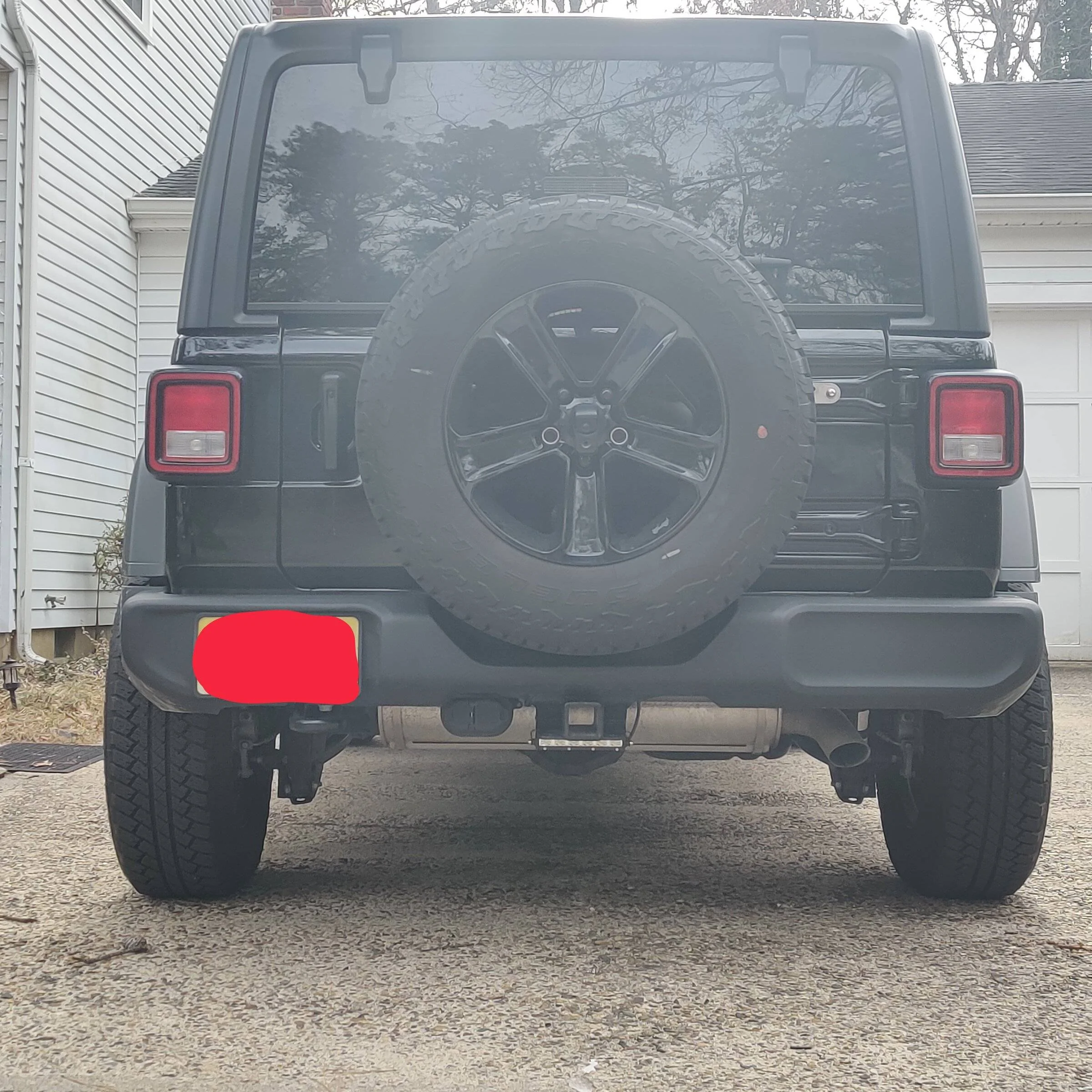

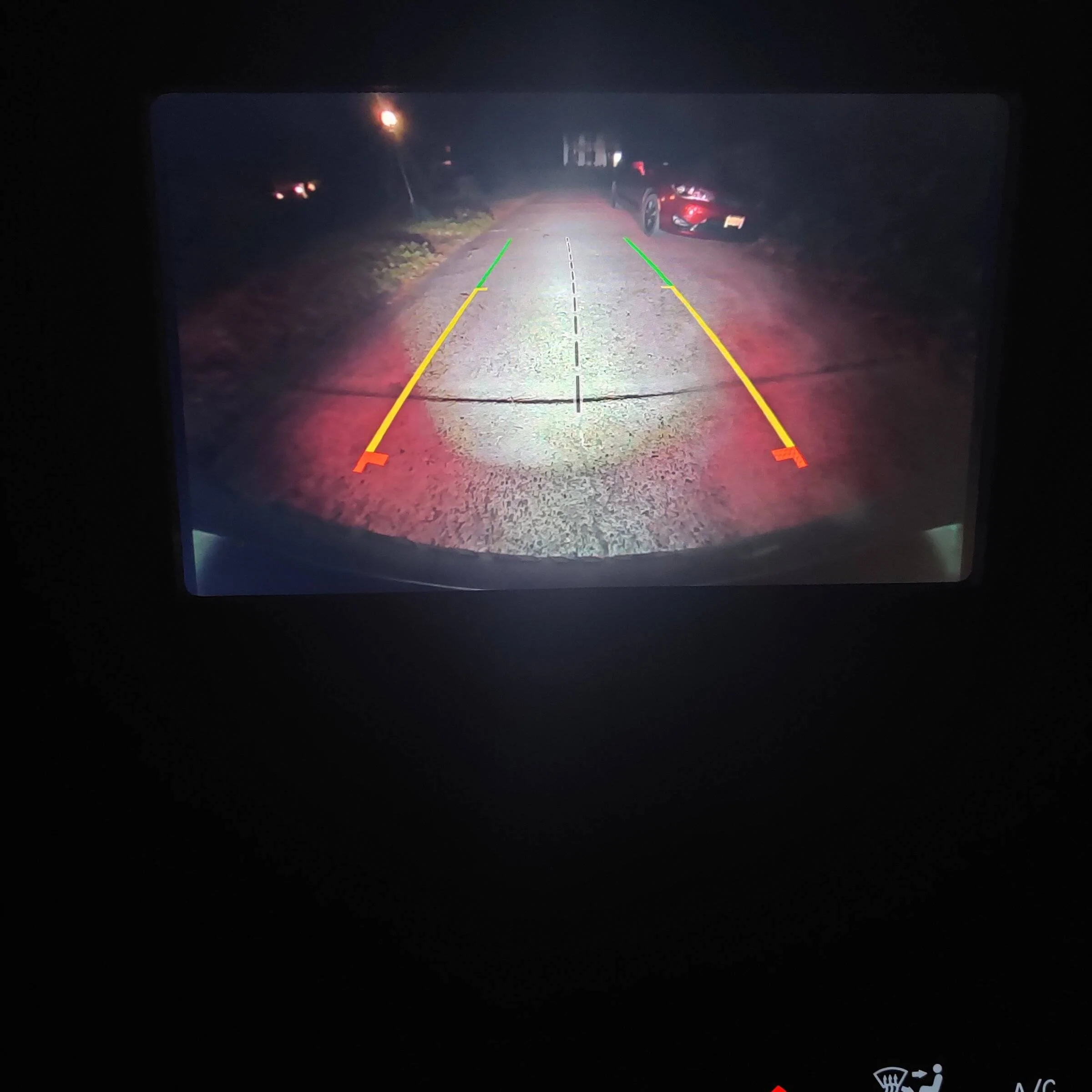

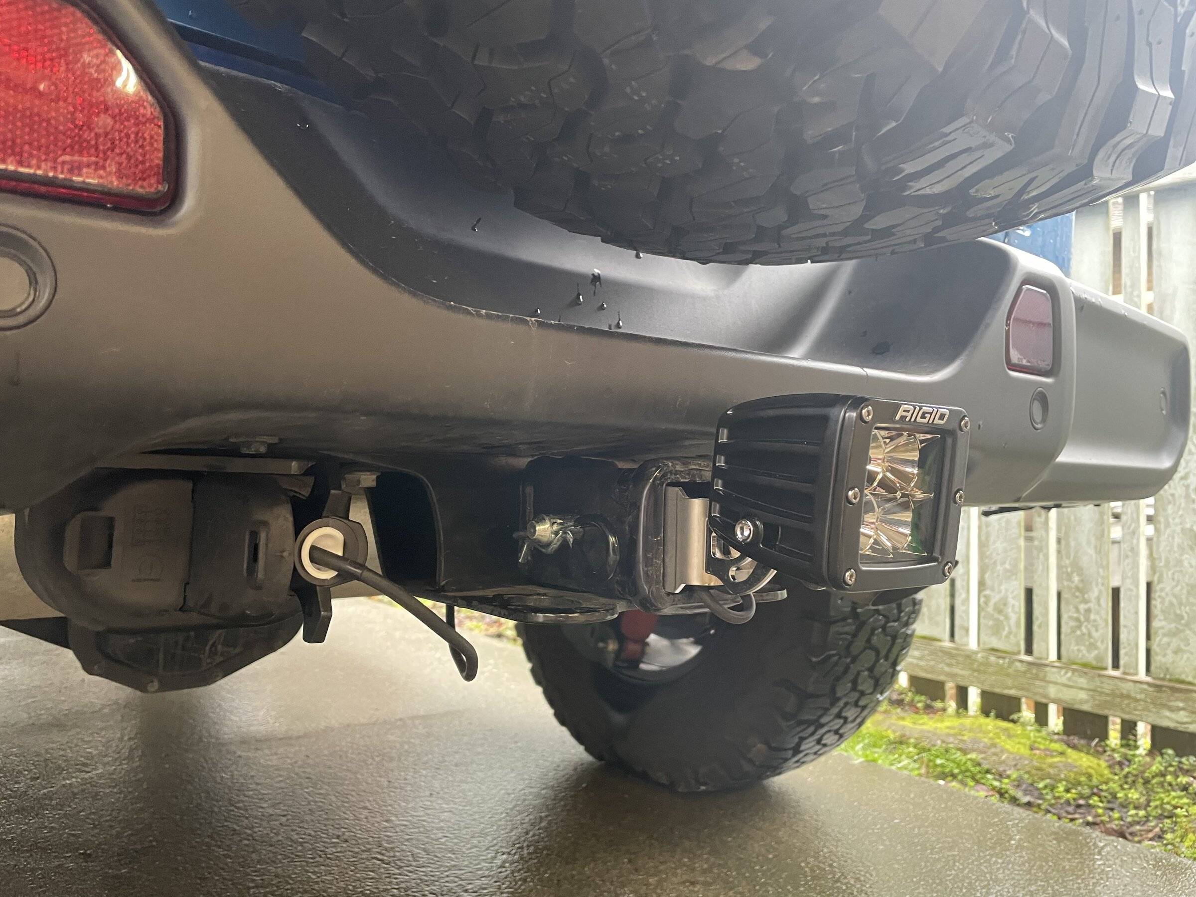

Like many of you, I've been struggling with my backup lights.
This thread was very helpful. Thank you all. I found a single row 6" LED light on Amazon that is great. Tapped into the white wire with the orange trace in the tow hitch I installed a few months back, grounded it and off I went.
My off-roading consists of forrest roads and hitting the dunes along the Jersey shore, so not worried about any damage. Just thrilled I can see now.
My favorite part is that you can't see it at all if you don't know what you're looking for. My whole theme is black on black on black stock stealth. (Set up for towing our camper, added tow hitch, wiring harness, airlift 1000 bags, re-gear to 4.56 from 3.43, etc.)
And yes, the muffler is next. Already have a can of high heat matte black ready to go.

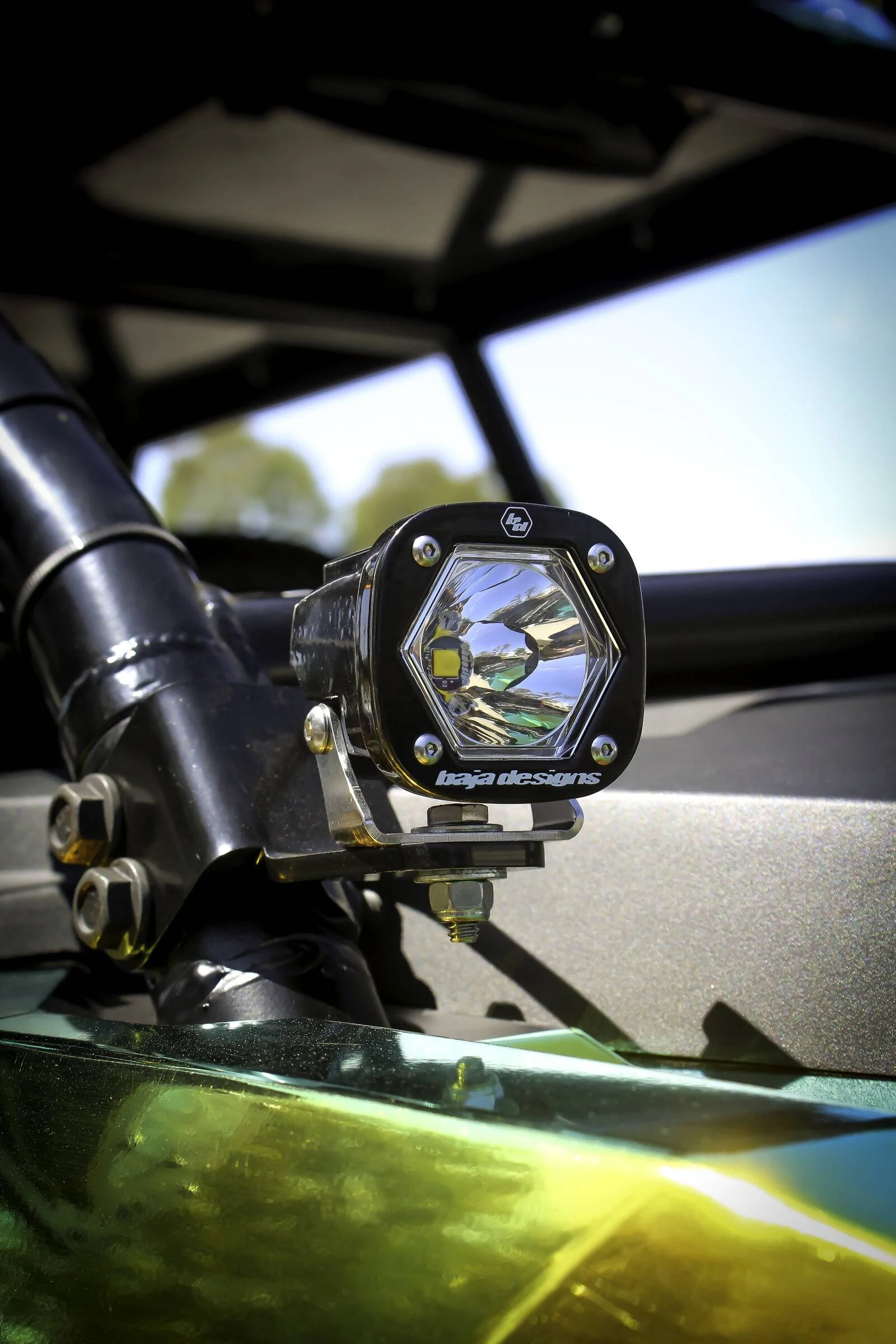

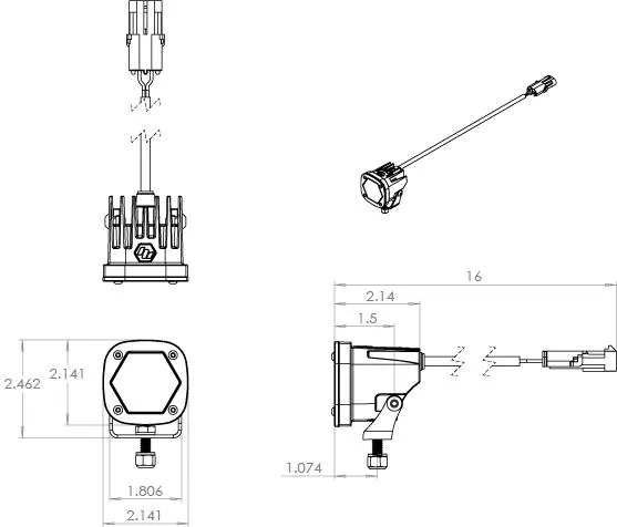

Hey Nick,

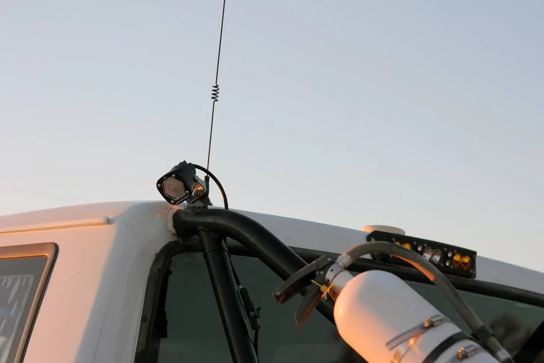

Yes here are a few pics of the s1. Also if the s1 does not interest you the s2 is another great alternative. What makes this option great is the small profile which wont impede on approach and exit angles if mounted on bumpers.
Jeep Wrangler JL Backup Lights 380000_l
Jeep Wrangler JL Backup Lights S1_2
Jeep Wrangler JL Backup Lights s1 specs
