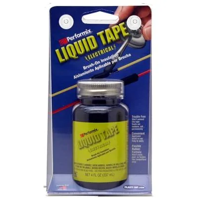

I like the Liquid Electrical Tape. Seals pretty good. Available at auto stores, Harbor Freight and Lowes/Home Depot.
@MIke Honcho
I often mention I use and recommend liquid electrical tape use.
I suggest shrink wrap and then apply multiple light coats of liquid tape (give a few seconds between coats) over the shrink wrap. I mention apply neat light coats and do not slop it on.
I also use it to cover nicks in wires, etc..
Anyway, yes, good stuff, liquid electrical tape is.
How did I not know of this mysterious marvelously magical mucilaginous invention! What other fabulous secrets are you hiding? So many times I could have used this tapping into a wire with no way to shrink wrap.
It is good stuff. A little goes a long way. Follow @Rhinebeck01 advice and build it up with thin coats. The bottle lasts forever but it tends to dry out on me since I don't do much splicing/coating. Maybe only a few times a year.
