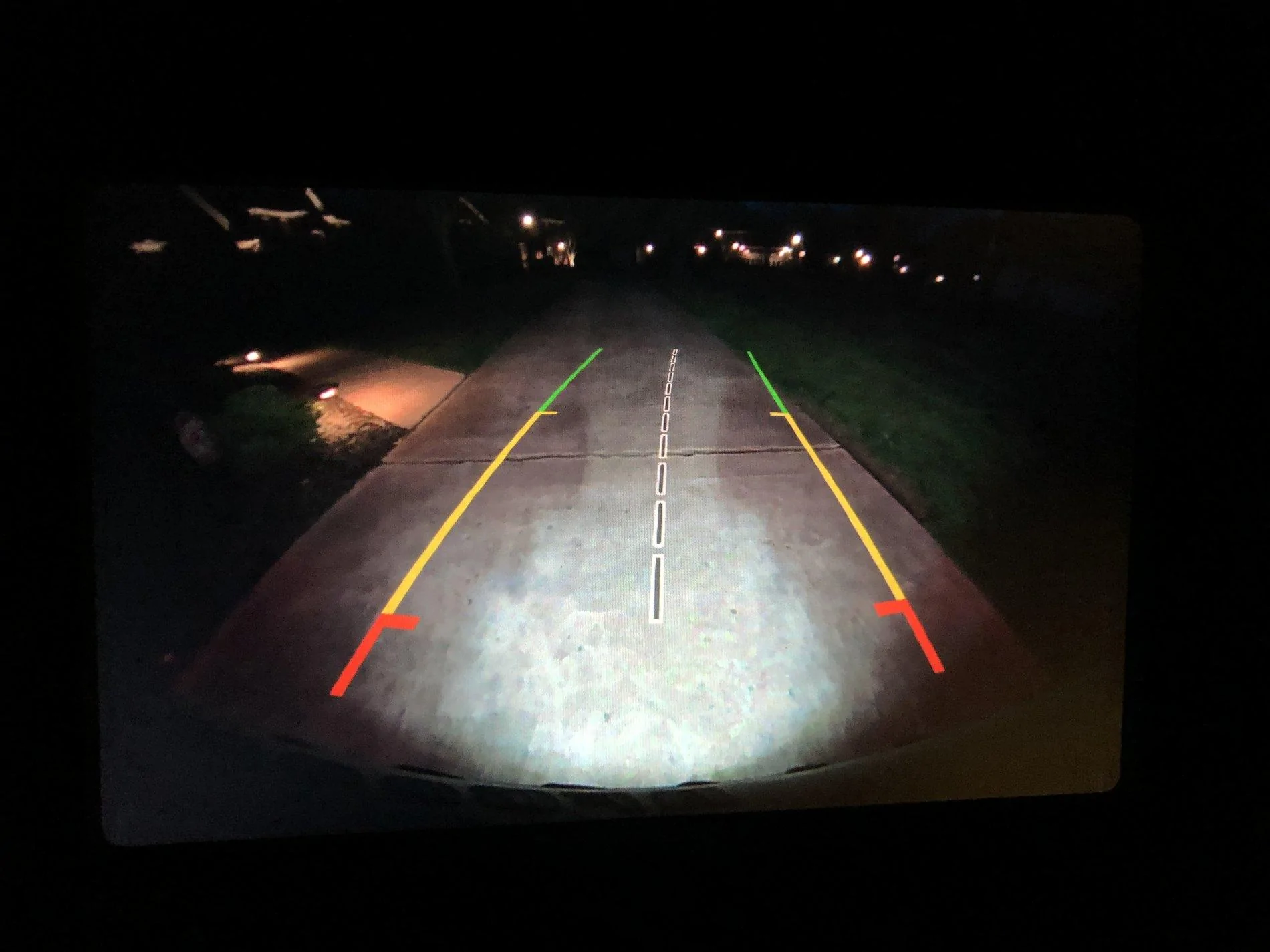

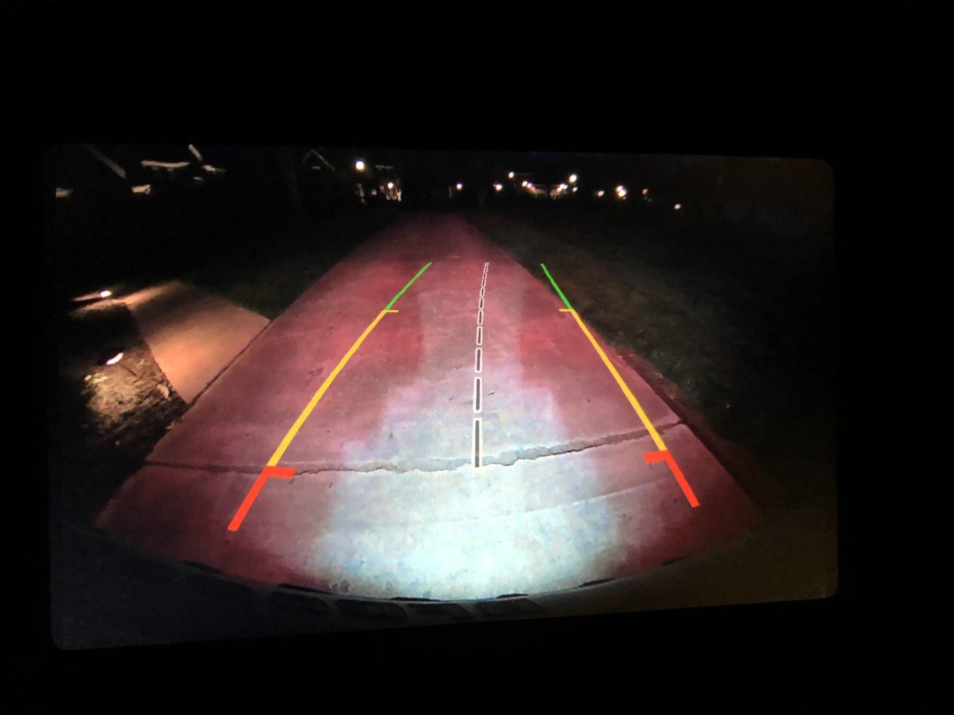

Here you go.Mind taking a photo of the screen once you wire them up? Curious how the light looks on those from that angle on the camera.

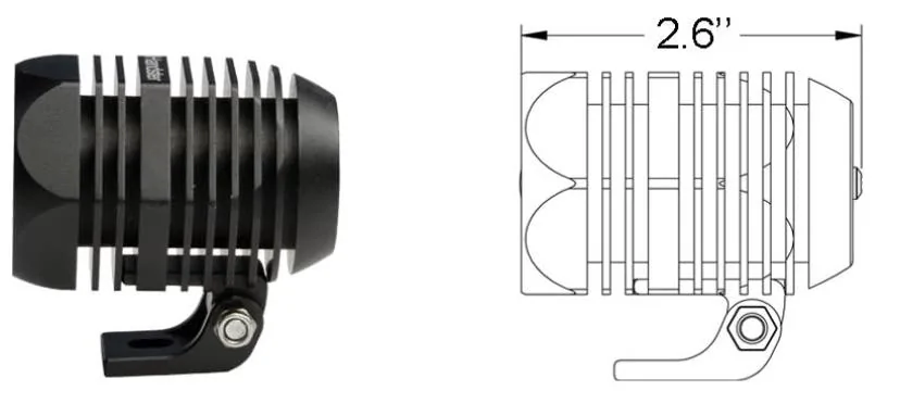

I love it! Can't quite tell how they are mounted. Have more pics?Added these guys directly to my spare tire carrier to shine through the spokes of a 5 spoke wheel such as AEV Pintlers or stock Rubicon wheel.
https://www.amazon.com/gp/aw/d/B078V66BRD?psc=1&ref=ppx_pop_mob_b_asin_title
The lights come with mounting tabs (see photo), nuts and bolts. I turned the mounting tab backwards, drilled directly into the spare tire carrier and used the supplied nuts and bolts to attach to the spare tire carrier.I love it! Can't quite tell how they are mounted. Have more pics?
This is slick! How did you tap the wires or did you run them to the aux switches?Added these guys directly to my spare tire carrier to shine through the spokes of a 5 spoke wheel such as AEV Pintlers or stock Rubicon wheel.
I tapped into my trailer wiring harness as well as AUX 4.This is slick! How did you tap the wires or did you run them to the aux switches?
