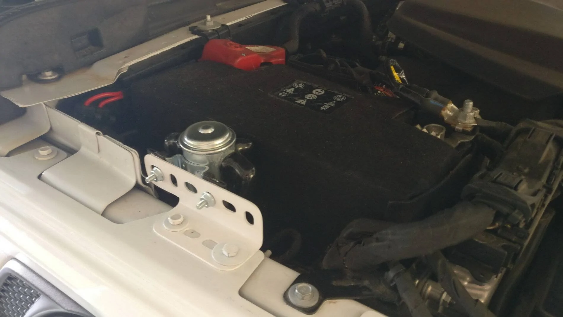

There was a post on the forum a while back about mounting the solenoid to a piece of angle iron. I went to a box store and bought one painted it red and it was easily mounted to the body. Lets one mount the winch solenoid and anything else to it and keep it very clean looking. My winch is on Aux 4. I have the coms radio wired to the ignition wire that also is bundled inside the firewall.
Angle iron works great.

AUX 1 is still empty, though likely lights.
AUX 2 is the ARB compressor
AUX 3 is the Warn winch solenoid
AUX 4 is the Midland GMRS
All tied in near the battery on the passenger fender. Made a custom wiring harness from the battery to the cargo area for the compressor, but it took me WAY longer than I anticipated. While I was working on that I decided I'd finally figure out and mount the winch solenoid. Made the mount out of some angle steel I had and painted with appliance enamel left over from another project.

This is the solenoid from the Warn Power Interrupt Kit. Wired to Aux 4.
I like this. So instead of a direct hot hook up you have a solenoid that is activated by the accessory switch. This keep the winch from always having power. Nice. Looking into this.
Can post a picture of the solenoid mount, also, what amp solenoid did you use?
I use the warn solin
I use the warn solenoid. It has mounting clips built in and came with all the cables needed.
