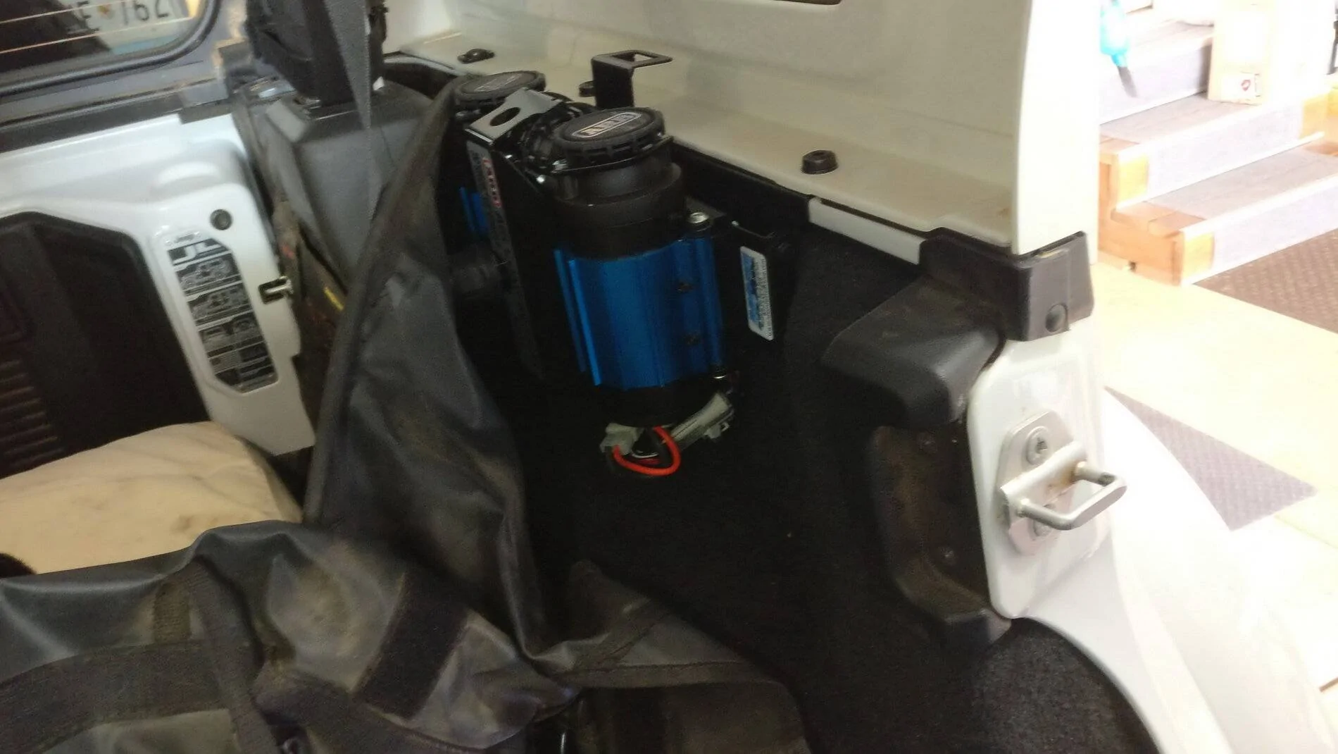

Please post a picture of the compressor in the cargo area. I would like to see how it has been mounted.
Don't want to get too far off topic. Wiring harness was about 16' total from battery to plugs at compressor. I replaced the ARB rocker switch with the AUX 2 switch. I'm using the M.O.R.E. mount. Seems well made with a nice finish. Has worked with the hard and soft top, but I did have to drill out a hole on the bottom of the soft top door surround plastic to accommodate the mounting plate (utilizes the forward hard top bolt hole that this piece would normally cover).
