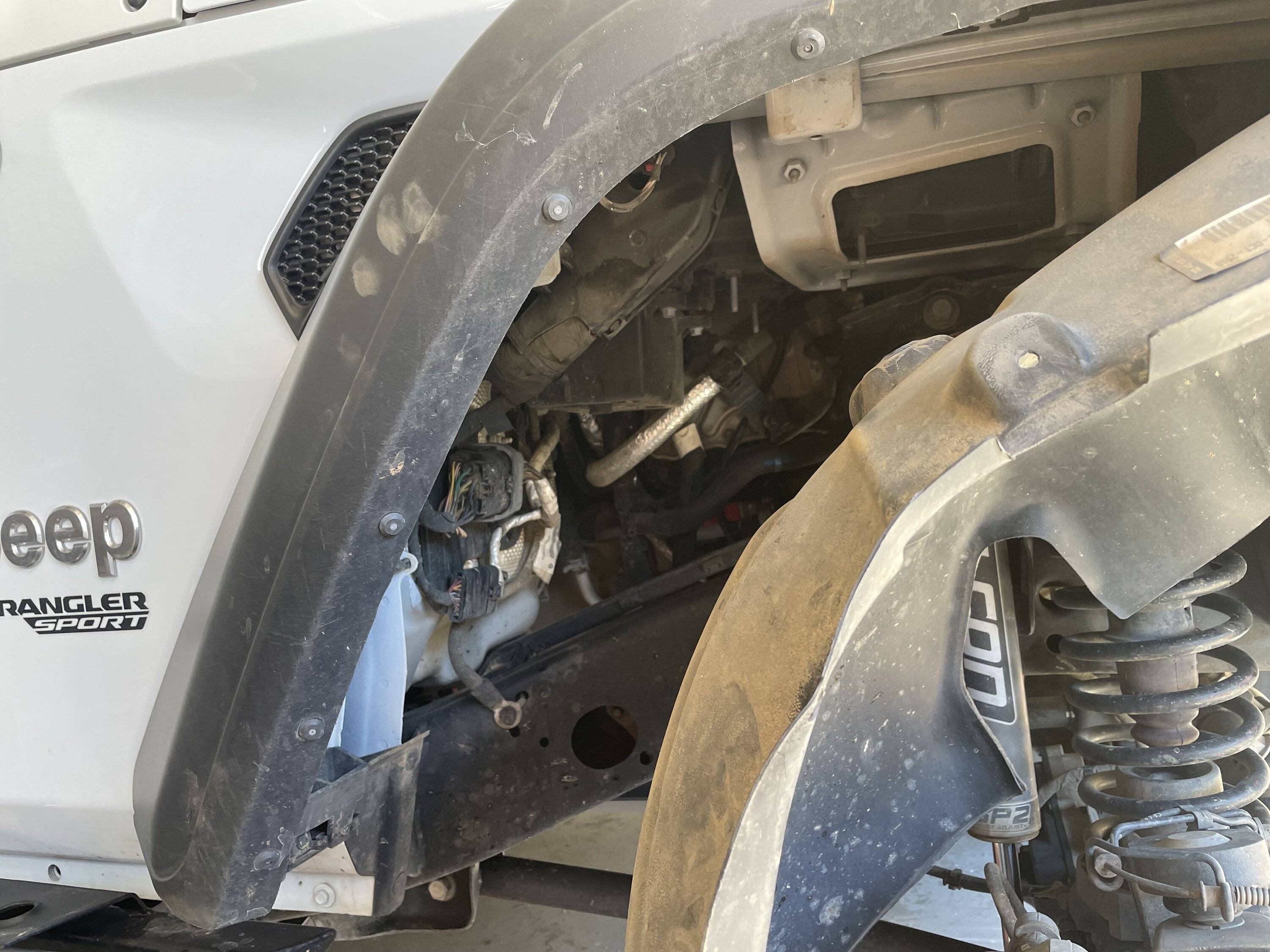

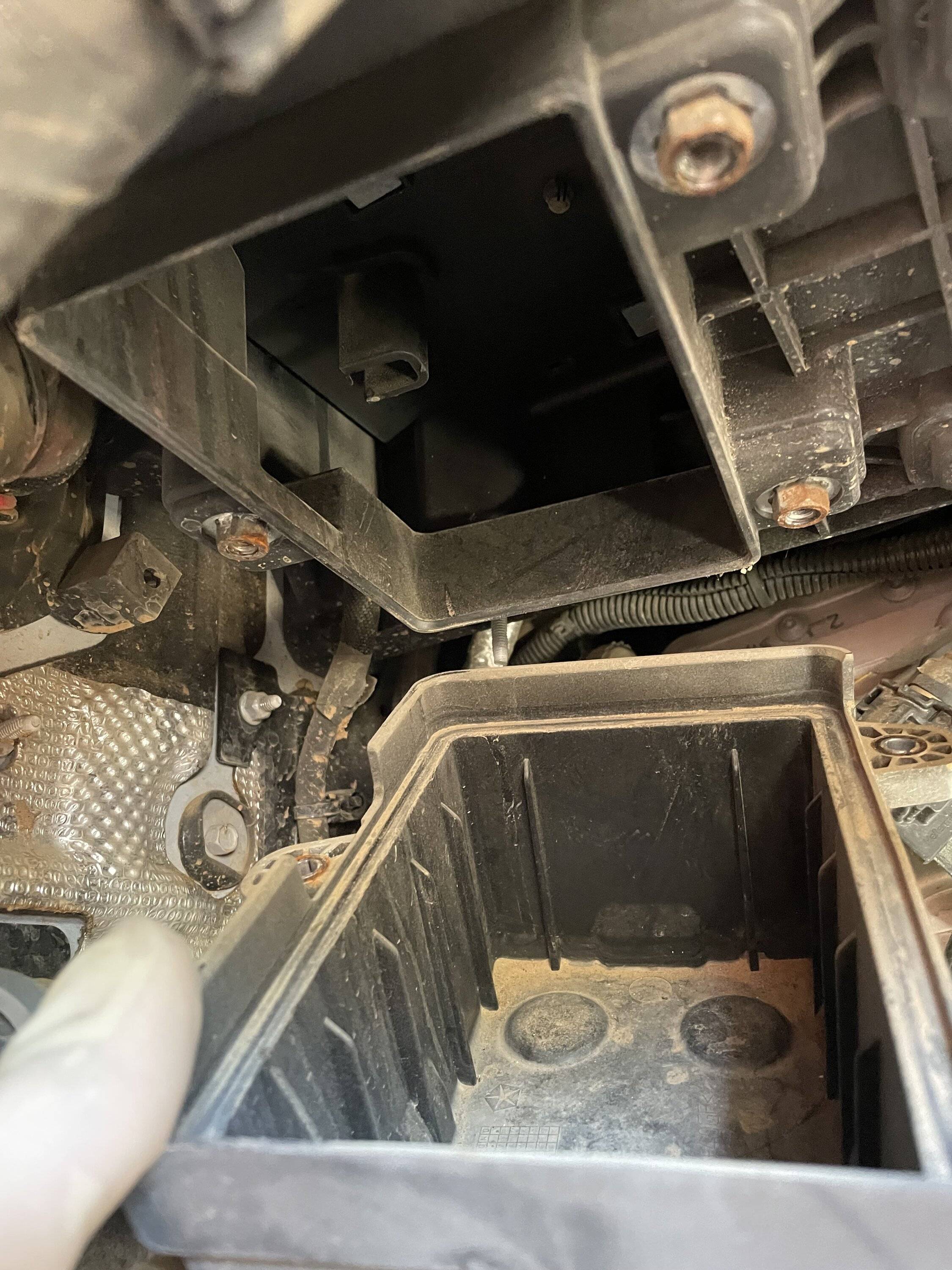

So it’s time to replace the batteries- getting the “Aux switches unavailable” message at start-up. Peeled back the fender liner, easily removed the three 10 mm bolts, dropped the unusually light battery tray and behold! There’s no aux battery! No wires dangling, just a nice empty cavity great for hiding valuables. It was at this moment I realized I have eTorque with the 48v battery. I should have know, since I’ve bumped my head on it several times doing other projects. I will happily submit my name for the Jeep dumb-ass competition. So for those of you getting ready to replace batteries, verify your particular set-up and avoid the effort, broken plastic fender liner retainers, and the expense of a cute little $150 AGM battery!

I didn’t explore too thoroughly, but there’s at least gotta be passage for the battery connections. I was thinking the same thing- great place to tidy up wires. Pretty clear shot up to the main battery from the box. Removing that fender liner really exposes the firewall nicely if you need to run wires to the cab.

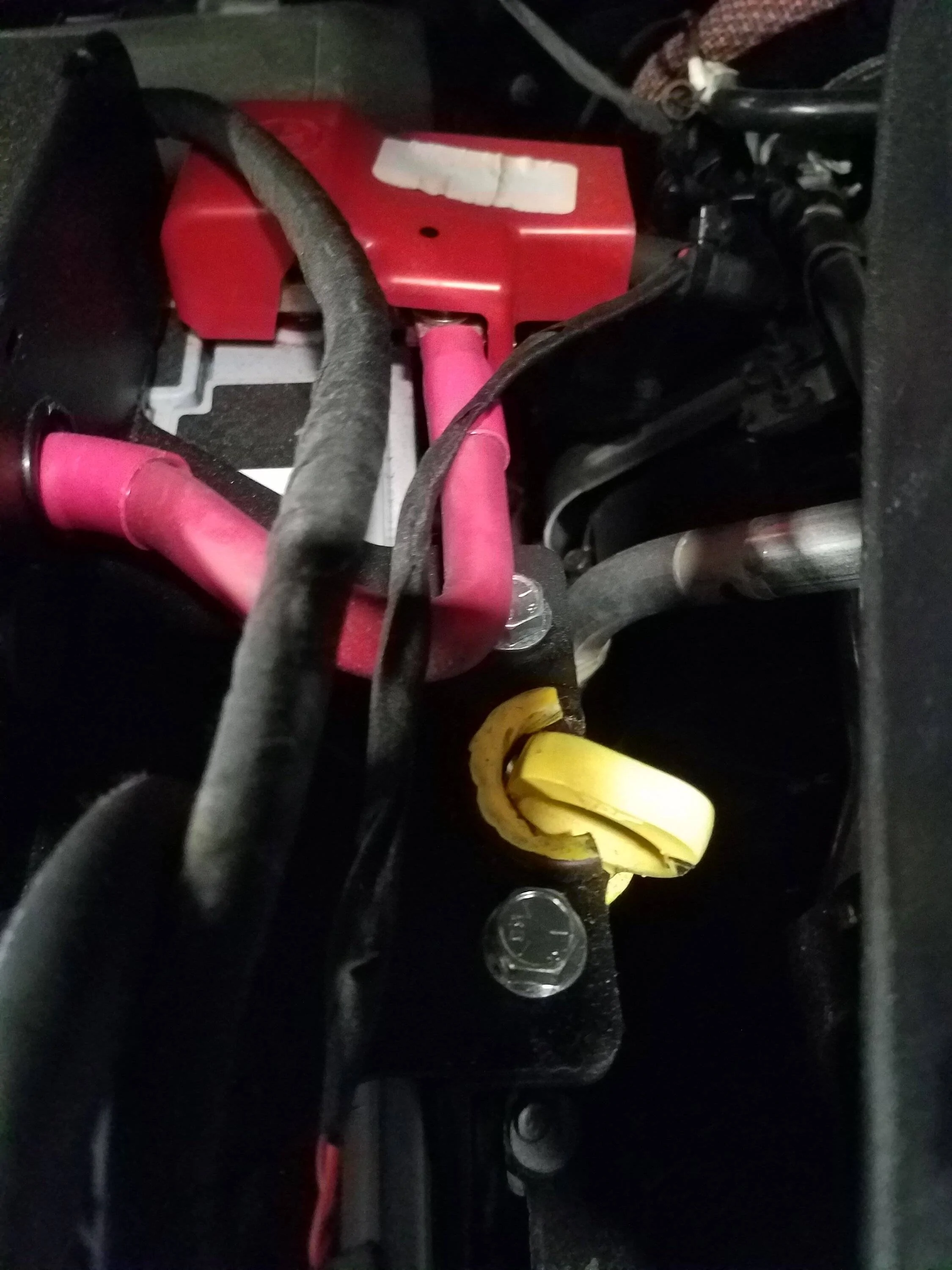

i sprayed my tray with blk rubber flex spray.as seen on tv i also cut a round hole for the oil dip stick with a hole saw so it doesnt rattle and painted a yellow circle around my cut hole so it was easy to locate ,and i also placed two large rubber grommets under the tray so it doesnt rattle . took me a long time to locate source of rattles. i bought a o ring set from amozon cut one of the larger o rings in half painted it yellow then used clear caulk to secure in place. dont forget about puting rubber bushing under the tray you can loosen up some of the bolts and pull up on tray and slip them under to keep it from rattling . it just about drove me crazy till i found it
Love to see what you did with the dip stick in a picture if possible. The only thing I didn’t like about the kit was the dipstick was stuffed against the side pretty hard
