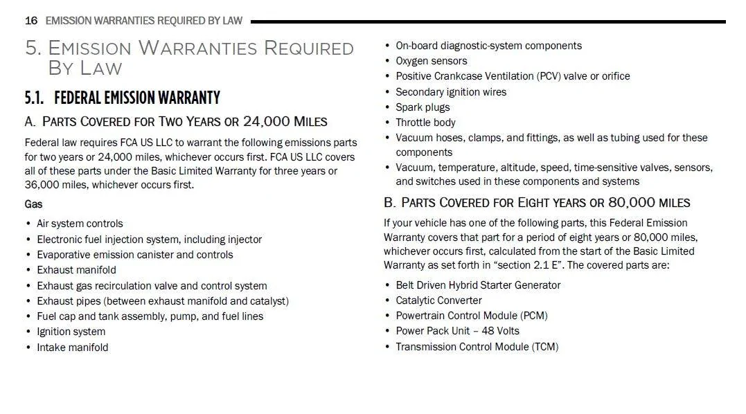

When I first purchased my new Wrangler, JLU, I also was not a where regarding the BSG. Since then, I have researched it and found the attached warranty regarding the emissions system of which it is a part. The warranty says it is covered for 8 years or 80,000 miles. If your Jeep is only 4 years old, I would look into the warranty for a new battery. Mine is 2020 and I continue to see about 13.2 volts plus. Take a look at it as it may help with your issue.
Jeep Wrangler JL Aux Battery Lesson Learned FEW Warranty
