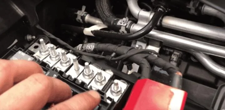

If you take the cover off of your Power Distribution Center (PDC) that black box on the passenger's side under your hood: your intelligent fuse box, and look at the box's driver's side, which picture better depicts how yours looks? The first picture below lacks a connection (near the pointer finger) between N1 and N2. This is what we expect from dual AGM battery JLs.
Jeep Wrangler JL Aux battery? 1748020836134-r8
The picture below, in contrasts, shows a jumper between these two points reflective of models without a second AGM battery. The key word here being AGM (absorbent glass mat) chemistry type of JL battery. For example, the 4xe has a second battery but it is for propulsion, resides under the back seats and as is not of AGM chemistry: AGM being a type of lead acid battery.
