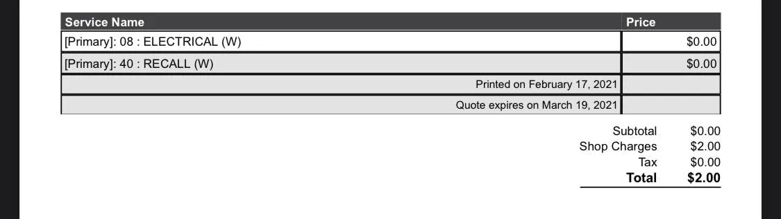

My aux battery died
Jeep Wrangler JL Aux Battery E9CE11C0-942F-4FA7-8CBA-787926A00406
on my 2021 JL Sahara after 1200km. It got towed to the dealership and replaced under warranty.
