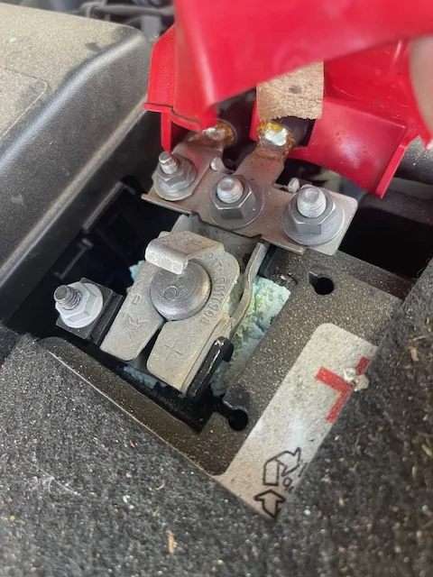

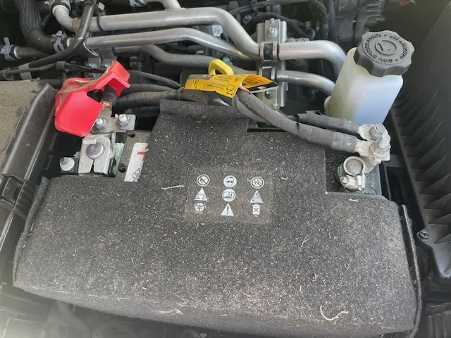

Thanks to all that replied. I've attached a couple of pics of the battery terminals. You can clearly see corrosion on the Pos side. I think I may have to replace both batteries. From the looks of it, it appears the Aux delete is the way to go. I have the Tazer so the ESS is disabled.
Your main battery is leaking. Replace it immediately, and make sure the acid didn't spread to other parts.
